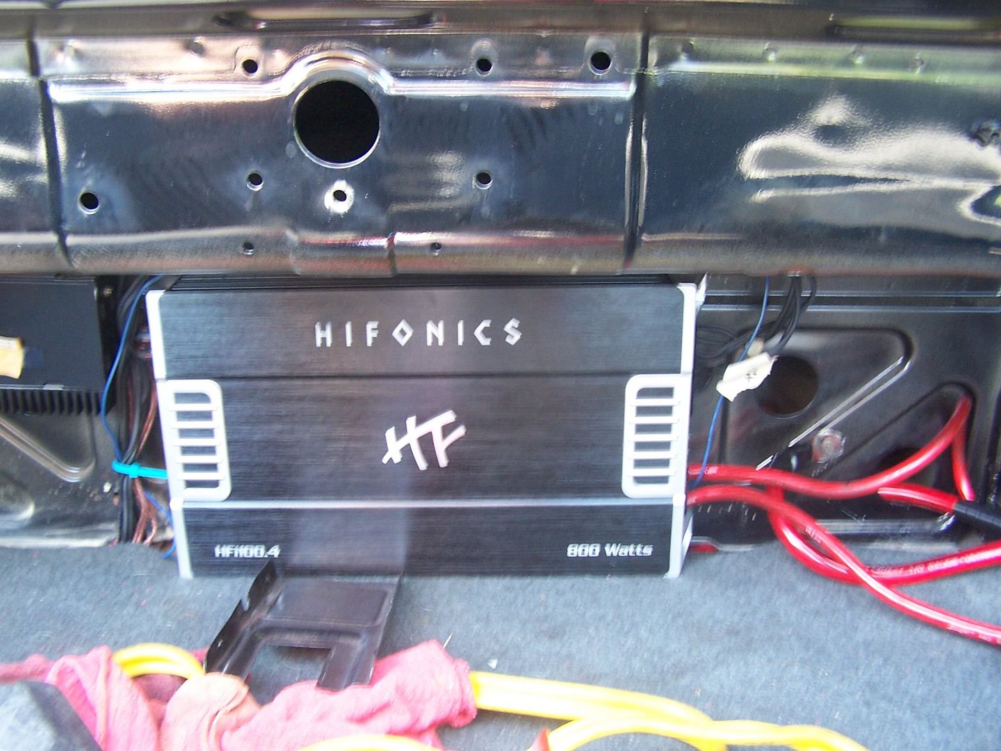

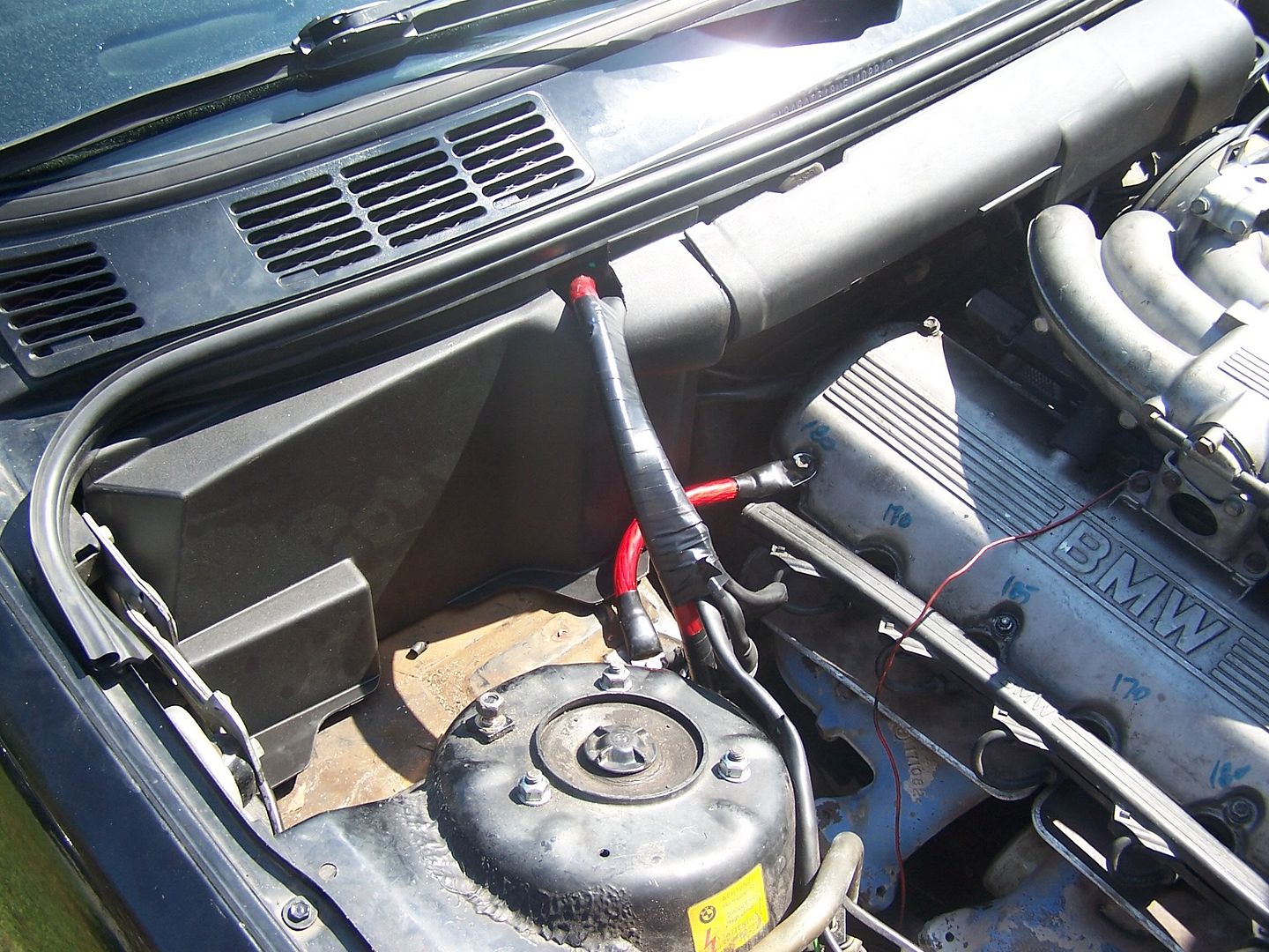

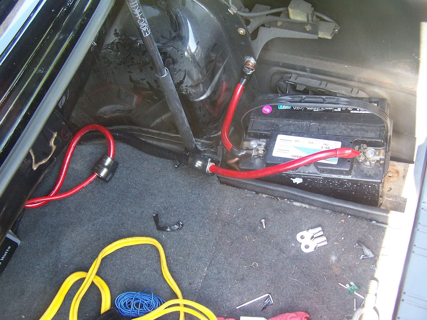

    Now go to trunk and remove the right side strut, right side felt/rubber liner, and then remove the back cover, which covers the motor area. Now you will be able to see a small whole at the floor level on the right side of the trunk. Feed the cable though that, then out the hole on the pass. side. Then down the floor covering it with that opaque plastic “S.” run it through the clips, BE VERY careful not to break them. Then up the wall behind the speaker grill and through the whole I showed earlier.
    I had to add 8” more to the wire.
    hope this help you.

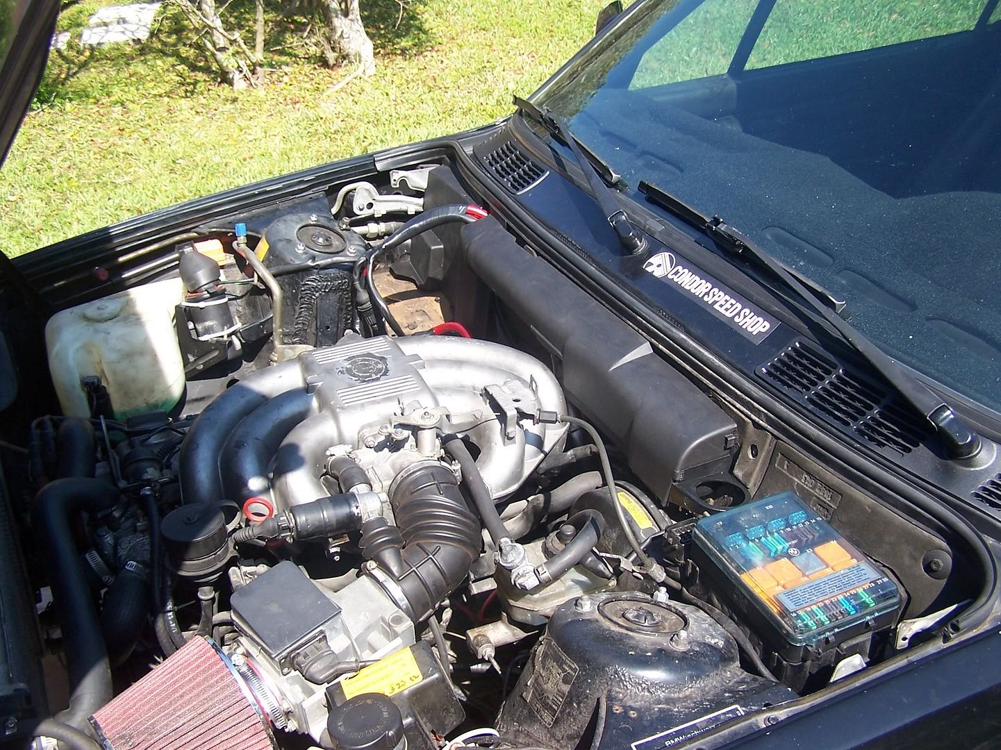

    Vivek, you need the cable, battery tray, battery cover, trunk cable holder, and the mount for it in the engine bay. cost me $40 for it all at pic'n pull 1/2 off day. (318 does not work. needs to be from a 325i)

      I did the same, but I routed it differently and just added the M42/S14 harness covers + battery tray cover (needed trimming for my 0 gauge run is all).
      Left the trunk alone, didn't bother putting the carpet panel back on the right side....I don't care enough.
