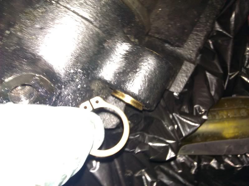

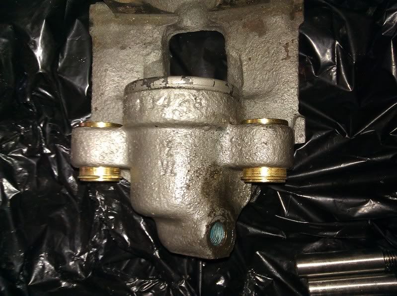

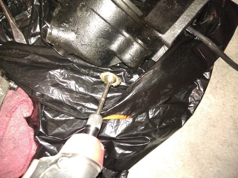

    Did these a couple nights ago.
    Cleaned up the holes a little
    Brakes are finally bled and the pedal has the proper pressure. Whew! Hopefully changing out the fuel pump this weekend for a known good unit. Also changed my fuel filter out but need to switch it around being I just repaced it like how the other one was on it. After looking closer, the original owner had replaced it backwards. >.<

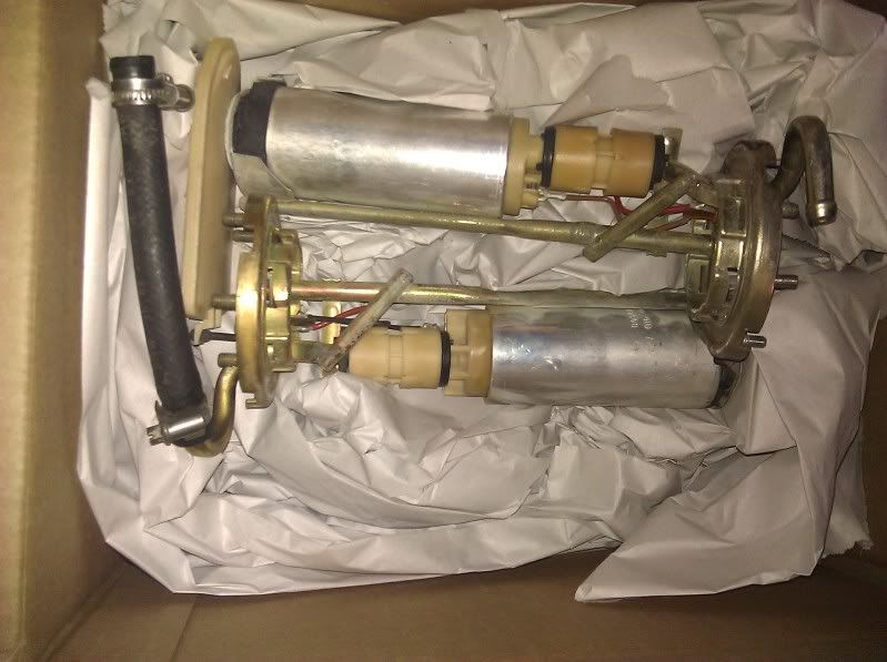

      Dom just dropped these off. One good one not. any ideas on how to find out which one is good?
        Connect them to a battery and see if one pumps and the other doesn't? Not sure if it's as simple as one that runs and one that doesn't. I used a 12v bench supply to test my old one, which made a very faint hum, when I connected the new one to compare it blew the dust cap off the outlet.

          if you have a trickle charger hook it to that,
          like 4drpwr said above itll turn run or not

              yep. i'm 90% sure the one with the sock on it is good. just hook it to a battery and the good one will hum.

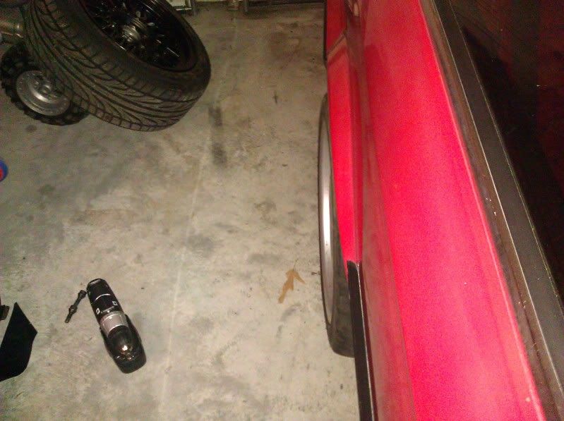

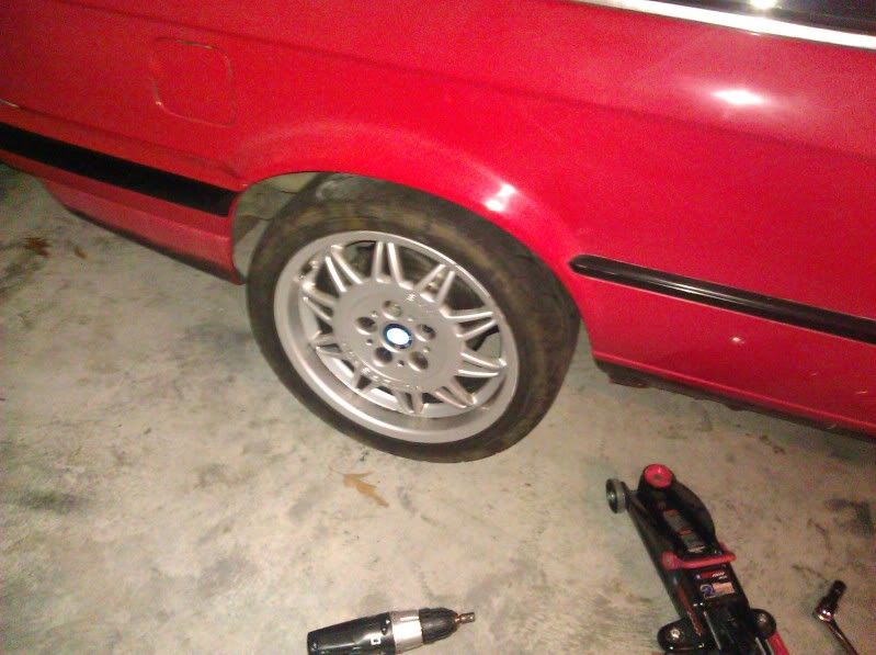

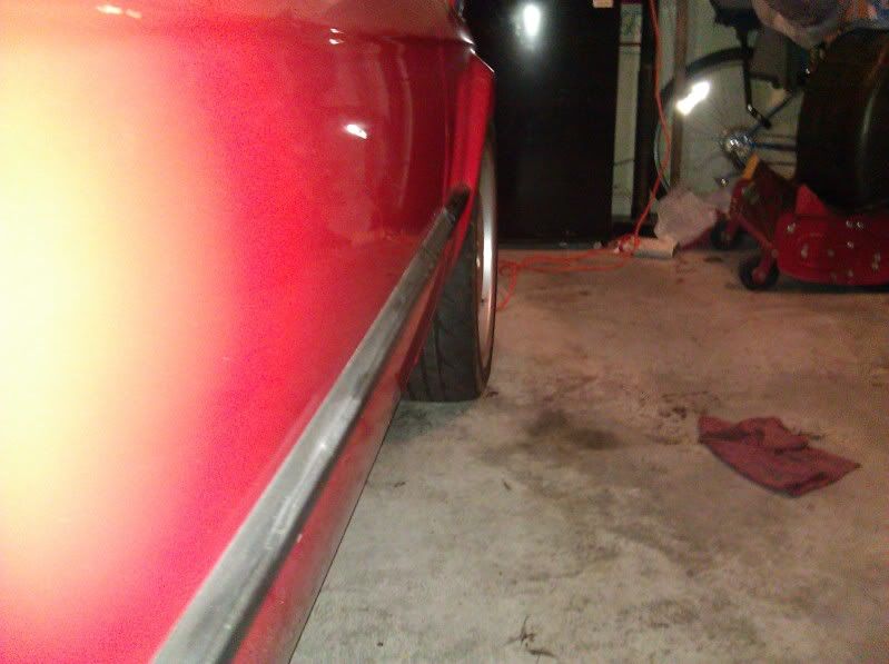

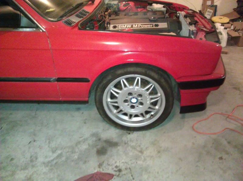

                      Playing with different offsets. Starting to make me like this set up better. Also got all of the suspension sold. Should be taking it off over the next couple of weeks and going with the z3 AST 4100's with e30 camber plates.
                      Also have issue with not getting spark right now on the motor. Thought it was the fuel pump bump I jumped it last night and it still didn't turnover. Going to start eliminating possibilities with that next.

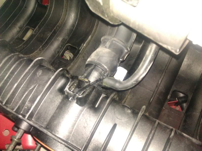

                        Well I thought it was the CPS gone bad because the resistance was reading in the low 500's, but I got a new one and it reads exactley the same. Bentlety said it should be around 1280 ~10 ohms. Putting it back together tonight hopefully and redid a couple things.
                        The clip on this plug breaks pretty easy and its been suggested just to go ahead and break it and use a zip tie to hold it in.

                          Yeah that plug sucks.

                            Horrible design imo. Hoping to get this motor back together tonight. I work all weekend and need to get my suspension torn down and ready to be shipped. Got AST coilovers on the way. :)
