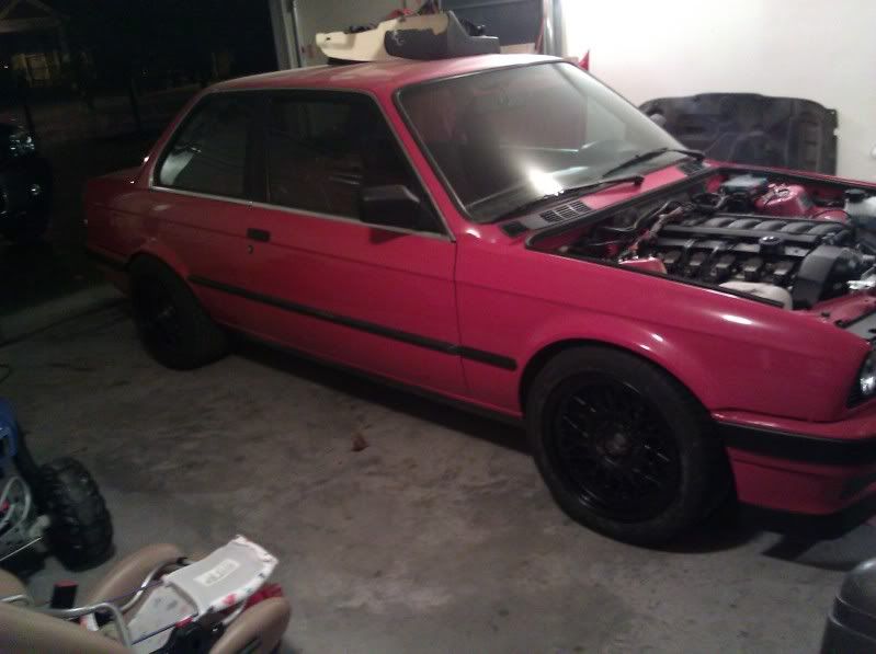

    Worked on it last night and got it all put back together. Got out there 1st thing this morning and she fired right up the very 1st try and idled smoother than ever.
    Evidently the CPS was fine and the Bentley is wrong on what the resistance should be on that sensor. Second time this week I've found something wrong in it. :(
    I think it had a massive Vacuum leak and that was the cause of the no crank. Didn't realize that a vacuum leak would cause the computer to not turn on the fuel pump and not give spark. I've got clamps on every possible hose you can think of now. :) Actually used a couple to keep the hose going to firewall from colapsing as well.

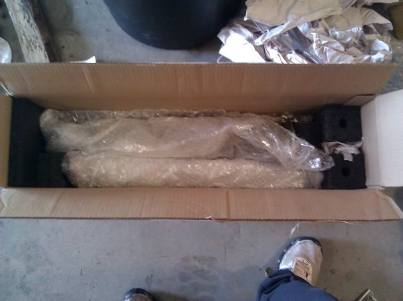

        This showed up yesterday
        hmmmmm, Something is missing
        They left the rear springs out of the packaging. Sucks because I've been waiting a minute on these. Left Jack a message and email already so I hope they get them out early next week.

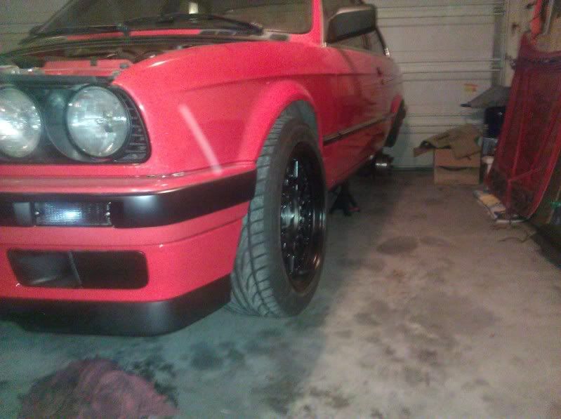

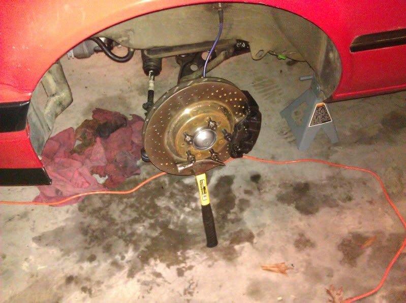

              Replaced the crush washers on the power steering pump last night. Hopefully will stop/slow a leak I was having.
              Also got to install the front coilovers.
              Camber plates help get the wheels back where they belong. Probably still going to get a better offset wheel. I imagine when I get it aligned they will be poking out there again. :(
              Can't wait to get it back on the ground
              Dom said he may have some rear coiolver springs I can use until mine get here. :)

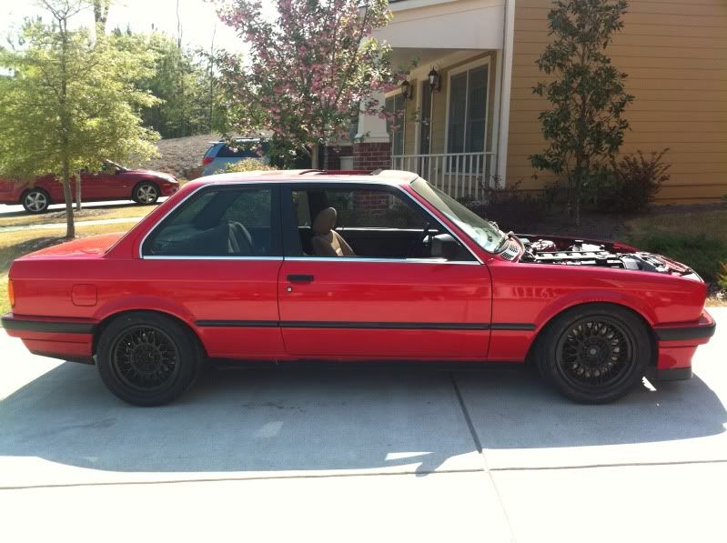

                    Interior went back in last night. Going to wait until next winter to turn everything black. Got the carpet for it but would rather spend my money on tring to get this thing on the track this year rather than looking how I want it to. Hope fully got m3 rear seats on the way in a couple weeks and will be getting Creative options to get me the kit to recover them in a black leather/micro fiber combo.
                    For now though
                    MattB hopefully will have my new boot and ebrake cloth coming soon. The cat I ordered from Summit showed up the very next day! :) Thanks Mike for telling about that one. I pulled it out of the box and it's looks like it going to work perfect for my application. Off Friday but unfortunatley the Vband's aren't scheduled to get here until Monday. Sux because I really wanted this thing to go to the exhaust shop Friday. Whats one more week in a 2 year build though right? ;)

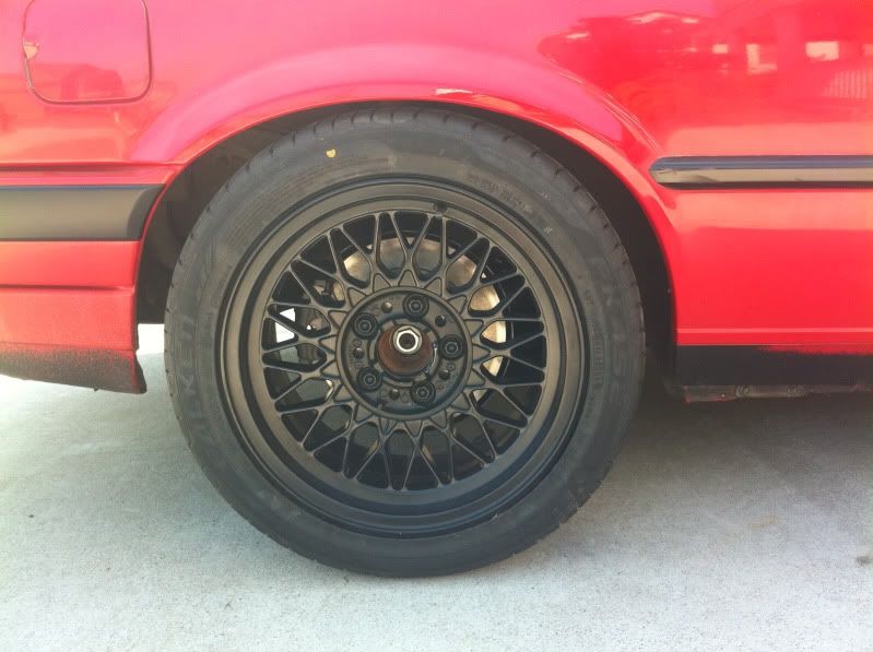

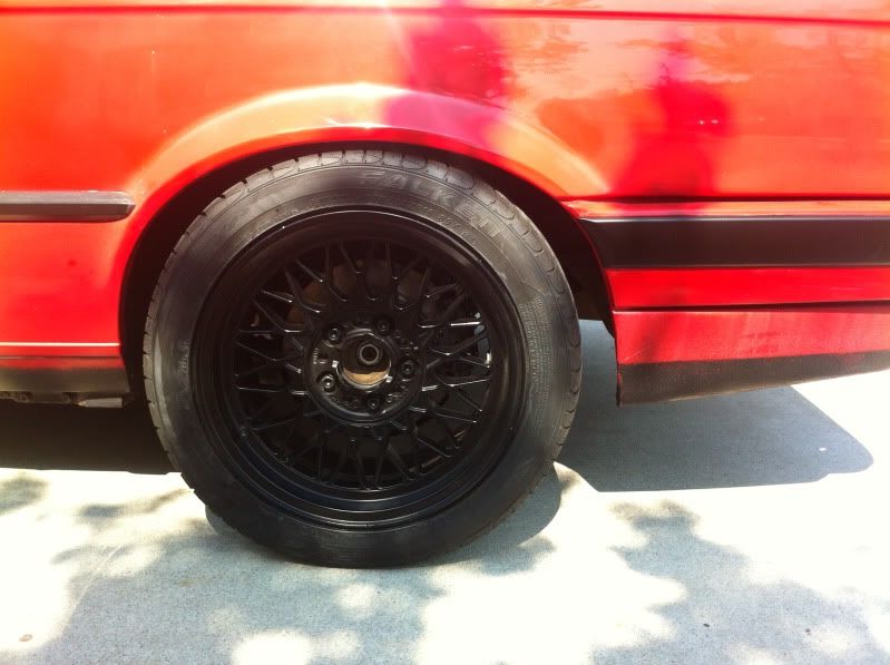

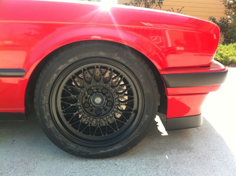

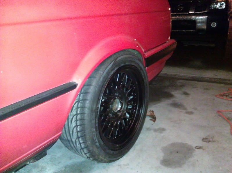

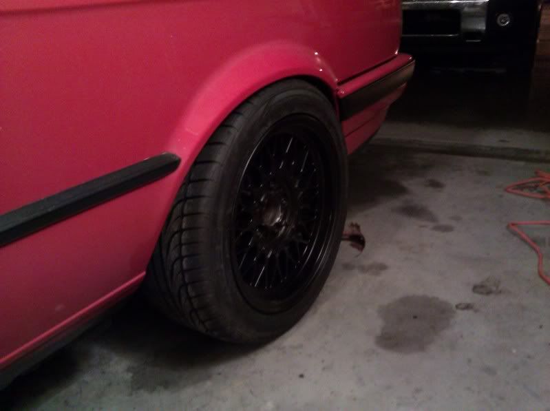

                          Some pics from the weekend
                          rear
                          front
                          Car is not setting the way I want it to right now and will require a different wheel or a severe roll/pull from the fender. Looks like some DSI or DSII's will be in my future.
                          Futue plans definetly include shadow lining the car! :)

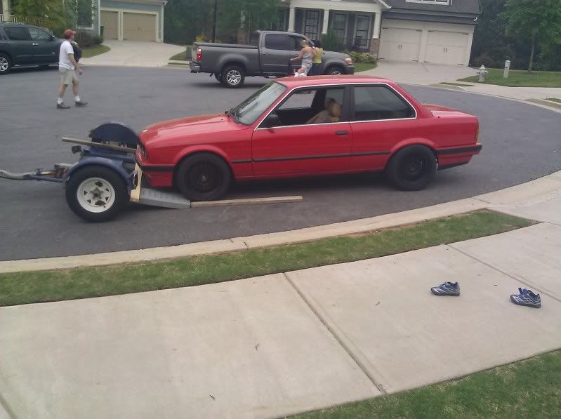

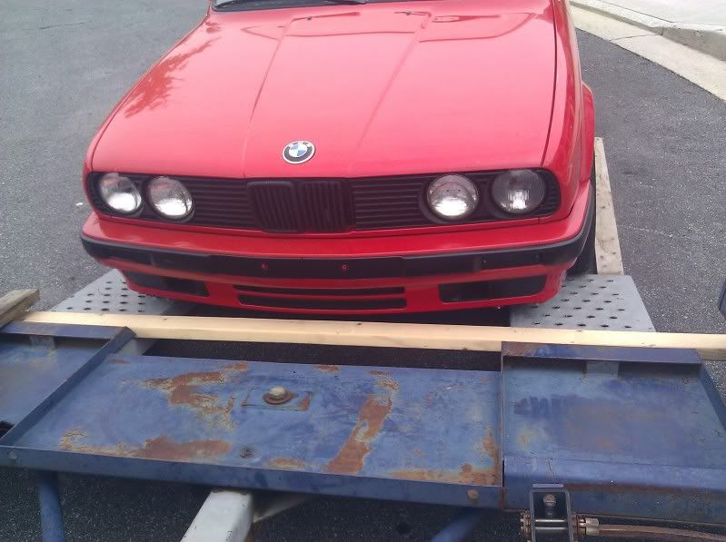

                              Well the car is at the exahust shop (Sorta) until Monday. 1st time in 2 years this car has not been in my garage. Feels kinda wierd going out there right now. Was hoping to get it done Friday but the supply shop Kyle uses was out of what we needed. So Monday it is.
                              Also got ARP studs for the mains on the new s52. Taking them to the machine shop on Monday as well.
                              Car should be terrorizing the streets come Monday ninjas! muahahhaha
                              Some pics for the add folks
                              hmmmm too low
                              Had to raise the suspenion and use 2x4's to get it on. Also removed the is lip.
                              Hopefully Monday or Tuesday I'll have video clips of it.
