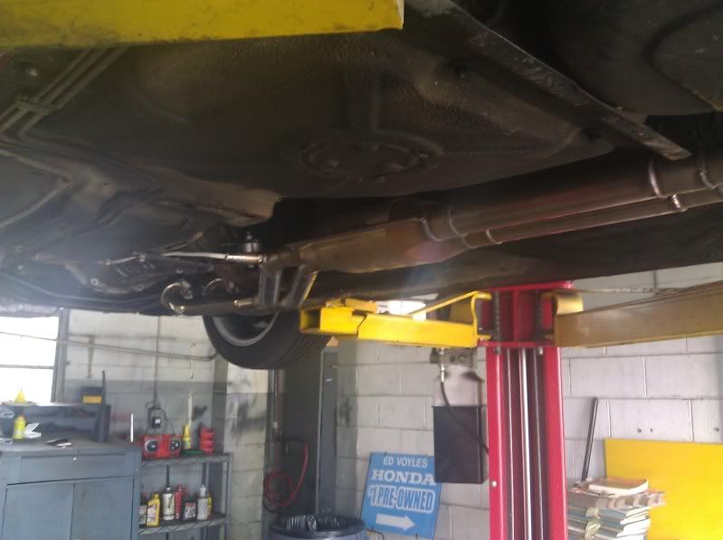

    Some pics from under the car.
    V-Bands from Burns

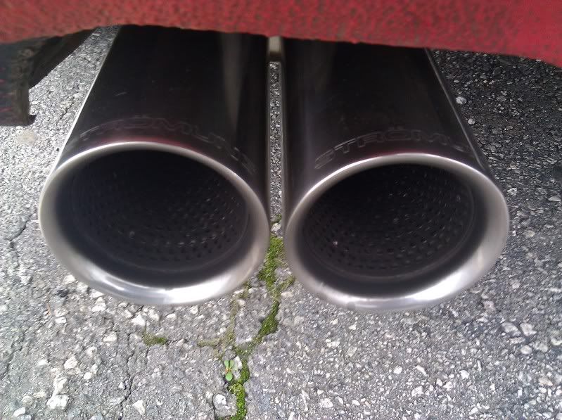

    True dual set up with a dual inlet/outlet Cat. The cat has an open chamber inside that helps balance the everything out. Car sounds great with minimal rasp at certain RPM's
    Drove it hard last night and was very excited on how the car performed and felt. It really feels glued to the road. Can't wait to get it on the track or auto X. The 3.46 rear end seems to be a good match for the 260 and s52. Temps never get even to the half way mark even without the fan on. Thinking of putting flares on sorta like the ones Newman has on his car because I really like how the style 5's look. We'll see.

            Where did you get that cat?

                The cat came from Summit Racing for 109 BTW.

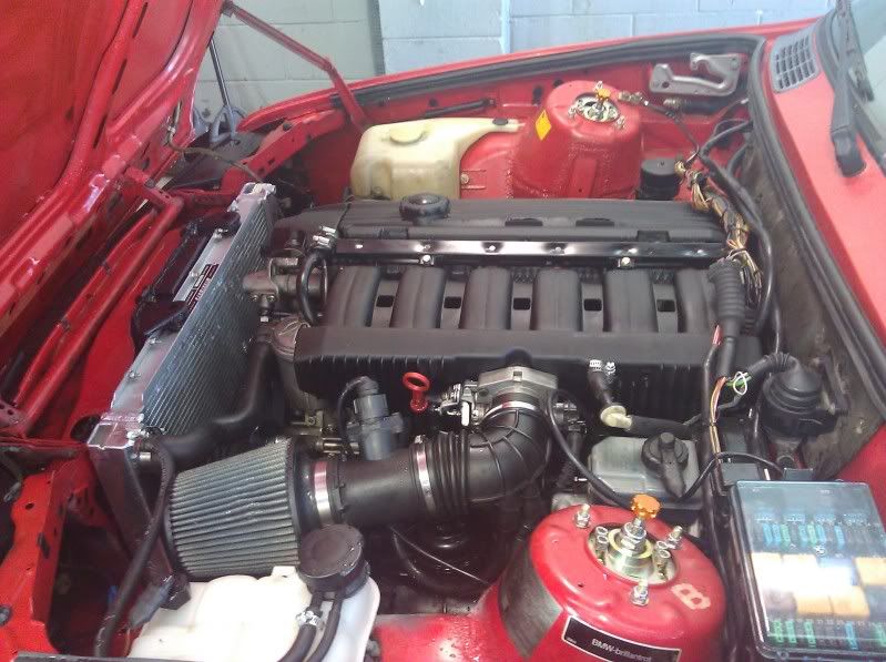

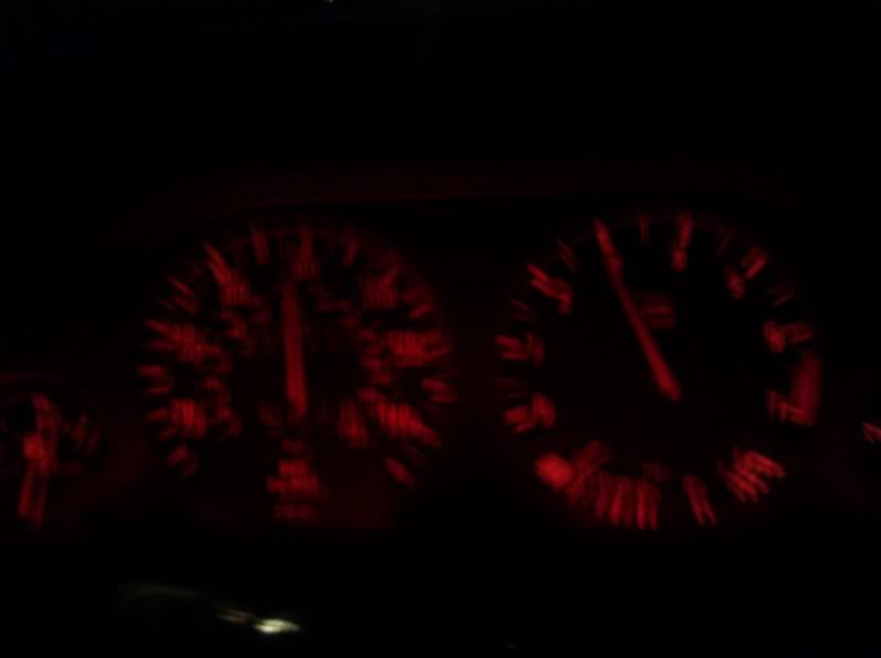

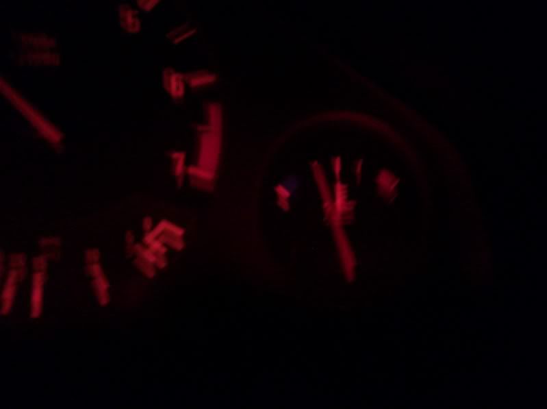

                      It never gets above this withthe mishimoto, lower stat, and all new cooling components. Cell phone pics at 80, not so good lol

                            Your car runs quite cool! Mine stays at a smidge past the middle mark.
                            I'm running:
                            40mm PWR aluminum radiator
                            Stewart water pump
                            75 degree T-stat
                            16" SPAL pusher fan that clicks on via the lower temp (91 degree) fan switch
                            I wonder why yours runs so much cooler...

                              Yeah, I would grab a temp gun and check things out. It looks like you are running too cool. Maybe the Thermostat is stuck open.
                              -tim
                              Originally posted by Jordan
                              I like the stance
                              • samiam3356
                                • Jul 2009
                                • 1901
                                #75
                                yeah I was actually worried about it never coming out of closed loop but the car runs perfect pulls strong as hell. When I'm at dead stop it will get hot enough to kick the fan on. Other than that the fan hardly comes on. Everything is brand new on it, including the thermostat and pump.
                                Time for the temp gun as you guys say.
