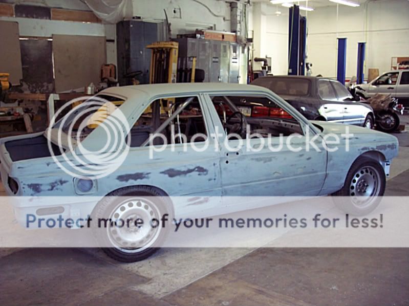

              Long time since the last picture update... I've been busy at the shop and I have not worked on it for about 2 weeks. I rolled the front fenders flat and then schutzed and painted them on the inside, so I could mount them and block them with the rest of the bodywork...
              Then I shot the whole body with primer, misted on some guide coat and then started blocking. Discovered that even brand new panels from BMW need work to make them acceptable... this may take a while...
              The hood will need the most work...
              Drivers side is guide coated, but not blocked yet...
              I still have to pick up the drivers door, which I have not had time to go get. Maybe sometime this week or next weekend, we'll see...
