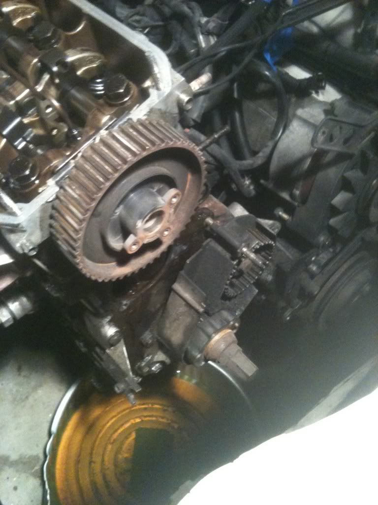

                              I started off where I last left with the timing covers. Once they were off, I checked the tension on my timing belt since I was curious. Lets just say.... it was certainly time for some maintenance....
                              After pulling the timing belt off, I worked on the exhaust manifold. Bit of advice for you first timers, take the manifolds off with the head. You will find that removing the manifolds with the head on a bench much easier since the lower manifold bolts are easily accessable.
                              Now that the headbolts were removed in order, its ready to be pulled...

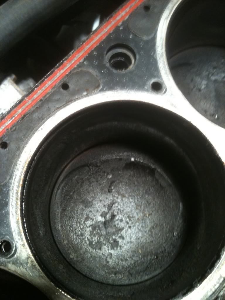

                              Now, the for the bottom end. I am pleased to see the cylinder walls are still in excellent shape. The pistons, however, had quite a bit of carbon buildup. I will be working on cleaning these up tomorrow afternoon.
                              Cylinder 1&2
                              Cylinder 3
                              Cylinder 4
                              Cylinder 5
                              Cylinder 6
                              Now let's have a look at those- fuck.... hold on, forgot to move the oil pipe.

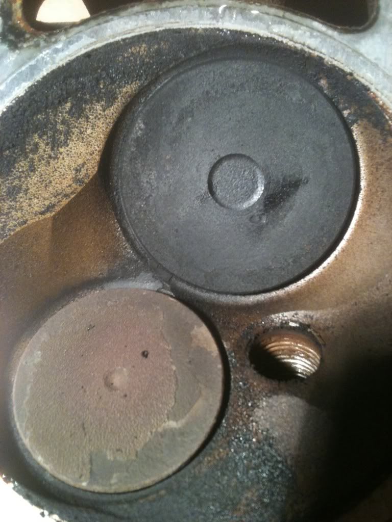

                              Now let's have a look at those valves.
                              Cylinder 1
                              Cylinder 2
                              Cylinder 3
                              Cylinder 4
                              Cylinder 5
                              Cylinder 6
                              Turns out, I also had an exhaust leak... Might explain all the chipped paint on the passenger frame rail...

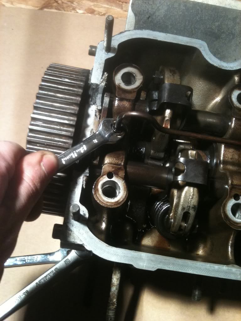

                              Now, let's remove that cam gear and oil shaft plugs.
                              Used cardboard as a spacer. Don't lay the valves on flat surface gentlemen.
                              Rocker arms and Rocker shafts removed.
                              Cam Removed.
                              Cam seal removed.
