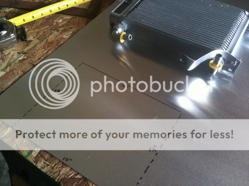

      Okay. So as I expected, said welder went flakey. I decided to give the fabrication, by myself, another shot. This time I did it proper and took my time. Check all my measurements three times and went at it....

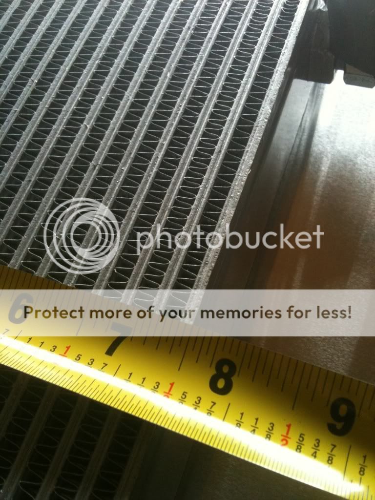

      First, measure the cooler.
      Next, make you basic lineout of said measurements.
      Measure the duct tube.
      Next part is tricky for those of you who don't remember your 5th grade math... Getting the 90 degree angles correct after folding the metal is dependent upon the height of the opening as well as the leveled distance... Which even I struggled with at first..
      Cut the bitch out and fold it!
      The next will be the side of the duct. I'll need it to better flow air and deflect debris from my passenger tire on left hand turns. Make your measurements accordingly.
      Cut and fold.
      Mock up.
      Painted and cut slots for steel zip ties.
      Installation.

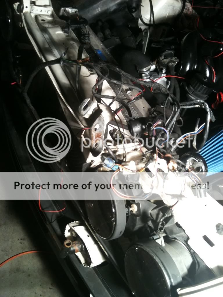

                                Bimmerteck was kind enough to give me some assistance in tracking down the correct plug for the spal fan on the wiring harness. aside from that I also have some rewiring to do on the turnsignals, foglights, and a couple of the headlight connectors since they were old and cracking. I have the passenger side pulled out at the moment and am getting things cleaned up.
