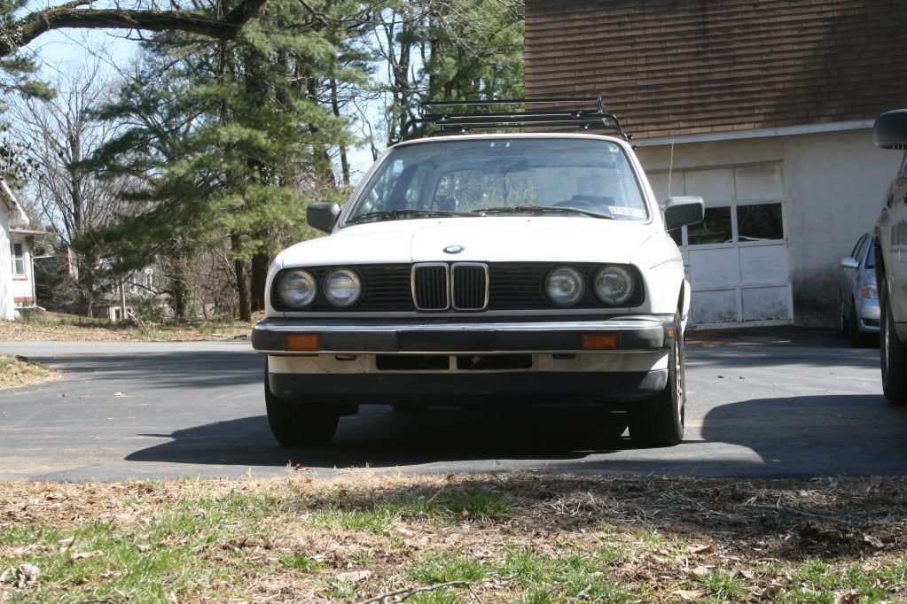

So it was March 10, 2011, and Cav calls and says, "what do you know about e30's". Me being a VW guy, say "there solid and timeless". Fasts forward 24 hours later and the car is his. Looked good while we checked it out in the rain!
Yeah it dind't have a front valance, but the pop out rear windows and diving boards made the car. Not to mention the blue leather with Sport seats were classy as hell. The headlights didn't match, but those will get replaced by a new french set later on.

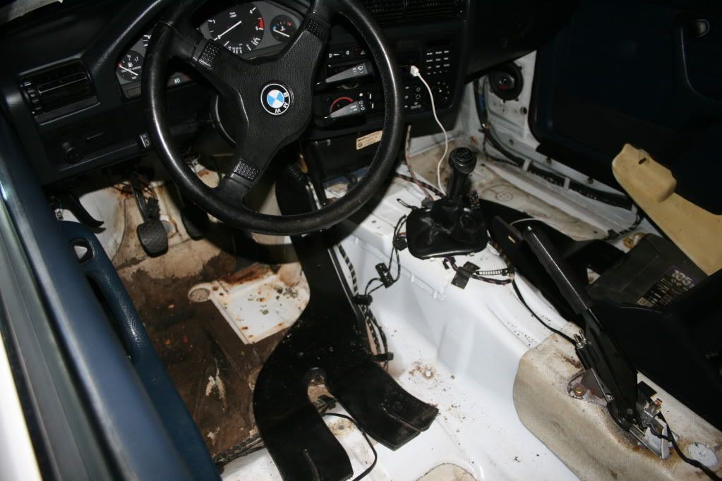

So the interior was gutted to see why the carpet at the petals was wet.

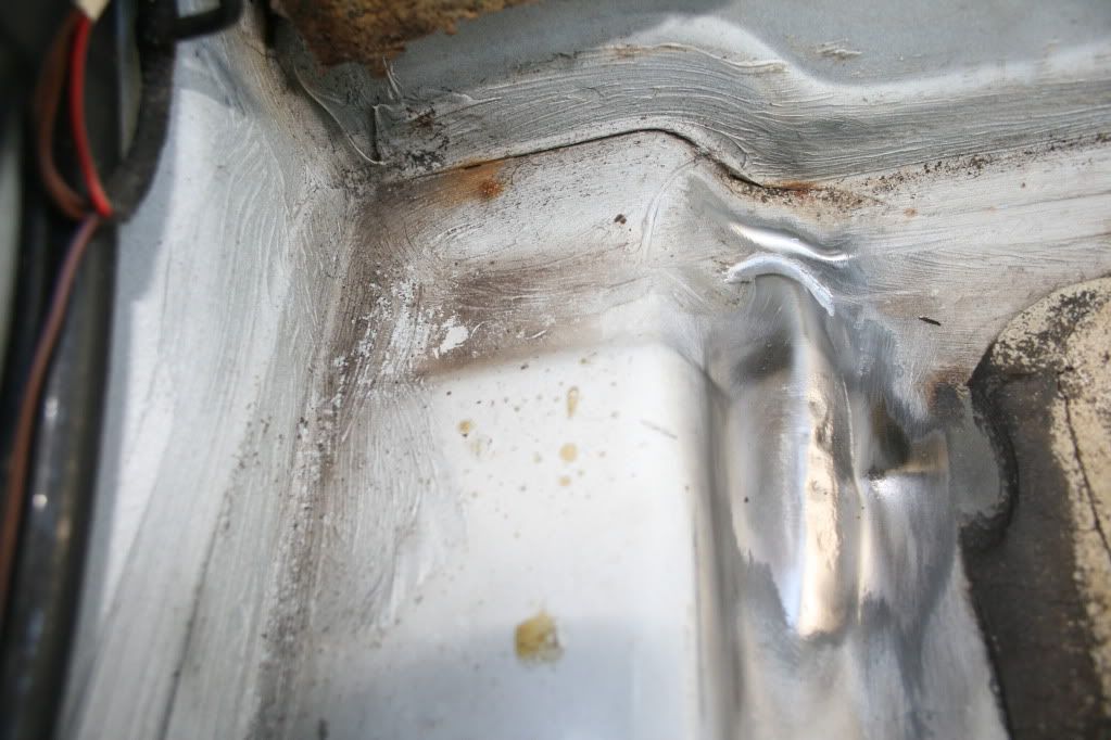

Then, the rest of the hidden gems revealed themselves to us.

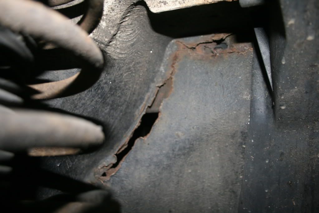

This one is our biggest hurdle as it goes throught the fender / firewall right onto the brake pedal and clutch.
SO we have our work cut out for us. We have a body guy who will be cutrting out and replacing the driverside portion of the firewall and gusseting for strength as well as replacing the accelerator pedal bracket on the floor. This will happen over the next couple of weeks.

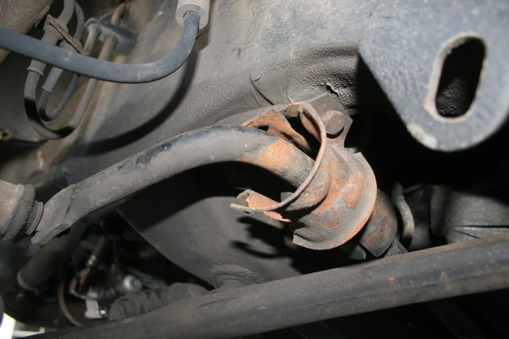

In the meantime the sway brackets and bushings have been ordered and some other trim items.
