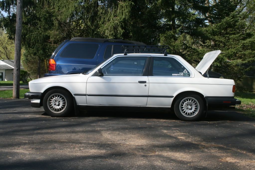

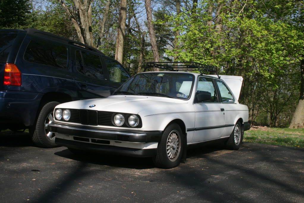

    Well the car has the suspension in and looks much better. Also picked up the wood and will throw up some pics later today.

      its coming along, good work

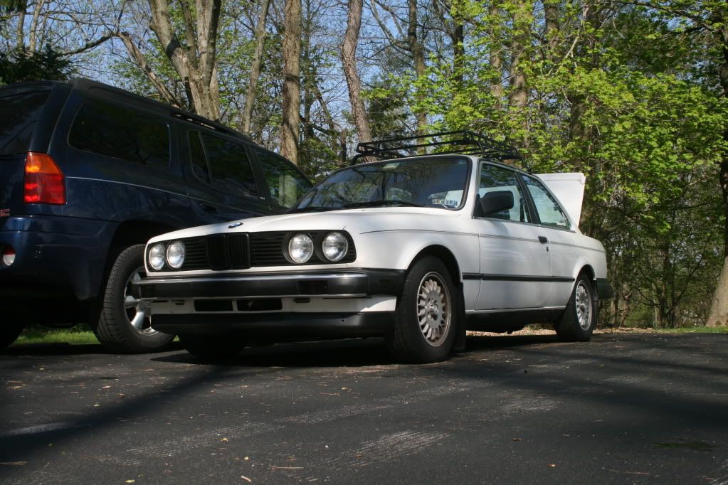

      E30s are know to be notoriously really really really ridiculously good looking
      • Kershaw
        • 11822
        maybe throw on an 87 is valence?
        AWD > RWD
        • CHIF8008
          • 3447
          get the ES valance. much cleaner. and it actually goes with the car
          -FREEDOM- is cruisin at 80, windows down and listening to the perfect song-thinking "this is it"
          -The Beauty in the Tragedy-
          MECHANIC SMASH!!- (you all know you do it)
          Got Drop?? ;-)
          But of course
          • oreilly
            • 58
            I've been looking for an ES valance, just can't seem to find one somewhat local. Really don't want to have to pay a ton to ship that thing. Hopefully Lavent at Guten will find me one since hes so close and helpful (wink, wink)!

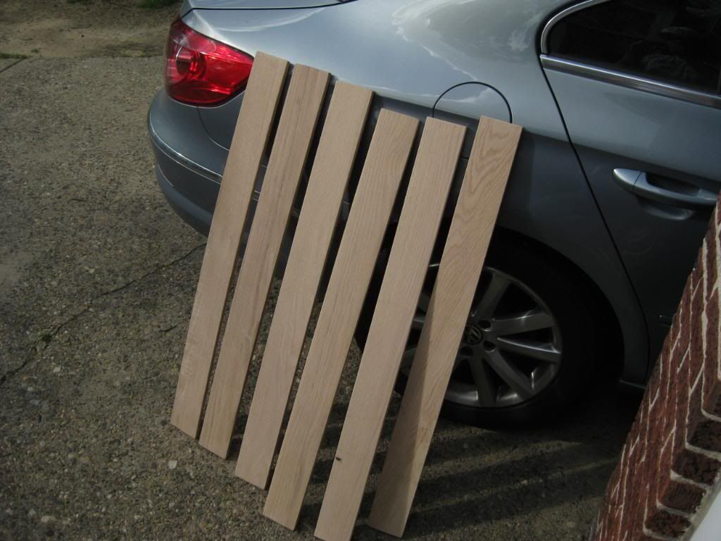

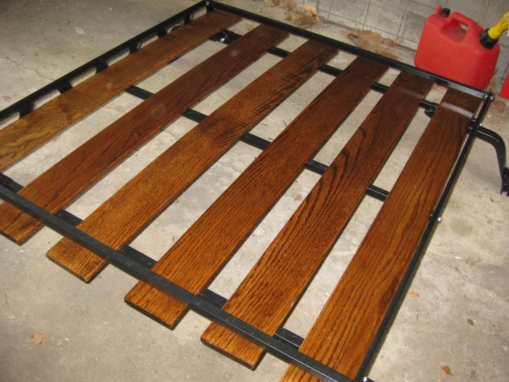

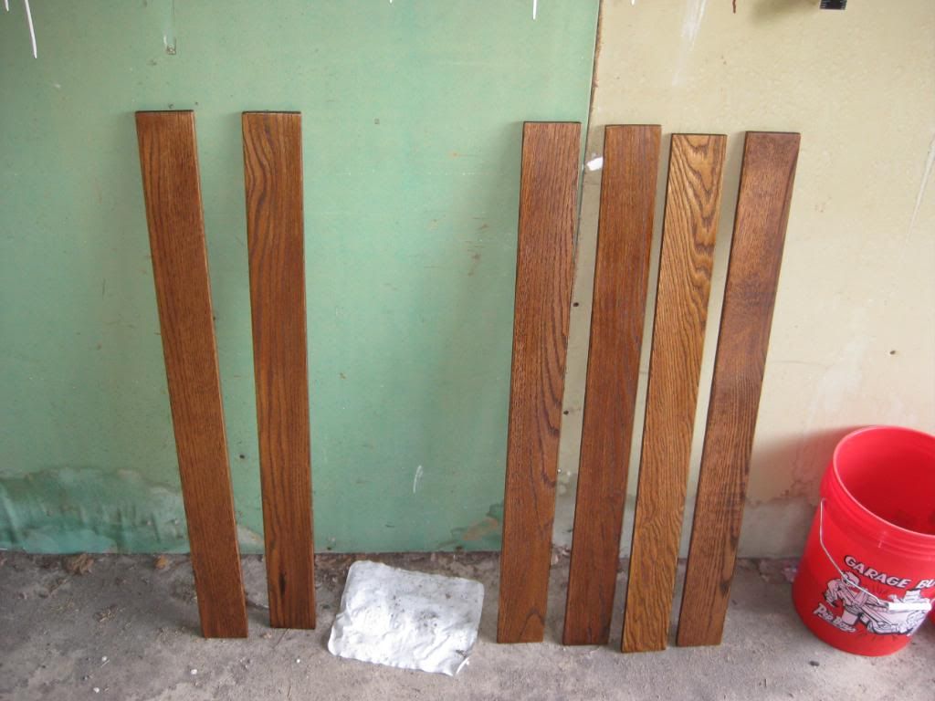

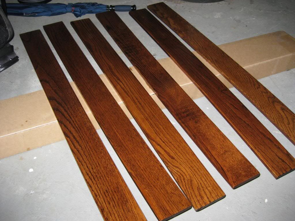

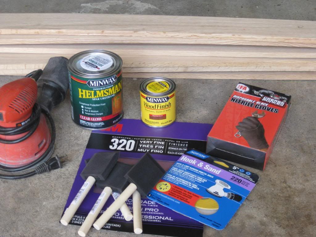

              Well I started on the small project of getting the wood ready for the roof rack.
              I chose Oak slats 1/2"x3 1/2" so the grain would pop when finished. 6 slats with about 2" spacing between each, using stainless hardware, other metals will tarnis and blacken the wood.
              Supplies:
              Cut and sanded with 220:
              Stain and Poly (use marine grade poly so it holds up!):
              1 Coat of Stain:
              1st of three coats of poly, will sand lightly with 320 grit between coats:
              Total cost was roughly $80 for everything needed.
              We'll be installing on the car Friday, more photo's then.

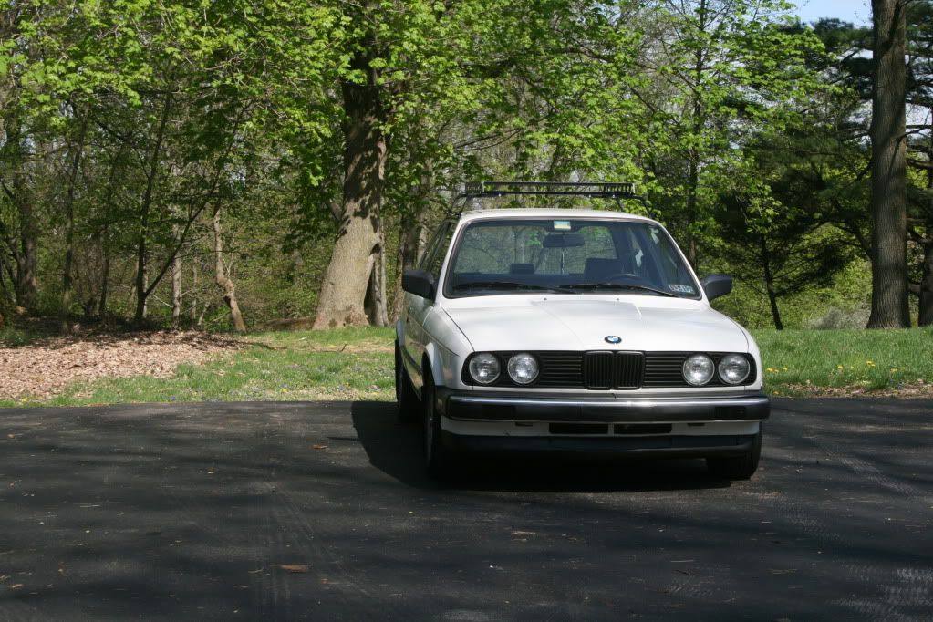

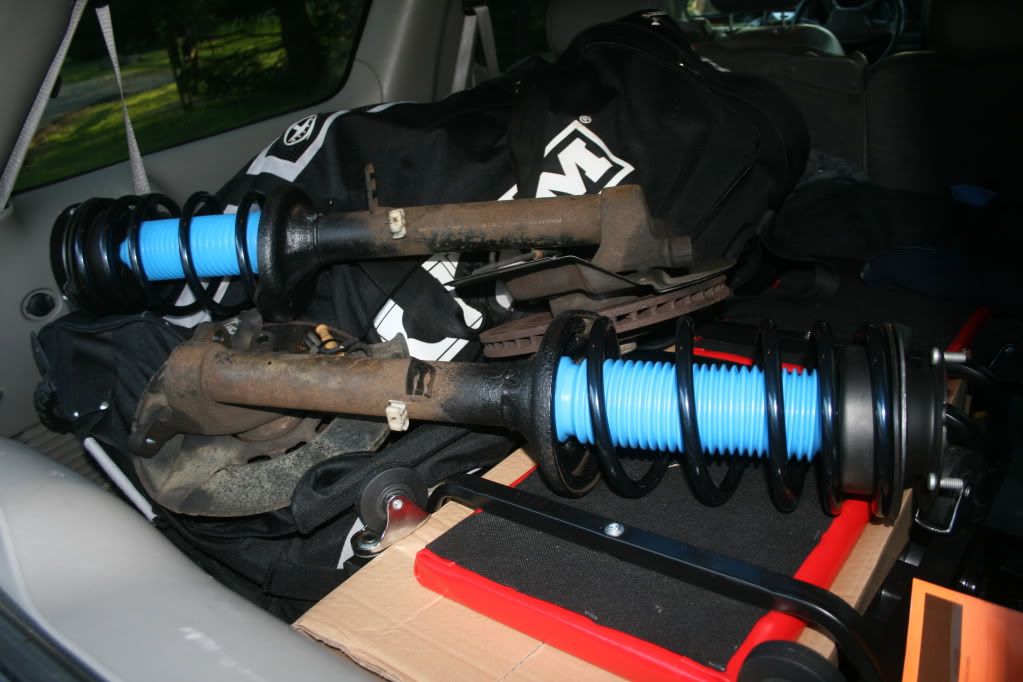

                oh yeah, we got the suspension put together. Couldn't get the oem shocks out tof the fronts so had to take them to Bimmerworks who worked there magic and asseblem them for us with the 15mm Drop Hats from Dynamic Motorworks.
                And some shots after the install, it will settle a bit and I'll update later with a pic.
                H&R Sports with Bilstien Sports, 15mm Drop Hats front with pads, rears have 1 pad removed.
                Before:
                After:

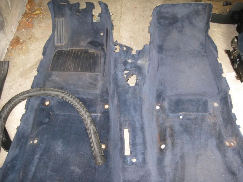

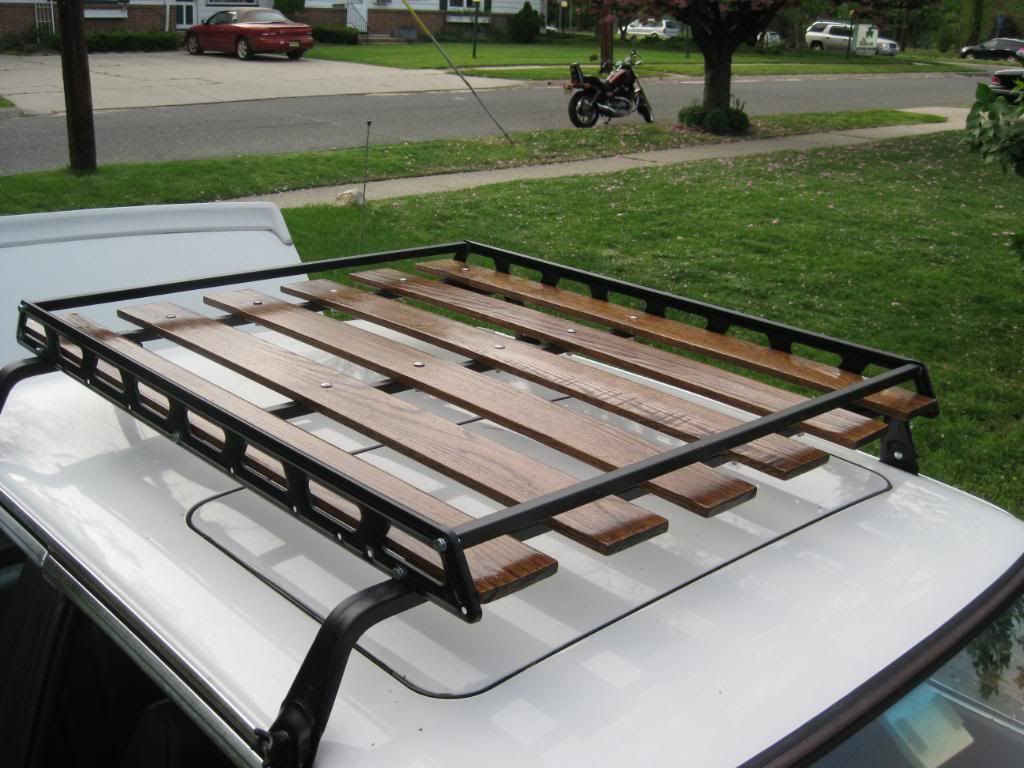

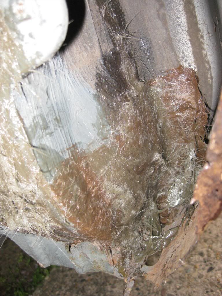

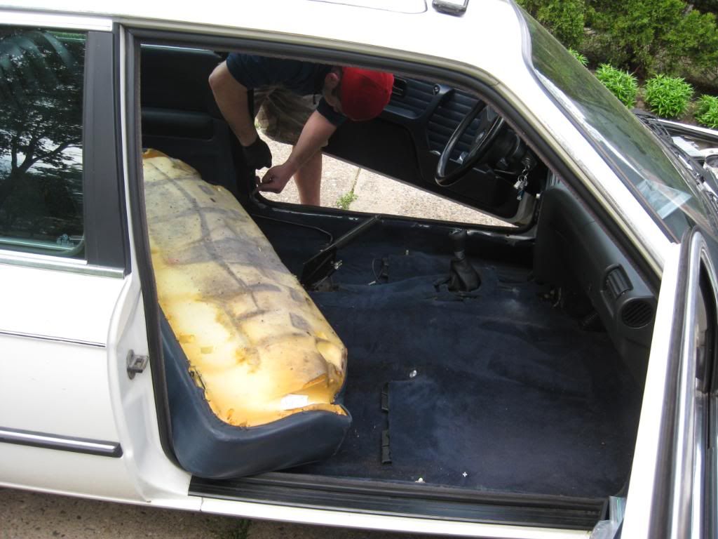

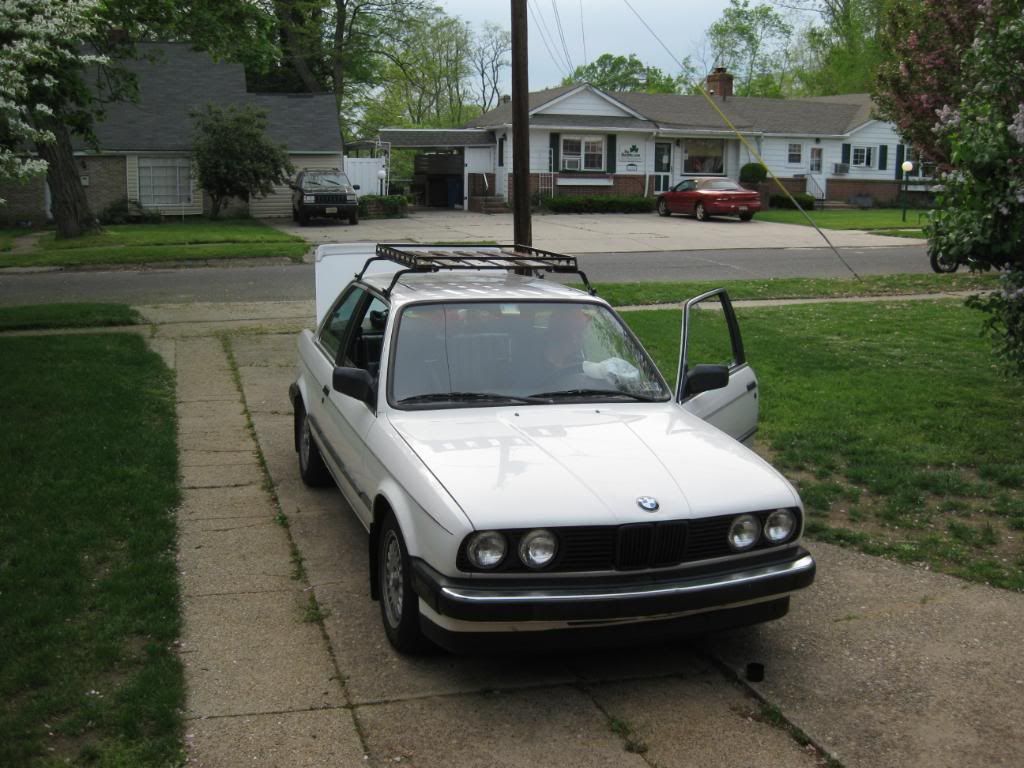

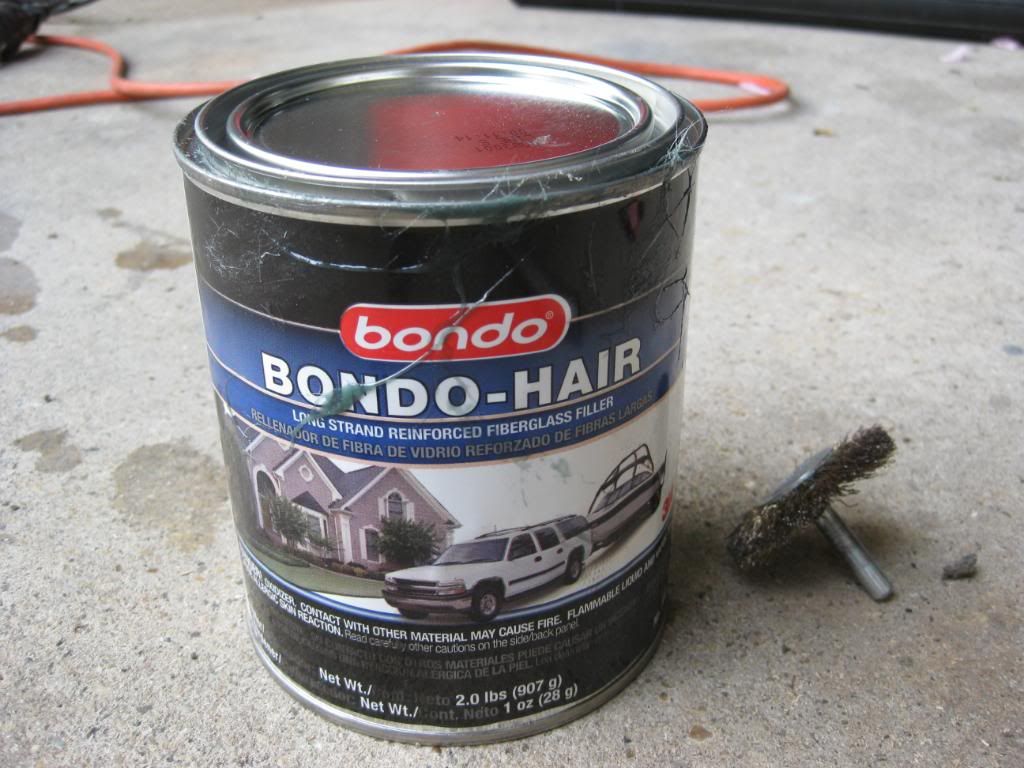

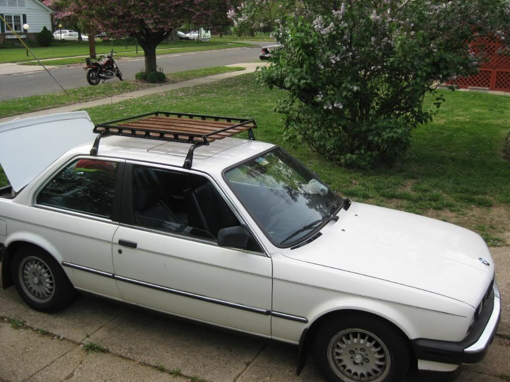

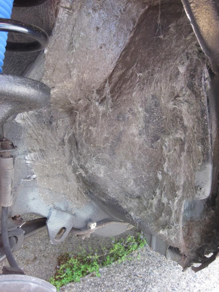

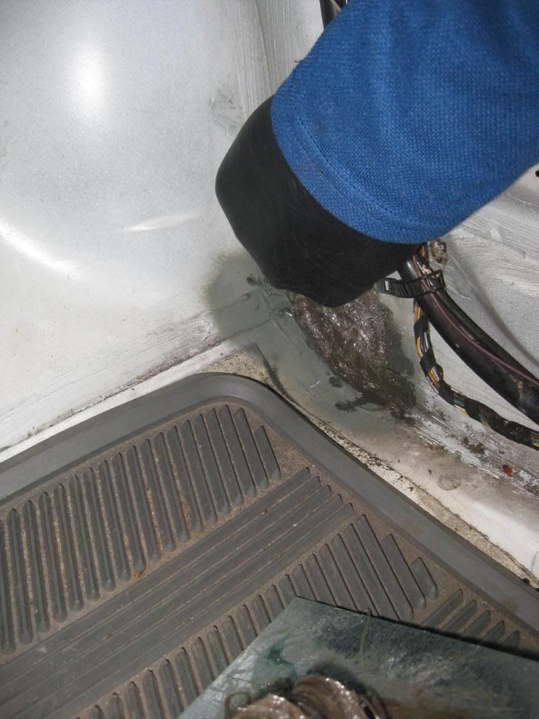

                  Some updates,
                  First we had to plug up the holes to keep the water out. These are really rough and not supposed to be pretty or proper. This car needs to last 2 years anything beyond that is gravy. We used a patch panel from a parts car, riveted that in then used Bondo Hair on everything and layed down a ton of underbody coating on top of that.
                  Finally putting the interior back in after 2 months of road noise!
                  And the finished rack

                  • rich4rdee
                    • 595
                    sweet roof rack...
                    coming along quite nicely
                    • Vince30
                      • 2318
                      I am thinking this is going to be an awesome e30 when its done. Great work so far.

                        • Jand3rson
                          • 37587
                          Great work so far, all I see in this car is a blank canvas full of potential.
                          However, I cannot figure out why any amount of time and money was spent on yet another of those stamped sheet metal roof racks, where there is SO MUCH work to be done with repairs on this car. I can't believe you're even driving it with that rust damage above the rear spring perch.
                          • mkoneod
                            • 562
                            Reminds me of my 87 when I got it in 09'...(Car in avatar)
                            • glucklich21
                              • 1912
                              Fiberglass isn't exactly a substitute for missing metal....
                              • Jand3rson
                                • 37587
                                Holy shit. I didn't even notice that that's what was fiberglassed... wow.
