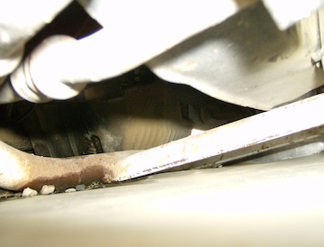

                  Yes, skid plate must be removable. My very stout, very well built, brand-new skid plate turned out to be one-time use from the abuse it took. The plate was flat on the bottom, then had a significant bend to tuck up nicely under the bumper. Well, let's just say now the whole plate is flat.

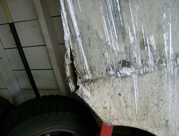

                        #191
                        Yup, durability is the key.
                        My skid plate is/was 1/4-inch aluminum plate. It covered the whole underside of the engine and we even had a mini roll cage (bash bar) surrounding the the oil pan and we STILL cracked the pan.
                        In Pic 1, you can see the plate in the foreground, the bash bar, then the pan. There used to be three inches of clean air between the plate and the bar, and the bar and the pan.
                        Pic 2 is a bottom view looking up where some killer Maine rocks lashed out and shredded the welds.
                        Pic 3 shows the dent in the plate from the rock that pushed the bash bar into the pan.
                        I think I'll relocate my oil pan to the roof.

                              #194
                              I think I found new sig material.
                              Also, Mike, I would suggest somehow tying your "bash bar" mini-cage for your oil pan up to the subframe by angling bars off the bash bar up to the frame rails, to support any loads that would come directly up into the oil pan, like landing on Mt Everest.

                                #195
                                Ha ha, nice! Thanks for the sig addition.
                                I'll take a better picture of it when I find myself underneath my car again, but you can see the bash bar a little bit here.
                                If i didn't have this thing, or the skid plate, I wouldn't have made it past Stage 1.
