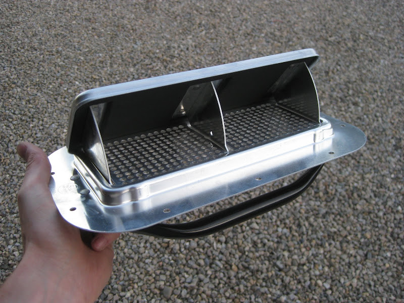

You didn't go nuts on the roof vents did you? Some pay $400+ for carbon jobbies. I paid $50 for both. Straight from a UPS truck. Literally. They're the side kick vents from a UPS truck.

I almost threw up in disgust when I first saw that rally vents are $300. I surfed around on the specialstage forums and found a place that sells side vents for passenger vans and picked up a slick aluminum one. Turns out I'll want two, but I was able to test it today with the sunroof hole and it moves a good bit of air into the car. $25 from a place called Mill Supply.
It's a pretty solid piece with very positive opeining and closing action. Opens both ways, and the black you see on the bottom of the flap is some foam to seal it off when closed. Should work great.

I like the fact that they will keep gravel, sticks, branches, from flying into my lap. And they seem to flow plenty, but we'll see when they're installed.sigpic

Yes, rocks, sticks, leaves and small children fit through those holes at highway speeds. I would keep them as well. I have two of those same vents side by side and there is a lot of air flowing through the car. Plus it gives it a vintage look (my car will be eligible for historic class in two years).
