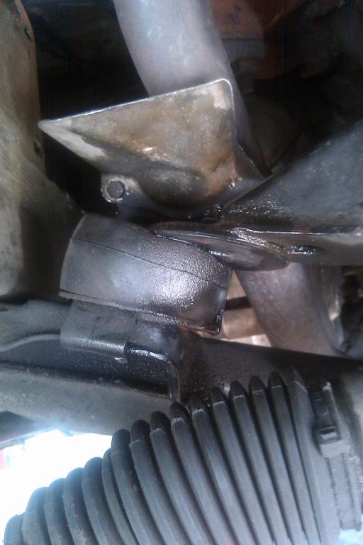

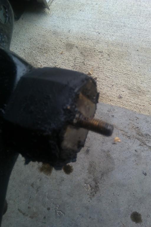

    I was able to get the old motor mounts out!!
Name:	motor mount old split.jpg
Name:	motor mount sliced.jpg

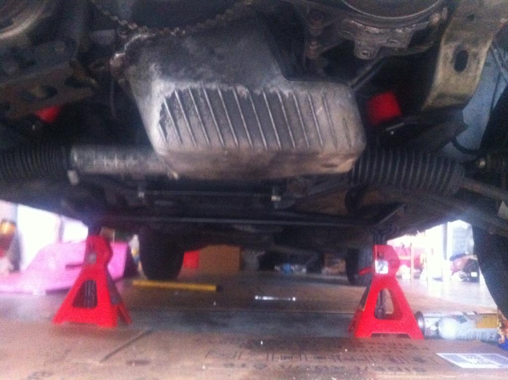

    This took lifting the motor up with wood and a jackstand at the oil pan. Then i had to go to the drivers side and use a 2x4 to pry/push at the oil pan from the top of the engine bay using a long wooden stick, pushing the motor to the passenger side. (above pics show how much i had to move the motor to the passenger side) After a shit ton of prying i still had to push the motor backwards for the AKG bolt to fall through on the passenger side. For some reason it lined up, we could see the bolt head from the bottom, but the bolt just wouldnt fall through! This finally worked by lifting the motor a little more with the jack stand, prying the motor to the passenger side..and voila, the bolt fell through. Some how lifting the motor more pushed the motor back enough for the bolt to come through. The driver side lined up easily once the pass side was flush.
Name:	motor mounts both akg.jpg
    this is the passenger side mount which went in first, i immediately took a pic!
Name:	motor mount pass side akg.jpg
    *Btw, this took me and 2 of my friends to line it up. me prying at the oil pan above from the driver side (to push it to the passenger side with a long stick), my boy on the bottom of the pass side mount telling me when to stop prying once the bolt lined up to the bottom hole, and my other homie lowering/raising/lowering again the jack and looking at the passenger side motor mount bolt from the top while pushing it down with a big pole.hahaha
    I was soo happy it finally worked. we were trying for a good hour and a half i think.

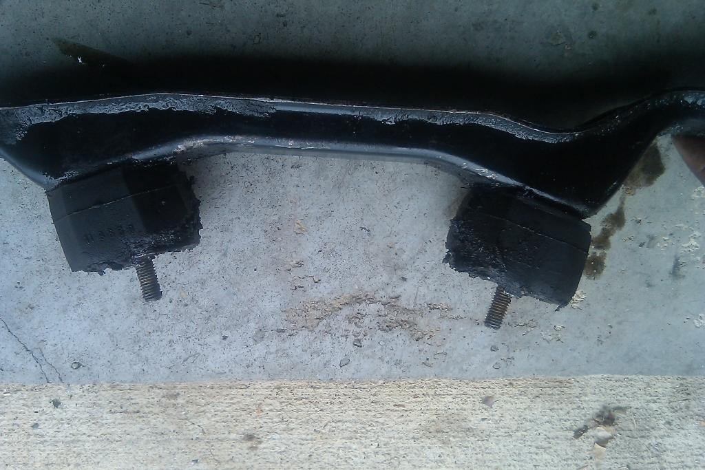

    old tranny mount pics
Name:	tranny mounts old.jpg
Name:	tranny mount closeup.jpg
    I can not wait until things are lined up right.
    If these two very important items have been over looked by the PO Im very curious as to what ill find in the motor.
    Now im thinking i shouldnt hold off on the control arms or differential bushing.
    At least the car will be better than it was before. thats about the only +

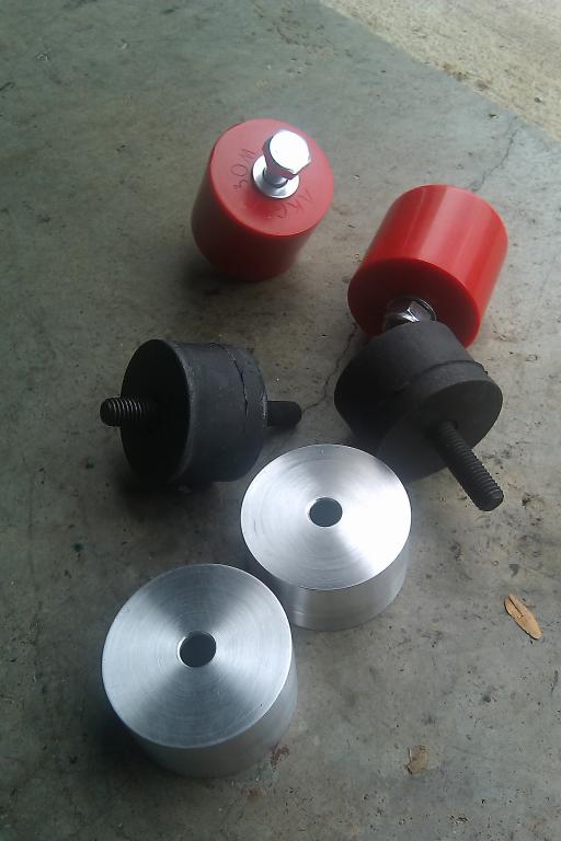

  • ROLLingKING
    replied
    MMMmmmm Mounts
    Got some good stuff in the mail today
    AKG 75D motor mounts and E21 tranny mounts with AKG aluminum trans mount cups.
    looking up diy's on how to do motor mounts now

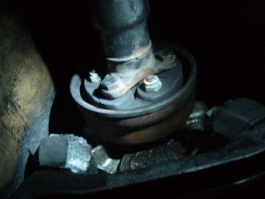

    Guibo problems!! Heeelp!
Name:	guibo shield.jpg
    So theres 3 bolts facing me and 3 nuts facing me.
    the bolts attach the guibo to the driveshaft..then once the guibo and shaft are bolted together...they slide into the shield & bolt to the tranny by the nuts facing me. thats correct right??
    from my research and a very timely thread under the driveline section of the forum ive figured it out. I think
    also got this pic form the thread..
Name:	guibo shield empty.jpg
    While trying to install the SSK i thought I could pop out the driveshaft to install a bushing..I started loosening THE BOLTS (above pic) but as soon as I broke em all free realized there was a nut behind the shield between the tranny. I couldnt get to those so i drove the car.
    Now a bolt is missing. :crazy:
    Im guessing if i torque wrench the nuts i can pull the driveshaft out. Is it that simple?
    If so how do I hold the bolts behind it from rotating and putting myself in the same predicament??
    Any help is GREATLY appreciate! thanks

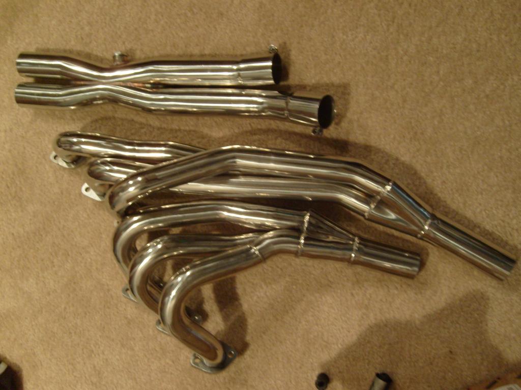

    parts 4 sale
    oh im selling these headers..they were never installed
    $150

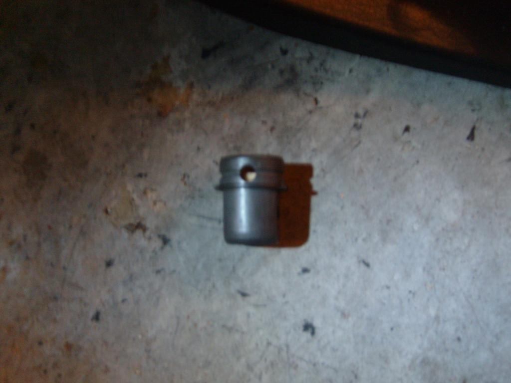

    since that was in the way i couldnt change the piece held in by a pin..this guy
Name:	shifter extra piece1.jpg
    The other extra piece is the rubber bushing where the bitch clip is..that medal rod seen here (below) has a bushing in it but the one sent to me is an OVAL shape..a 12ton press my neighbor had wouldnt get it to go in. there must be another special tool that compresses this bitch while pushing it in...idk
