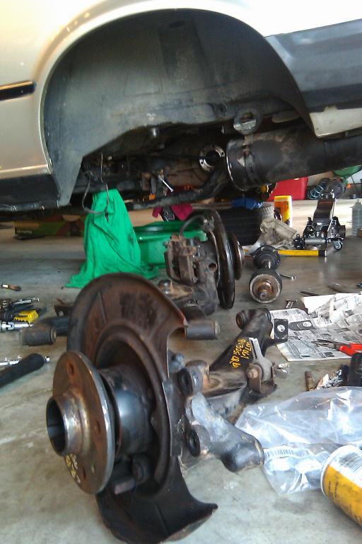

    here is the trailing arm out and the junk one almost ready to go in
    At this point I was so sick of not being able to drive my car I forced myself to figure out how to fix it.lol At first I thought I was in over my head and spent 5 days just looking at it and ordering some replacement parts. Finally I made myself figure it out

    At the same time my car was overheating (this is mid june now), my rear suspension was making a god awful noise. Since I had just replaced it (1st timer) i knew i did something wrong. Turns out the rear strut mount looked like this:
Name:	shock mount blown.jpg
    Now hold on...i can explain. When taking apart the suspension there was only 1 washer at the top of the rear strut mounts. The lower washer wasnt there when I took it apart so I figured it was okay to be put back together that way. WROOONG. so i had to buy new rear shock mounts twice in a month.
    Theen, this is where it gets good....
    While putting my rear shock back in I had trouble getting the left bolt to go in straight. Thinking something just got in there I continued forcing the bolt in until it snapped inside of the rta. btw.. the bolt was about 85% in
    I cursed up a storm!
    Im new to my own car work so I had no clue where to even start on how to remove the bolt. And it was pretty much alll the way in. I started looking up techniques on youtube and educated myself again. gotta love the web.
    My car was out of commission for about 4 weeks. . . . . . . . . . . .. . .
    In that time i learned what a bolt extractor was and what they SHOULD NOT DO.....
Name:	snapped bolt extractor.jpg
    So now I had in my garage a snapped bolt extractor, in a snapped bolt, dug about an inch and a half inside the rta. I went to the junk yard and just found a new RTA after realizing there was nothing else to do
    Now I needed to get a new wheel bearing and bushings for the junk yard trailing arm. This problem just spiraled into a mess. After Leaving it on stands too long and not supporting the axel, the outter cv boot ripped on me. So I had to slip off the inner boot and slide the outter boot on and that was a pain in the ass! Not as much of a pain the bushings caused me though. After hopeless attempts with a hammer I went to lowes and bought a torch. It took all of 5min burning them out. Putting the bushings in took about 2 days of trial and error.
