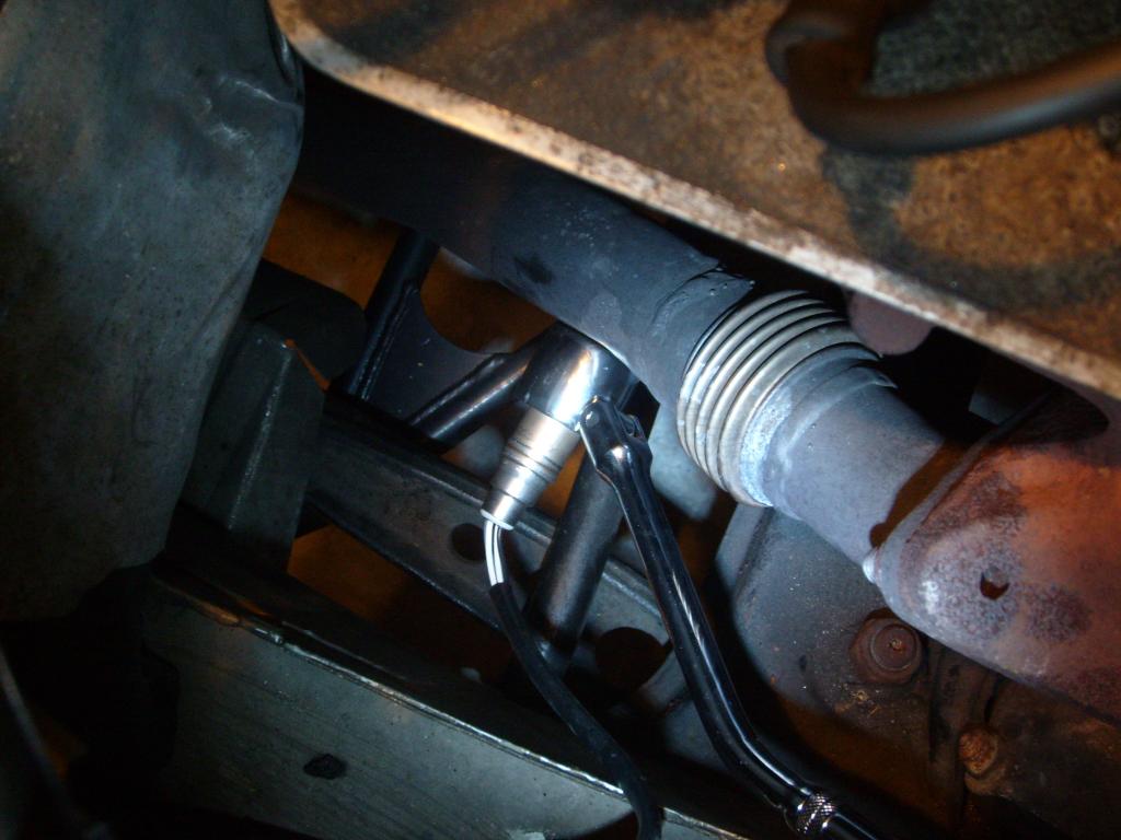

    So i was getting a wheel alignment finally at a friends shop and asked him if he could check my check engine light since the bulb was blown. It actually wasnt checked since i owned the car. I got codes:
    29- road speed signal
    28- oxygen sensor
    I dont know what the hell road speed signal means but i replaced the 02 sensor. the report receipt says 7/23
    So after trying and trying to take off the 02 sensor I finally got word that i would have to torch the threads/exhaust pipe til red and that would allow the 02 sensor to come out. I tried spraying it with liquid wrench before and after driving..it moved a bit then it got stuck HARD. The torch trick worked so now im happy.
Name:	o2 sensor wrench.jpg
    old (left), new (right) and i got the one that plugs in from blunttech. after hearing various opinions i decided i didnt want to chance faulty readings from splicing the wires
Name:	o2 sensors.jpg
    that torch was a damn good investment!
    But does anyone know what "road-speed signal" refers to?
