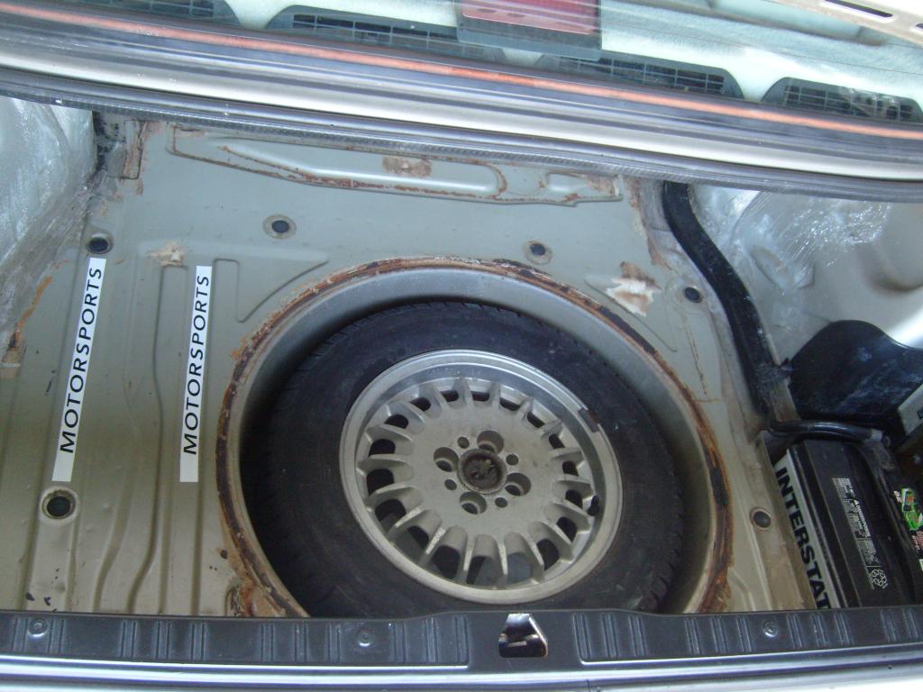

    i went ahead and removed all the sound deadening out of the trunk. All I needed was a heat gun, a couple flatheads and a six pack of flying dog!
    I then put it all in a trash bag, stepped on a scale and then dropped the bag out of my hands. That useless shit relieved my e30 of 55lbs! and that weight sits over the rear tires. That little bit does a lot it terms of inertia..at least i think so

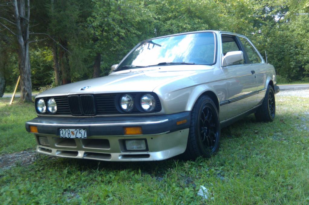

    my friends think im crazy for what i did to the front plate, but the full plate made me cringe every time i looked at the front of the car. I hated the way it covered up the air ducts on the valance. lol now it looks proper

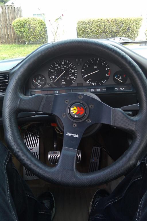

    Another cool thing; My neighbor is into cars also so were always helpin eachother out. He just got a nardi wheel in his new car so he gave me his black one for $40. I think its the same size as the grey momo but since its a competition wheel its thicker. Feels solid. and it actually matches..looks so good with the horn on the black wheel instead of the grey wheel

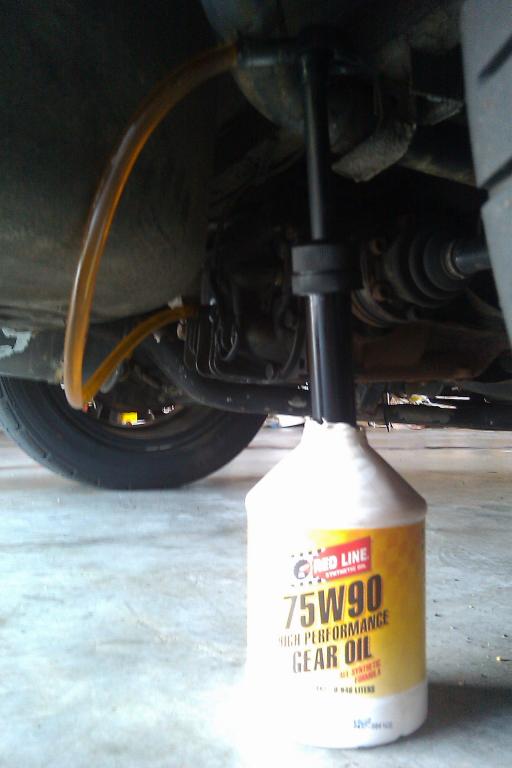

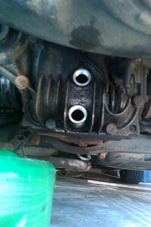

            meanwhile i did a little diff fluid change.

            Another note: my transmission gets very warm under NORMAL driving conditions. like my knob gets warm and the carpet all around there. im not sure if its just mine but im putting in redline in a coupe weeks..if that will help with temps, im skeptical..buuuut i like knowing exactly whats in my car. peace of mind goes a long way

              Make sure you add a tube of friction modifier if you have an lsd rear end.:D
              • ROLLingKING
                • Apr 2011
                • 1169
                #37
                friction modifier??
                just quickly googled this cause i never heard of it and I thought u were pullin my leg but some ppl were saying its good for lsd's
                they also stated some fluids contain that stuff already. Im not sure about redline. I got them tho cause theyre race proven though. So with that said, does redline already have its own friction modifiers or should I call redline and ask what they suggest i add?
                what happens if u dont run this stuff. im not sure if the previous owners had a clue, or is that something mechanics know to add to a s3.73 when they see one

                  does the tranny have something like this? im doing that fluid next. i feel its warmth after like 15min of driving
                    If you buy the right RedLine it comes pre mixed. Look on the back of your bottle I cant remebr but if it dosnt say anything at all tahn you got just oil. I know ford sells friction modifer for $5. THe LSD will make a whining noise when you turn corners if you dont have it in
                    As for the battery it was a simple clamp that bolted to the bottom. It clamps down the lip on the bottom of the battery. I have a carquest cheapy cause I run an oddessey battery. Though when I had a full size battery I managed to get the cheap j hook type hold downs to work by catching them under the tray.
                    As for tranny I run ATF. Yes they get warm and you have a metal knob so heat transfer. As for the floors gettign hot the factory put this thick rubber mat stuff in the tunnel after time it tends to fall off. It keep the floors from doing that.

                      friction modifier?
                      hmmm the "right" redline huh.haha
                      i threw my bottles out. ill call bavauto and find out. cause i dont need my diff goin bad on me any its MY fault. can u tell if i got the right bottle by the pic!?

                        • e46s54dr
                          • May 2008
                          • 1059
                          #42
                          It looks like you bought the bottle that already has the friction modifier in there but Id definitely double check if I were you.:p
                          • London
                            • 532
                            #43
                            Is that ok to do with a dif? I thought BMW used some weird mineral stuff in their diffs...

                              #44
                              Its just a basic differential so any gear oil will do. Bmw didnt reinvent the wheel in this case so I wouldnt see why they have a special oil for their diffs? Maybe its just a way for customers to buy more parts from them.
                                yea i cant remember what the back said so i will be calling first thing in the AM. THANKS AGAIN.
                                Its funny cause ive heard no one say anything about friction modifier in any of my e30 meets or the bigger car meets. but i know its small details like that which will determine if i can keep the car DD'able. especially when i start making it out to the track for day events. this is 3x now but thank you.lol
                                btw it took ~ 1.8 quarts to fill the differential with differential fluid
