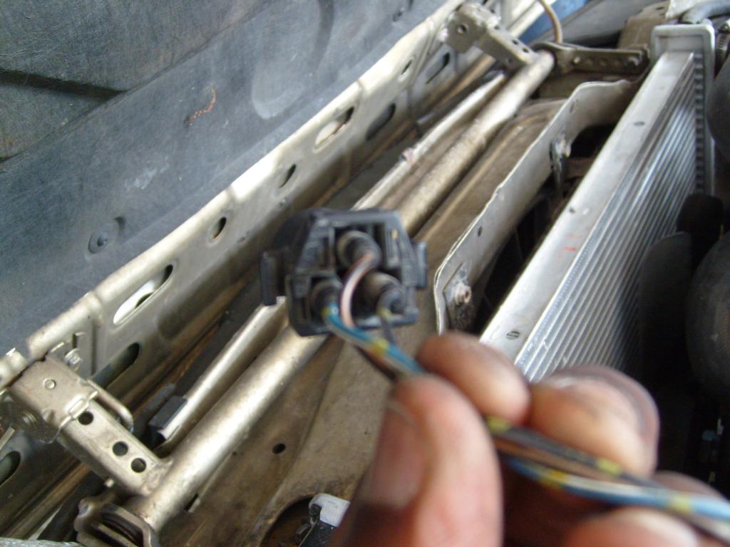

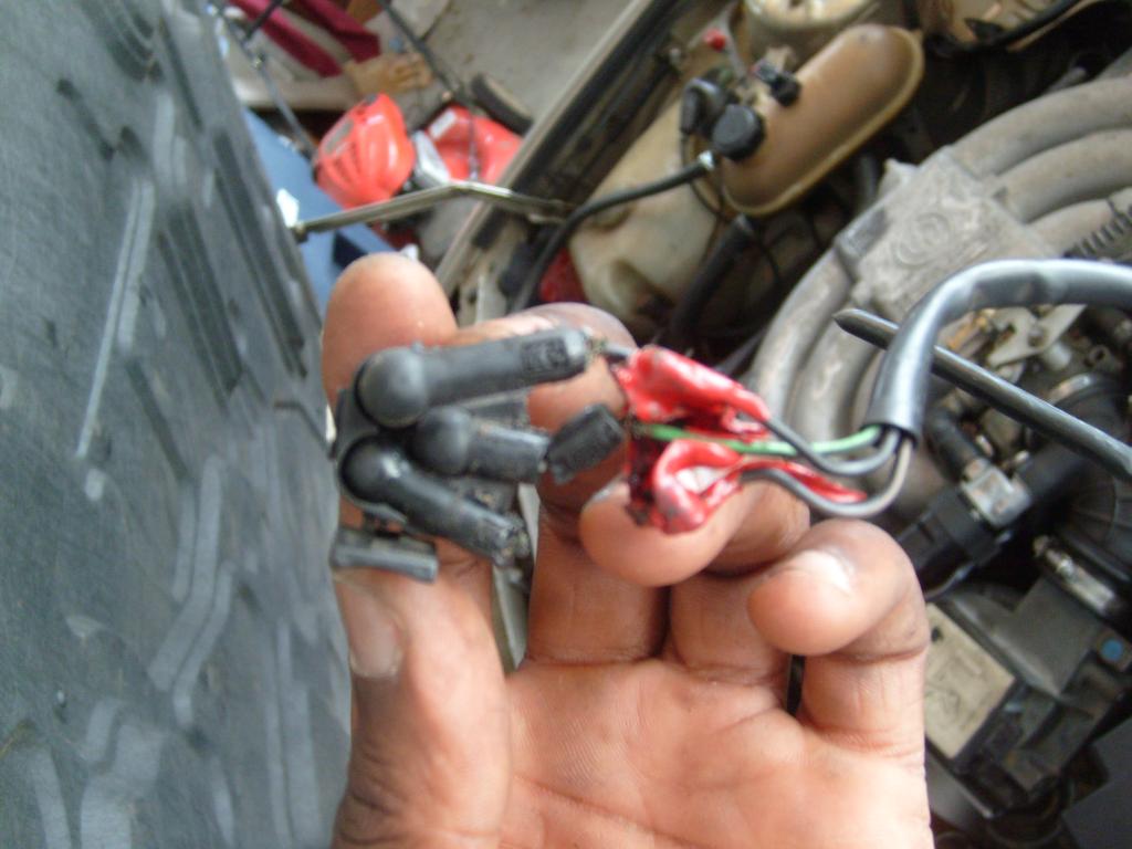

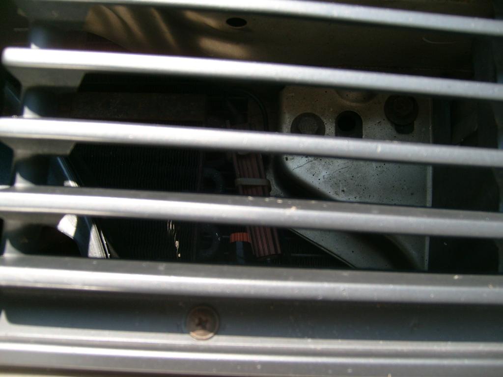

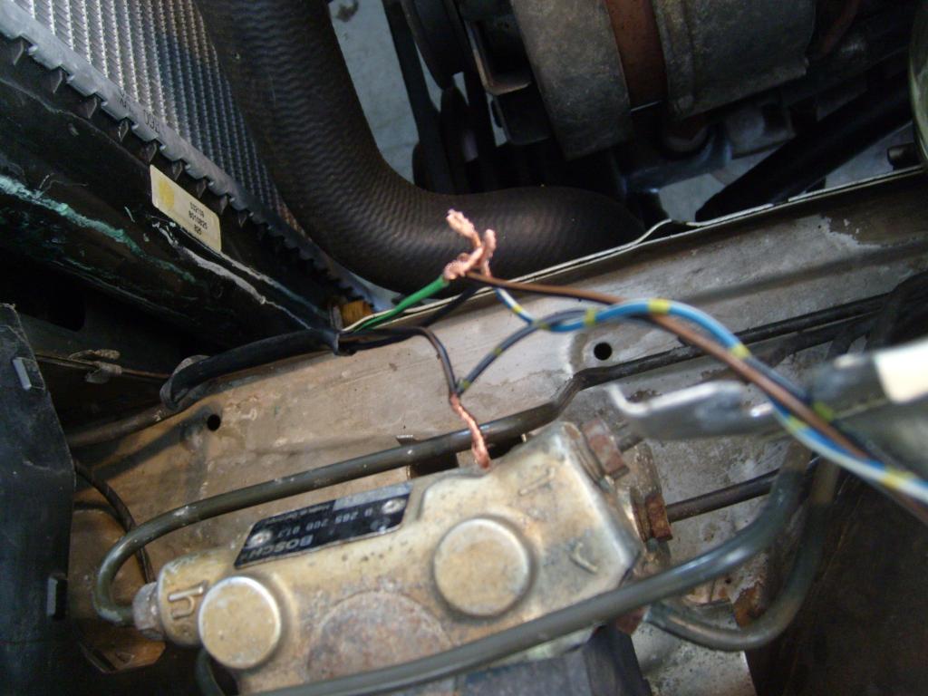

              Coolant fixes continued...kinda(im still backtracking)
              Went to the junkYard and found some gold! to me at least..im getting my aux fan working finally. the plan was to fix it so i have A/C but its sept now and im just gonna fix the fan and hold off on a/c till next year
              here was part of the problem..i found this after i unwrapped a bunch of electrical tape..thanks po! although i noticed that this was a design flaw by bmw..almost all the jy wires were in the same ripped condition in the EXACT some spot.lol
Name:	aux wires broken.jpg
              This one was golden...and had a different, better design. shouldnt tear apart again
Name:	aux new plug.jpg
              and then i was done....
Name:	aux fan wires twisted.jpg

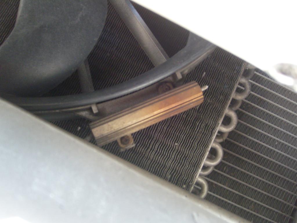

              So a few weeks ago I went ahead and ordered a resistor for my aux fan since it wouldnt turn on. I was very lazy and didnt want to take shit apart to reach it but it turns out the tiny little screws were rusted so i didnt have to mess with em. Instead I just cut the wires and relocated the new resistor...about 30min later the fan was working...
              old...Click image for larger version
Name:	aux fan resistor old.jpg
              and the new one..re located. for now it works. if anyone sees something wrong with the placement say something..if u can even see it. i didnt feel like taking the grill back off.hahaClick image for larger version
Name:	aux fan resistor new.jpg
              ....the thing is tho, now it is ALWAYS working.lol it stays on low if the car is on, just warming up, and when at operating temp. Last thing left on the list to replace would be the temp sensor that plugs into the radiator. So ill be ordering that tonight.
              Should i get the e36 one?
              keep the m20 a little cooler or should i just order the one for the m20..dont wanna throw anything to funny at it. I remember hearing someone on the fourm say the "early motronic" doesnt like different temperatures but that was in reference to the t-stat i believe.
              What do u guys think? i hope to order it tonight btw

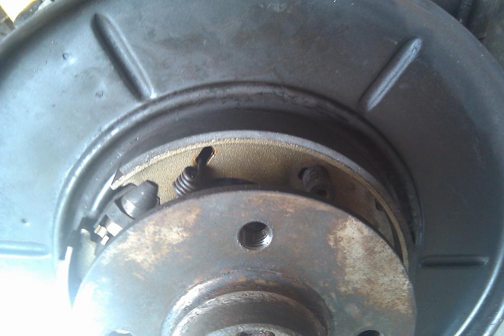

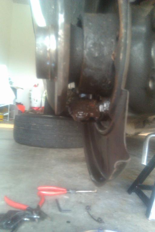

                Stiiilll catching up...E Brake Fix!

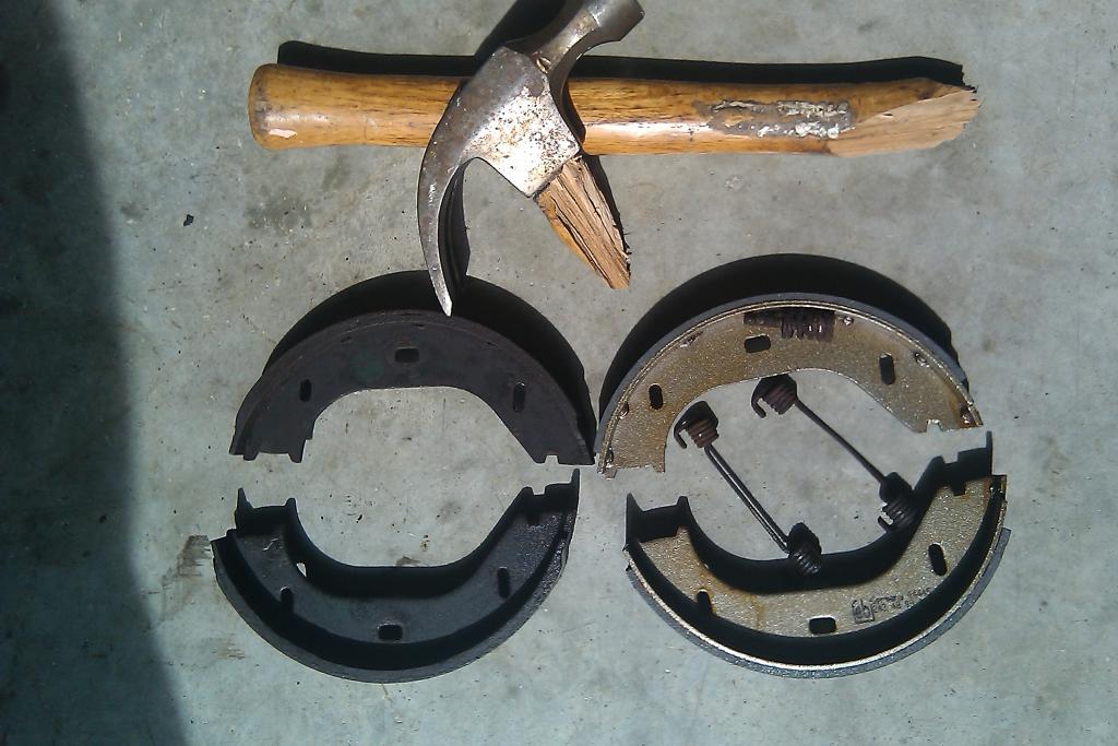

                Oh yea so when i first got the car I parked it at work which is on a slight hill, and i felt it start to roll and then the parking brake caught. It was pretty weak feeling so i left it in gear also..Since i had never dealt with parking brakes i took it to a shop down the street..asked them to adjust em and if there was a proble what was it?
                ebrakes are pretty important for what i want to do with the car. I knew the left ebrake wasnt engaging but i thought the line may have been bad. I told the mechanics & the shop said they adjusted it and said i needed new ebrake shoes! I asked how much installed and they said over $200. i laughed and asked how much for just the part and i believe it came to under $40! (mind you, this is mid june im talking about)
                So i buy it..Great..so a week later its cool enough to withstand the heat of the garage and i start installing. They kept telling me i needed a special bmw tool to release the springs but 2 needle noses worked just great!
                Right side went on great but when i got to the left i couldnt even get the damn rotor off the hub..telling me 2 things, they sure as hell didnt take it off when they "adjusted" my ebrakes and "saw nothing else wrong" and reaffirming why i dont take my car to other ppl. theyre LAZY
                after breaking a hammer i got the rotor off the left side.haha
Name:	ebrake broken hammer.jpg

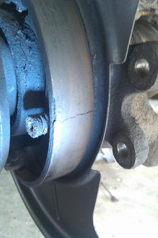

                The brake shoes had definitely seen theyre day. as soon as i pulled em off the brakes were crumbling apart a little...Click image for larger version
Name:	ebrakes cracked.jpg

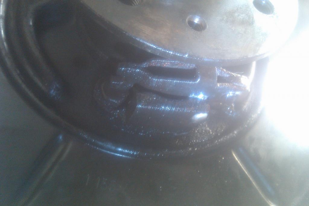

                So like i said, the right side went on fine and i slipped the rotor back on. When i finished the left side the rotor REFUSED to go on. At first I started blaming myself cause ive never done this and I thought i fucked it up...buuuuut after further investigating and understanding how the brakes work i found it. EUREKA!!!
                The hinge thingy was seized up with rust sooo bad that the left ebrake was never FULLY disengaged. causing the new ones to be spread out a little 2 much once instaled. heres pics of the piece..sry im typing so much! its the bottom piece.
Name:	ebrake broken lever.jpg
                a close up
Name:	ebrake problem piece.jpg

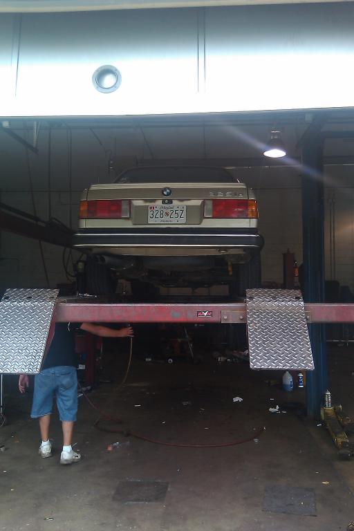

                  oh yea and then i had the rear sway tabs re welded. this time at midas. i wanted a more secure/cleaner weld
                  here she is at midas Click image for larger version
Name:	weld at midas.jpg

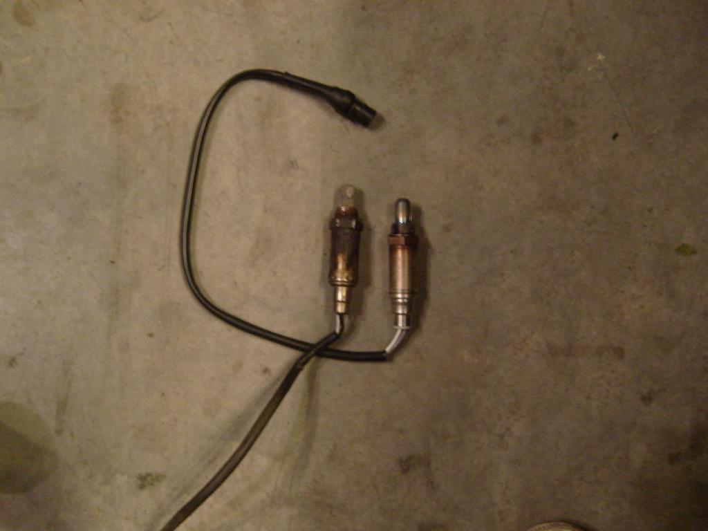

                    O2 sensor time
                    So i was getting a wheel alignment finally at a friends shop and asked him if he could check my check engine light since the bulb was blown. It actually wasnt checked since i owned the car. I got codes:
                    29- road speed signal
                    28- oxygen sensor

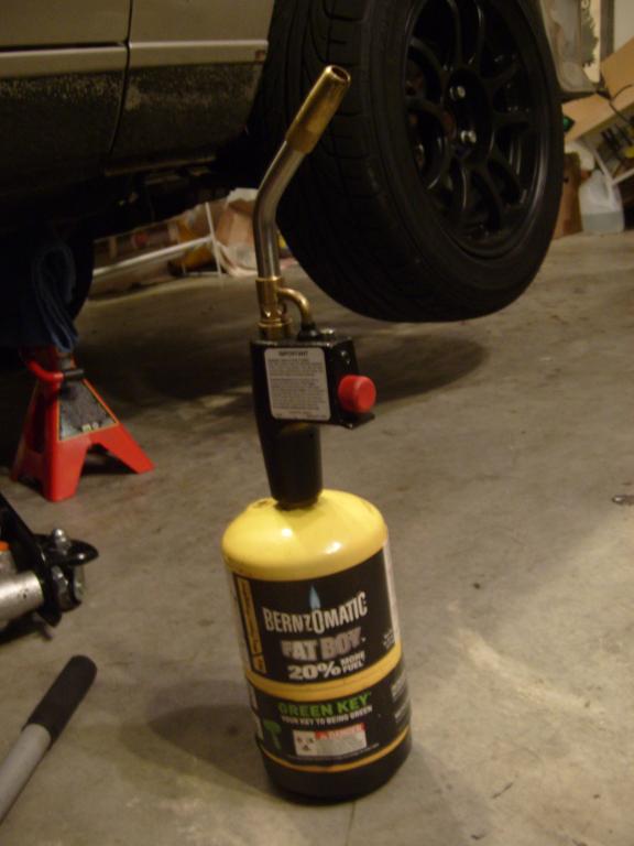

                    I dont know what the hell road speed signal means but i replaced the 02 sensor. the report receipt says 7/23
                    So after trying and trying to take off the 02 sensor I finally got word that i would have to torch the threads/exhaust pipe til red and that would allow the 02 sensor to come out. I tried spraying it with liquid wrench before and after driving..it moved a bit then it got stuck HARD. The torch trick worked so now im happy.
Name:	o2 sensor wrench.jpg
                    old (left), new (right) and i got the one that plugs in from blunttech. after hearing various opinions i decided i didnt want to chance faulty readings from splicing the wires
Name:	o2 sensors.jpg
                    that torch was a damn good investment!

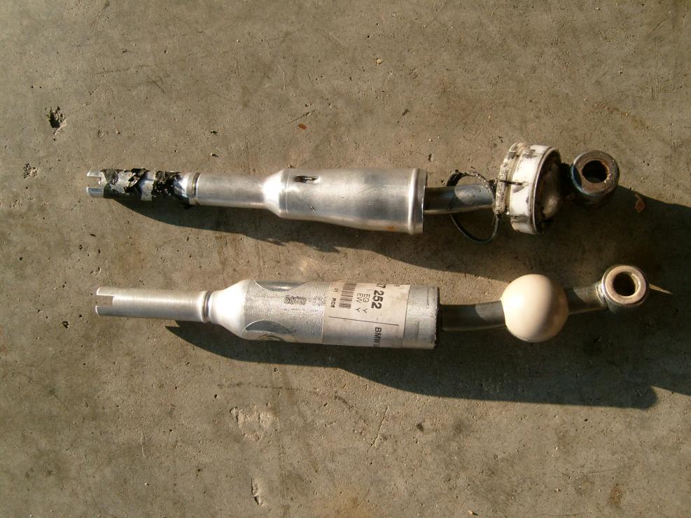

                      FCP Groton Z3 Short Shift Kit..kinda a kit
                      Its funny, the short shift kit was the first thing i ordered when I got the car in april. Ive always wanted to install one in my own car since its what you use the most. And i HHHAAAAATTTEEE how long the stock throw it..im tall so my seat is back a bit. (zero room for anyone to sit behind me) And because of my long legs it made throwing into 5th difficult sometimes. Id have to lean forward so finally i moved my seat up.
                      Until last night...I finally installed that bitch
                      At first i tried it by myself and the bitch clip wouldnt come off..that was the story for the next 2 attempts with 2 different ppl. Yesterday I finally figured it out buut stil had soo many problems. Everyone kept telling me to wait until i did my clutch and dropped the tranny, but i dont listen. I also dont need a clutch. I plan on clutch kicking this one to its grave..and as i upgrade power ill upgrade the clutch & flywheel.
                      Well making a long story short i ended up with extra parts. I have a shield around my flex guibo that made things very difficult...anyone know a way around this thing?
Name:	guibo shield.jpg
                      since that was in the way i couldnt change the piece held in by a pin..this guy
Name:	shifter extra piece1.jpg

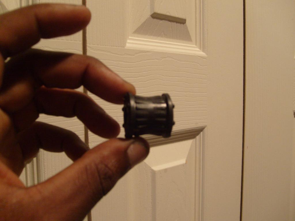

                      The other extra piece is the rubber bushing where the bitch clip is..that medal rod seen here (below) has a bushing in it but the one sent to me is an OVAL shape..a 12ton press my neighbor had wouldnt get it to go in. there must be another special tool that compresses this bitch while pushing it in...idk
                      oval bushing
Name:	shifter extra piece2.1.jpg
                      BUT i am extremely happy with my new reduced throw. soo much better...and not notchy like some ssk's. i actually didnt like the uuc when i felt it at a car meet

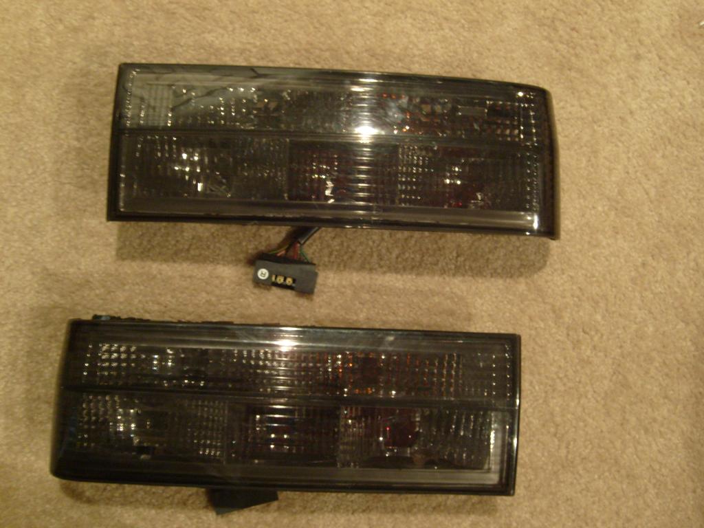

                        parts 4 sale
                        oh im selling these headers..they were never installed
                        $150
Name:	4 sale 1.jpg
                        and these tinted tails. i got pulled over for em. in MD your not supposed to have tinted tails. at 4pm theyre a problem i guess. stupid.
                        $100..there are previous pics of em installed. i loved em. i just dont need extra fed attention
Name:	4 sale 2.jpg
                        SOLD

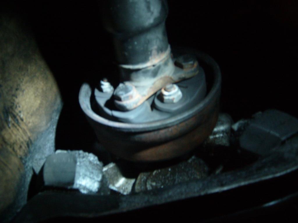

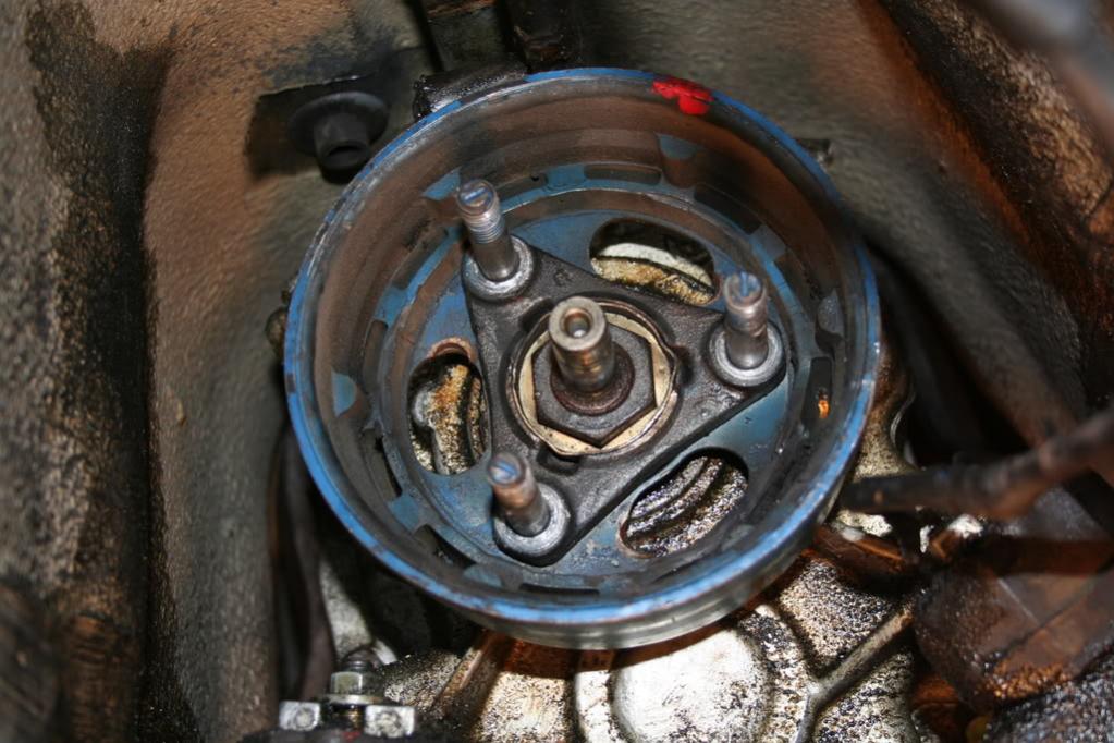

                              Guibo problems!! Heeelp!
                              So theres 3 bolts facing me and 3 nuts facing me.
                              the bolts attach the guibo to the driveshaft..then once the guibo and shaft are bolted together...they slide into the shield & bolt to the tranny by the nuts facing me. thats correct right??
                              from my research and a very timely thread under the driveline section of the forum ive figured it out. I think
                              also got this pic form the thread..
Name:	guibo shield empty.jpg
                              While trying to install the SSK i thought I could pop out the driveshaft to install a bushing..I started loosening THE BOLTS (above pic) but as soon as I broke em all free realized there was a nut behind the shield between the tranny. I couldnt get to those so i drove the car.
                              Now a bolt is missing. :crazy:
                              Im guessing if i torque wrench the nuts i can pull the driveshaft out. Is it that simple?
                              If so how do I hold the bolts behind it from rotating and putting myself in the same predicament??
                              Any help is GREATLY appreciate! thanks
