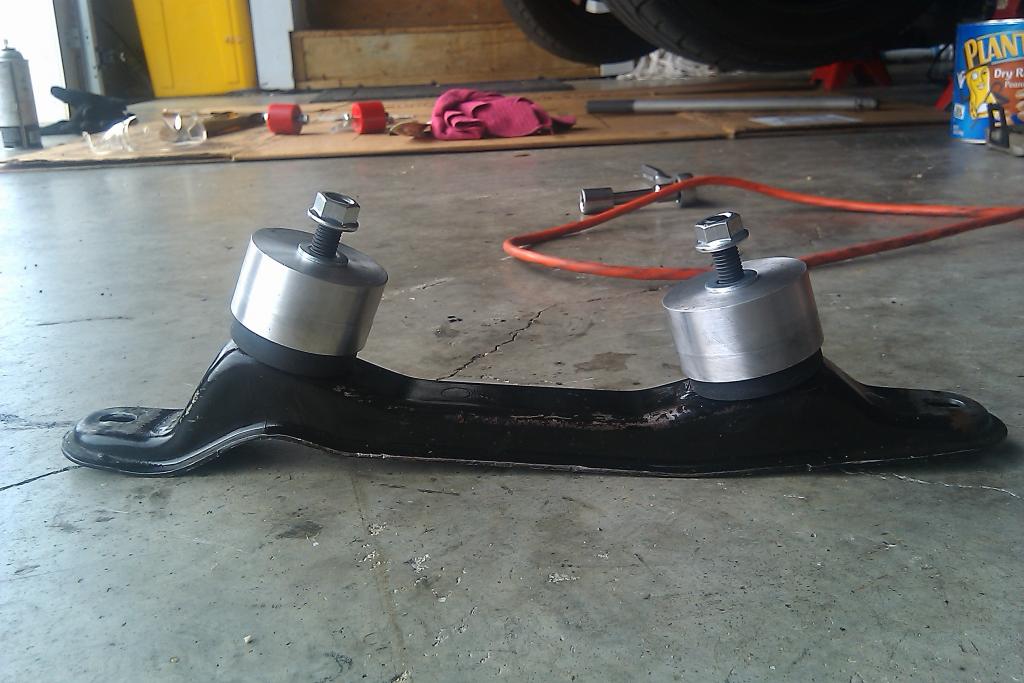

          E21 transmission Mounts are kinda meant for E30's.lol
          I almost have the tranny mounts fitting. im drilling out the last bit of the transmission then i should be good!
Name:	akg:e21 mounts.jpg
          I had to drill out the bracket holes also. The e30 mounts are 8mm bolt threads. The thicker e21's are 10mm big. All holes and slots were to small. I didnt know this until everything was pulled apart. so that was a nice surprise. Then no stores had 10mm drill bits. They kept saying its a weird size. A 7/16 bit worked tho.

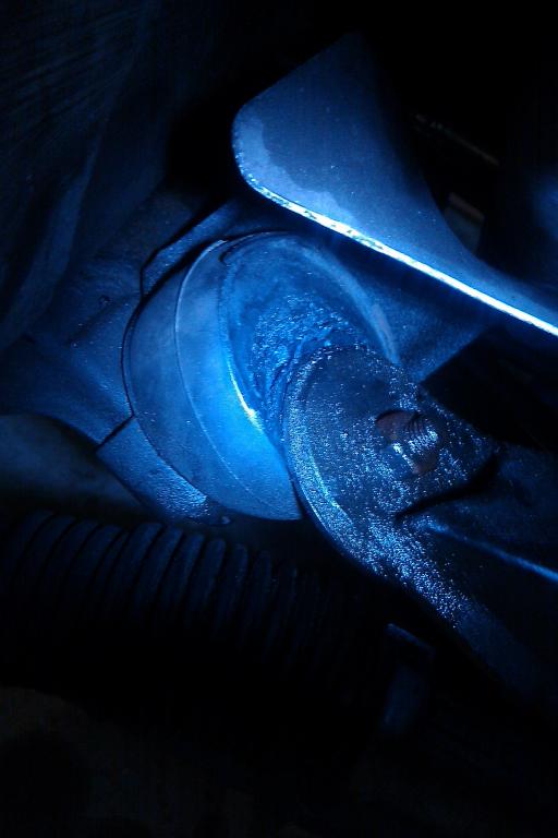

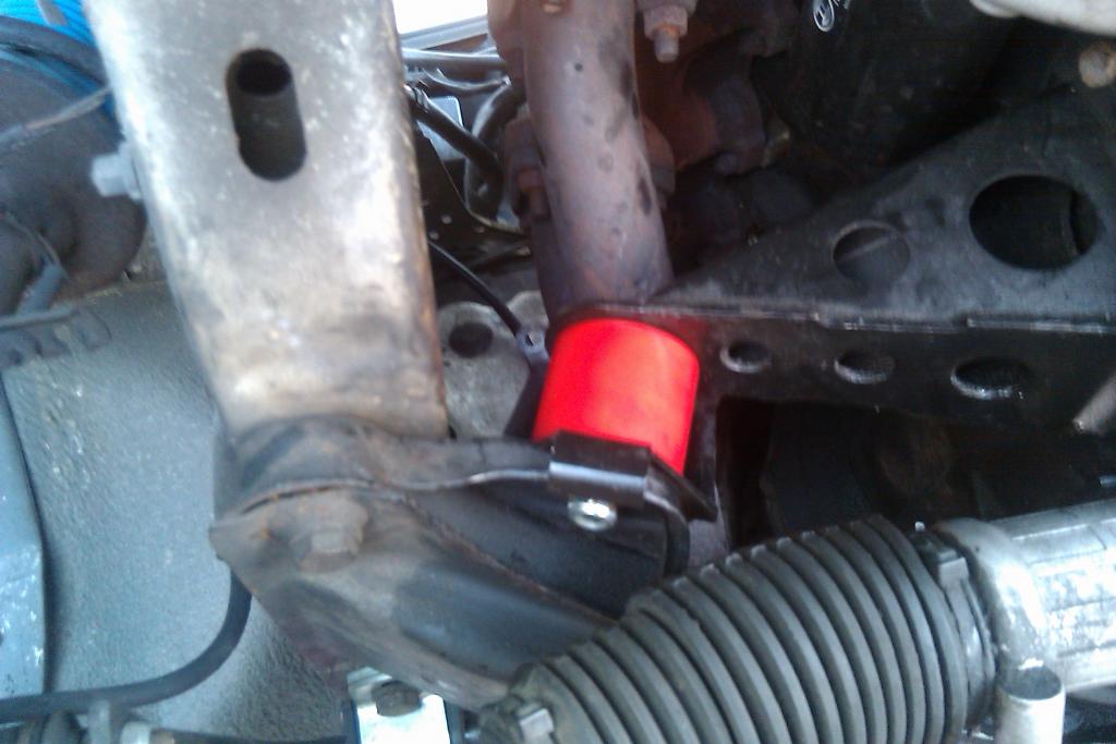

Name:	motor mount off DR side.jpg
Name:	motor mount off pass  side.jpg

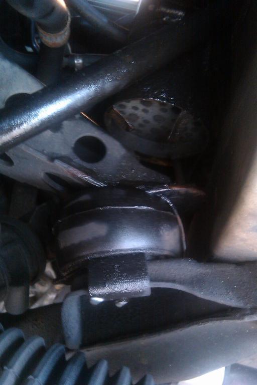

                old tranny mount pics
Name:	tranny mounts old.jpg
Name:	tranny mount closeup.jpg
                I can not wait until things are lined up right.
                If these two very important items have been over looked by the PO Im very curious as to what ill find in the motor.
                Now im thinking i shouldnt hold off on the control arms or differential bushing.
                At least the car will be better than it was before. thats about the only +

                  AKG 75D motor mounts & E21 Tranny mounts w/ alum cups DONE
                  Today was almost a 100% productive day.
                  goals were:
                  - remove old motor mounts and install the akg's
                  - Install tranny mounts once motor was lined up and not pushed all the way to the driver side
                  - Install the bolt that connects driveshaft to guibo

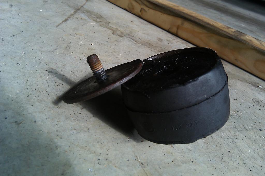

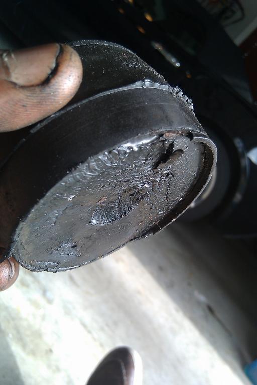

                  I was able to get the old motor mounts out!!
Name:	motor mount old split.jpg
Name:	motor mount sliced.jpg
                  This took lifting the motor up with wood and a jackstand at the oil pan. Then i had to go to the drivers side and use a 2x4 to pry/push at the oil pan from the top of the engine bay using a long wooden stick, pushing the motor to the passenger side. (above pics show how much i had to move the motor to the passenger side) After a shit ton of prying i still had to push the motor backwards for the AKG bolt to fall through on the passenger side. For some reason it lined up, we could see the bolt head from the bottom, but the bolt just wouldnt fall through! This finally worked by lifting the motor a little more with the jack stand, prying the motor to the passenger side..and voila, the bolt fell through. Some how lifting the motor more pushed the motor back enough for the bolt to come through. The driver side lined up easily once the pass side was flush.

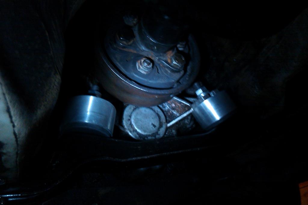

                      Contd pics (E21 transmission mount)
                      Once the motor was in line and mounted STRAIGHT the transmission bolted up like butter. Yesterday i spent some time drilling out the transmission brace and tranny from 8mm to 10 so that part was easy once i got help with the motor mounts. I lined up the ranny brace bolts to the chassis ones, jacked up the tranny, tightened that up and was then tightened up the motor mounts really good. done with those
                      not the best pic but u can see whats goin on
Name:	tranny e21 mounted.jpg
                      Now the guibo bolt...i cant figure out how to tighten it enough. I have the nut on there and used some makeshift tool to tighten it a bit. but i cant torque it. EVERYONE i ask keeps saying use an open ended wrench. with that balancer/shield/p.o.s. guibo cover i cant get to the nut with any wrench. Period. It cant be possible with that damn shield there.
                      IF IT IS SOMEONE PLEASE SHARE THE TRICK.lol please tho. for real
