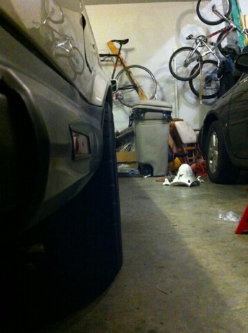

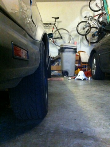

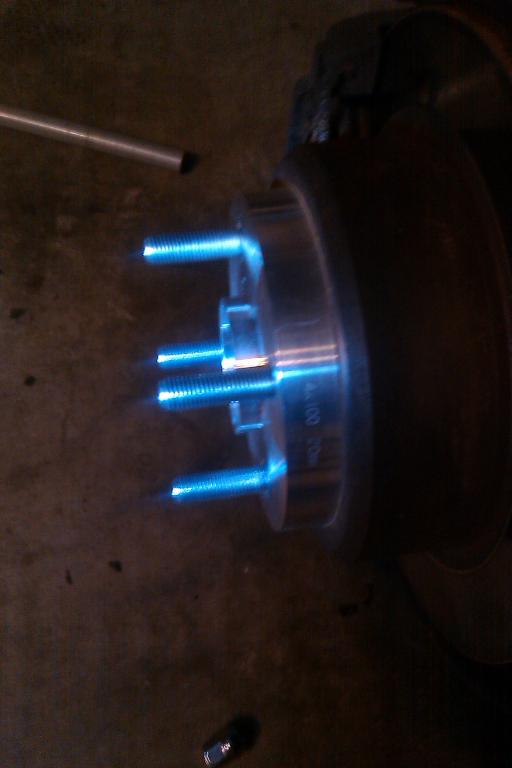

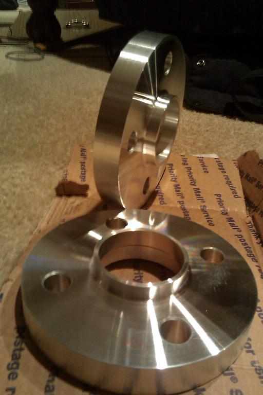

              Rear Wheel Spacers
              So I got my lug bolts in the mail friday when i got home. It worked out nice cause my spacers had already arrived. Me and a friend jacked up the car and got to installing the 80mm rear lug studs asap. Used the double nut technique to tighten em in the hub good-n-tight. Its a straight forward install that only took 30min. I ordered the wheel spacers from a forum member AND the lug stud adapters from another forum member. Thanks kaliboy and ejnight!
              20mm 4x100 hub-centric quality pieces. I cant wait to order 10mm's for the front. ejnight just has to make em. and those are also hub-centric
              Blue loctited and tightened down. spacer looks like it will push things out nicely

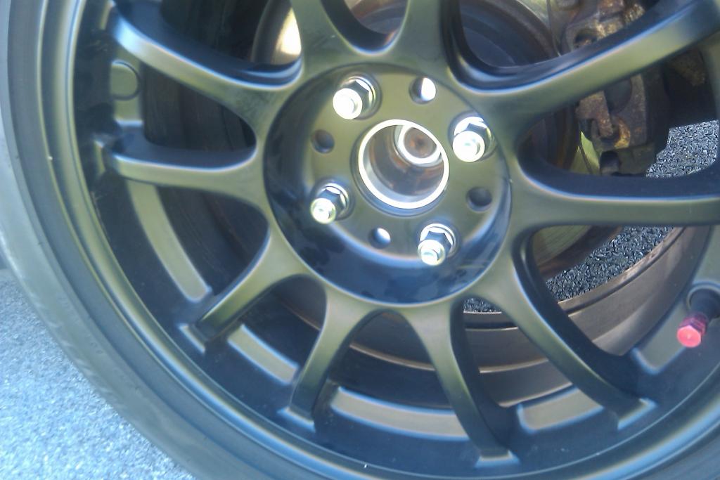

              before

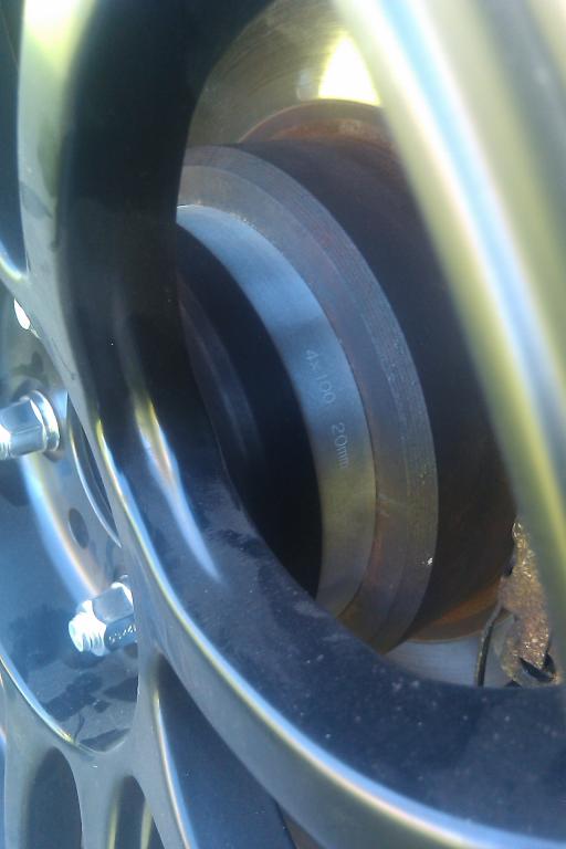

              After

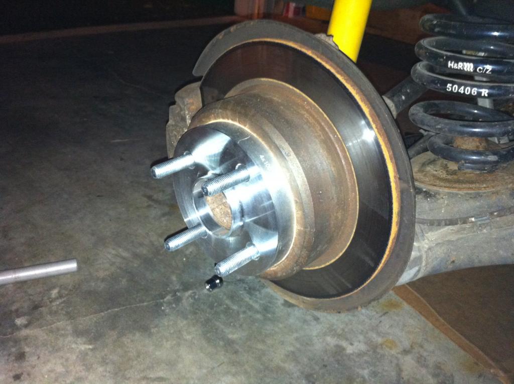

                Rear Wheel Spacers contd.....
                And the rest of the pics
                overall im happy with the products..good quality and good prices. $70 for both spacers and $54 for lug studs. I got 80mm studs in the back and 57mm's for the front. Ill repost stance pics once I have coil overs, front spacers and rolled fenders. right now tho it makes my TRM 15x7's on hr sports sit more proper!

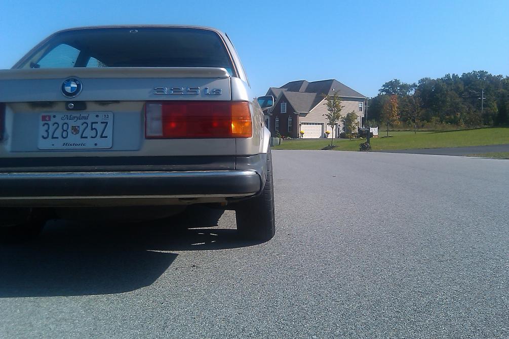

                  I like the flush fit of the wheels but the inner gap from how narrow the wheels are makes it look funny. I vote for wider wheels to be honest, 16x8 of sorts.
                  Over all you are doing a swell job =)
                  Instagram: @BWeissLeather
                  Current cars:
                  ~ '87 325 M30B35 swap
                  ~ '87 535
                  ~ 01 540 Msport 6spd
                  ~ '06 X5 4.8is
                    #99
                    I know right. I need it more wide. I have bulky tires but not wide rims. so i think your right, I need some 16x8 or 9's if those are out there. I havnt even looked yet tho. I would definitely prefer 16x8 for better performance, stance, and less fender gap but these came with the car so im going to rock em till they break. plus theyre only 13lbs. i wish they came with the 15x8 TRM's so i could at least have something more valuable to sell. no one really wants 15x7's lol
                    Thanks for stoppin by the build thread and commenting. I may have some pics soon. my friend is trying to do a little photo shoot of our cars.haha

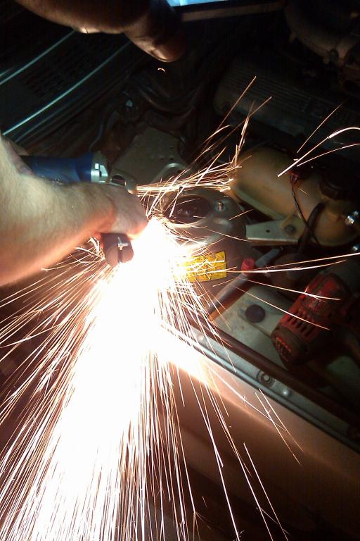

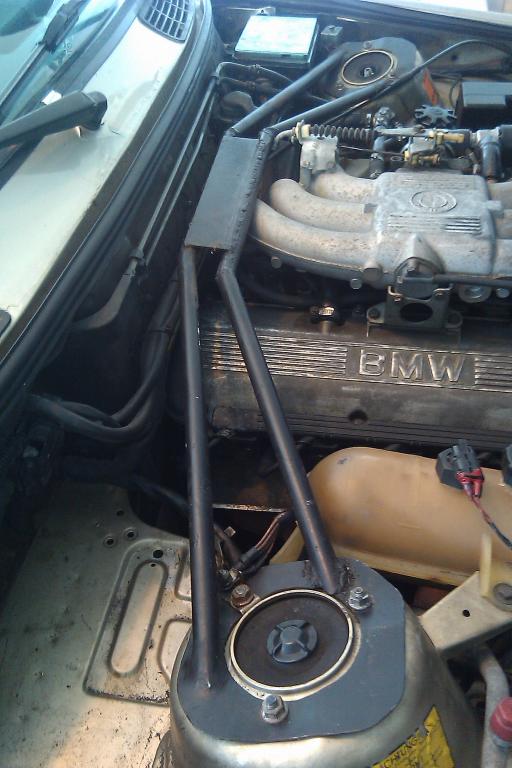

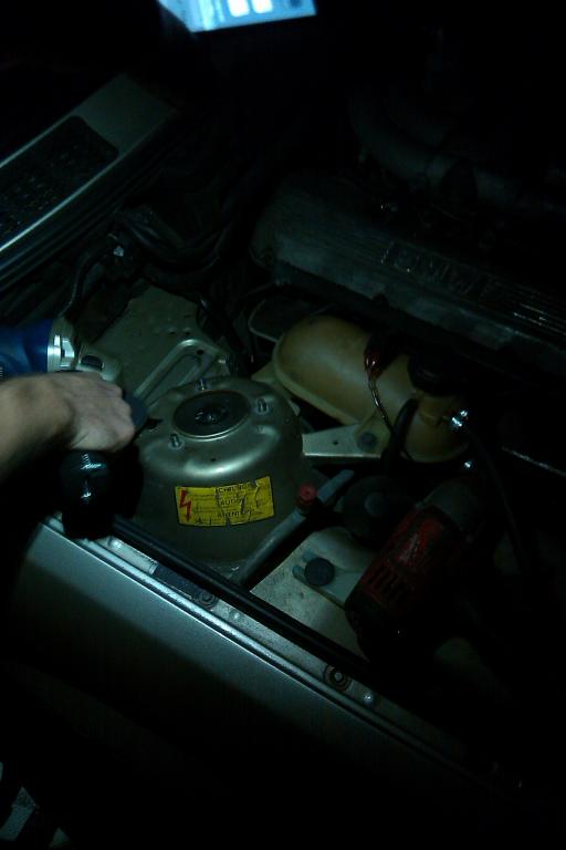

                            Free (somewhat questionable) Strut Brace
                            So I got rid of the cross brace I had. Im still waiting to get paid to ship this damn thing off. I didnt like how much flex I could feel in the front tho without it. I liked the cross brace for backroads, but it made staying sideways and switchbacks really wild and twitchy. So i drove to a guys house I met through the Colege Park, starbucks meets and he had a free strut brace. It was home made by someone, and looked sketchy. We installed it around 7pm anyway.
                            When going to put it on we noticed there were 4 studs on the passenger side. So we got out Kershaws angle grinder, my first time using one of these GREAT tools and cut it all down.
                            Here you can see whats left of some silly ground someone welded to the top of the strut. I have no clue why it was there.
Name:	notch in the way.jpg
                            and here is the bar this morning. Its kind of a sketchy front strut bar but I took this one turn on the way home. Its a long sweeping 80mph turn. I can usually punch it at the apex and be going 95-100 by the exit. Now most people say you can not feel a difference. But the car felt solid, solid enough up front I felt like wiggling the wheel midway through the turn and not only did the car not LEAN and WOBBLE as much, when i wiggled there wasnt as much of a delay from swaying of the front.
                            I also took a U turn at a spot I usually do for a little 2nd gear drift u turn and with the strut brace the front didnt flex and lean as much, which translated in the back end skidding out sooner. It took me by surprise so i quickly counter steered and smiled. I hear ppl say these things are placebo but I noticed immediate changes by taking the same turns and feeling differences in how the car reacted. Is that Placebo?? I was more surprised that I didnt even have to clutch kick at the u turn to get the back to snap around the median. It just did it when i flicked the back and hit the gas hard enough!
Name:	strut bar for free.jpg
                            This is my first strut bracing on any car so Im happy with it. Cant wait till the rear bar gets in. And I will be buying the IE bar as soon as I can. This one doesnt look to great and i just saw it touches the top of the motor. Barely but it touches. It also has a flimsy base. The base on both sides is curved up where the bolts arent, which tells me this thing flexes considerably where it shouldnt. But hey! it was free and will be temporary. Thanks Kershaw for helping out! When I am done with it I will pass the bar onto someone else free of charge!
