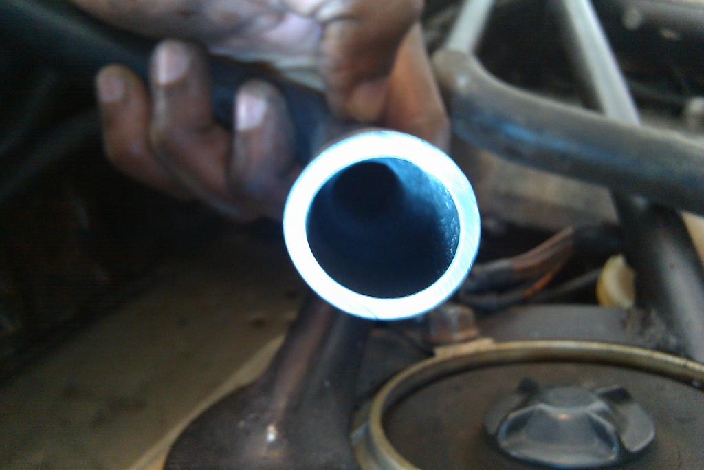

            In the meanwhile though, ive had a few small things ive wanted to do. So i felt like replacing the crank case ventilation hose. The one on the car is hard, crusty and had some signs of leaking. I got a nice new hose and looked inside the both. the old one was groossss

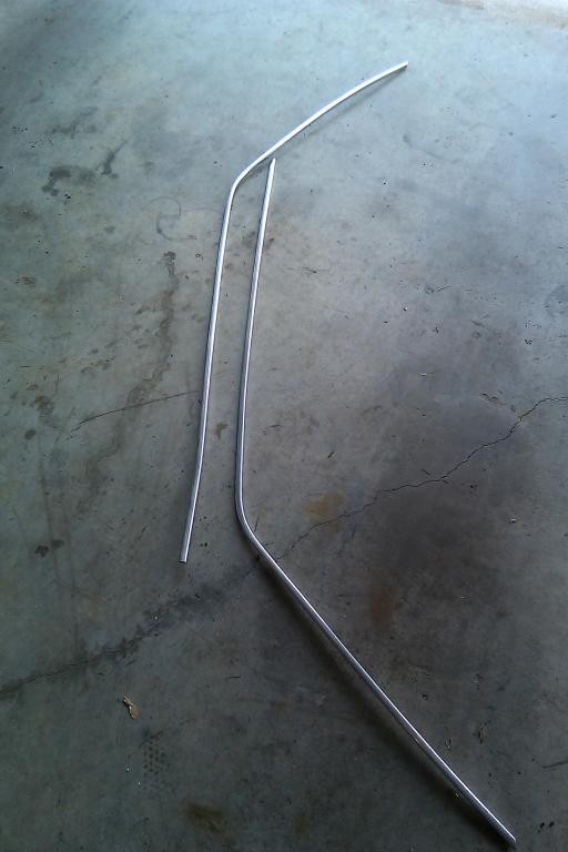

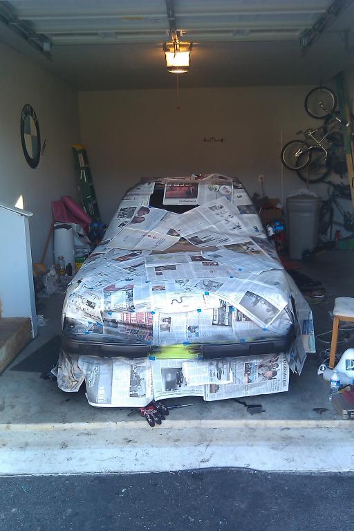

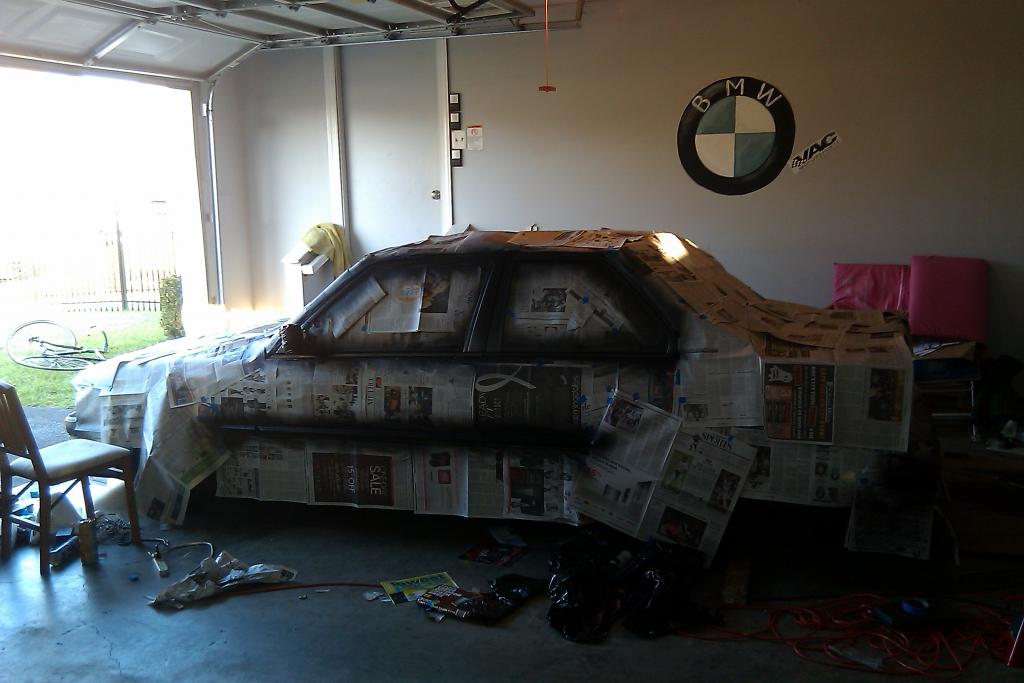

            I also started a project my car desperately needed done. Getting rid of the chrome trim. It took a while but i finished it after about a week of lazily doing it.

Name:	chrome trim off.jpg
Name:	chrome trim on:off.jpg

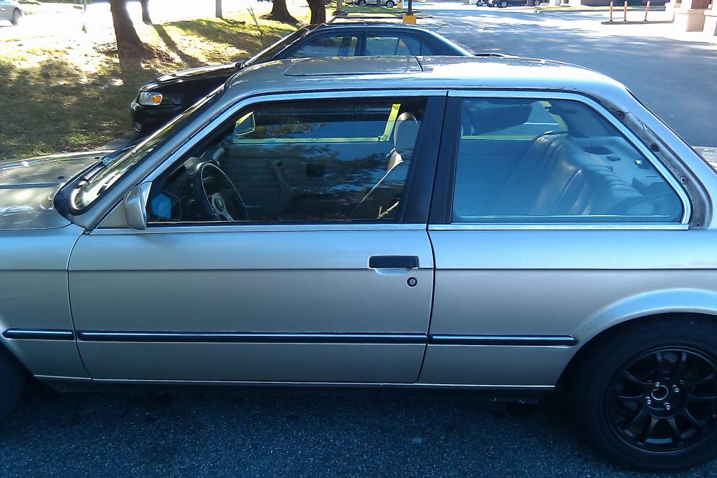

              And the trim finally painted

                Soo much better, I did the shadowline as well, what did you use to do it?

                  hahaha because newspapercar

                      damn i kinda wanna do this now... yeah what paint did you use??

                        but the paint was duplicolor flat black trim paint. I read can after can of paint in auto zone and went with that. I also used 100 sand paper to get rid of the chrome. and so the paint had something to stick to. i messed up in a spot on the roof but was able to use gas & a rag to rub off all overspray. there were a few spots on the car that got hit with overspray but thank god for the gas takin it off
