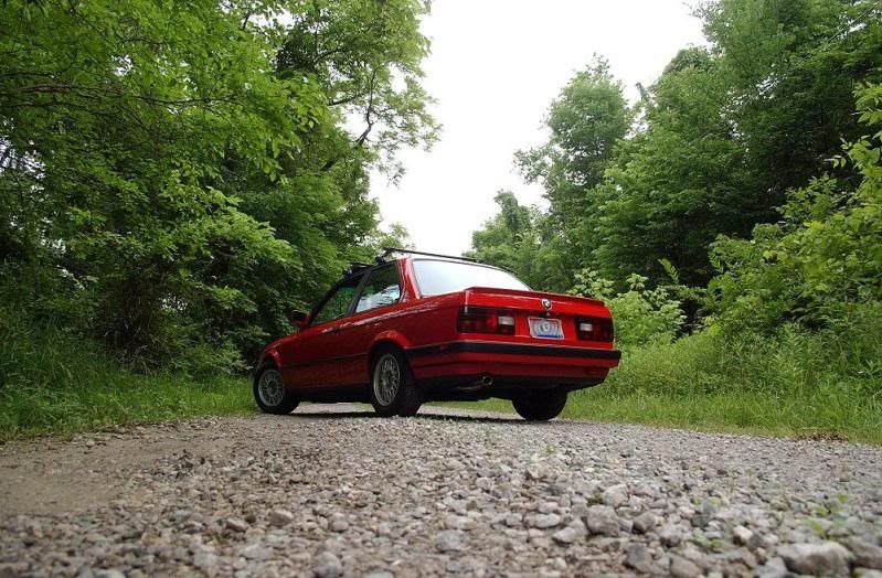

    Here's some "finished" current shots I took the other day with my DSLR.
    I’m no professional photographer so don’t be to harsh
    That’s all for now. Thanks for looking

                      Wow. Those fogs turned out beautifully. The paint really turned around too. Nice work!
                      I kinda like the black hood lol

                          God damn, I am very impressed with your cleanup work on this car. You made it look great.

                            You cleaned the SH!T out of this car! I love how well single stage paint turns out after a good scrubbing- you did a fine job.
