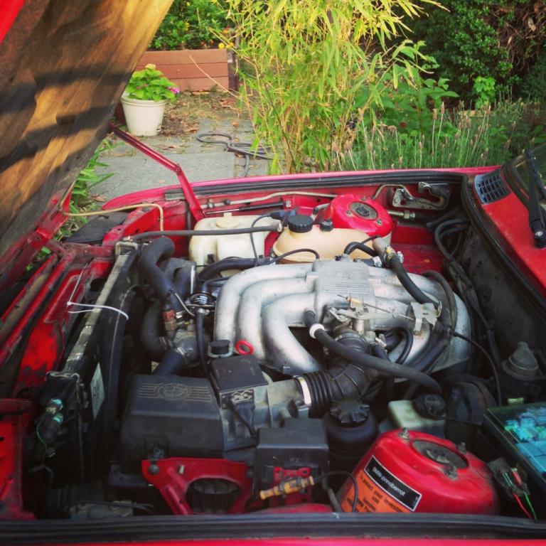

                #397
                All back together as of this evening. :)

                  #398
                  It runs?

                          #402
                          Originally posted by 2blue240
                          It runs?
                          not quite...... i drove it around and i have another leak. im assuing from the thermostat housing gasket as i did not RTV that either, and my water pump was dry on the bottom sealing area.
                          i was too pissed to look into it further yesterday, ill probably fix that in a week, too broke do stuff.
