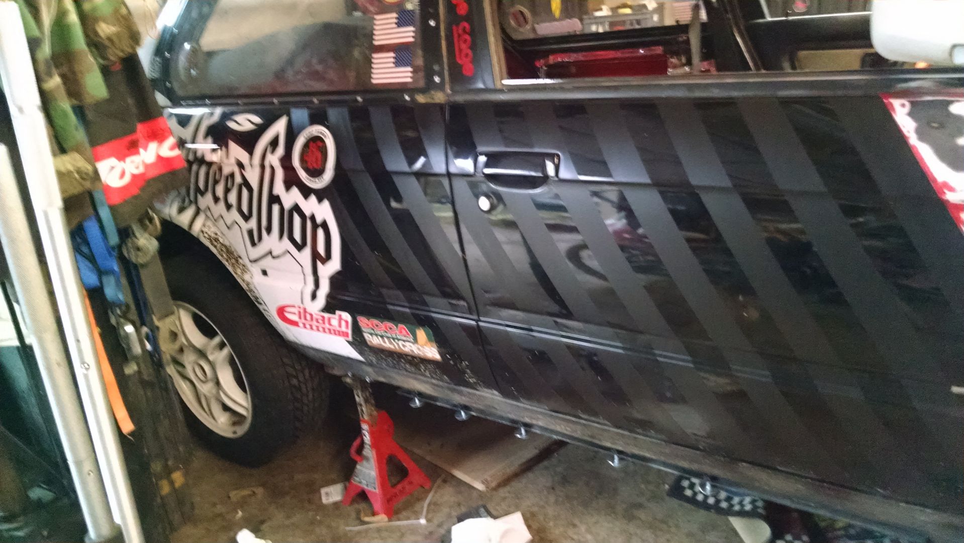

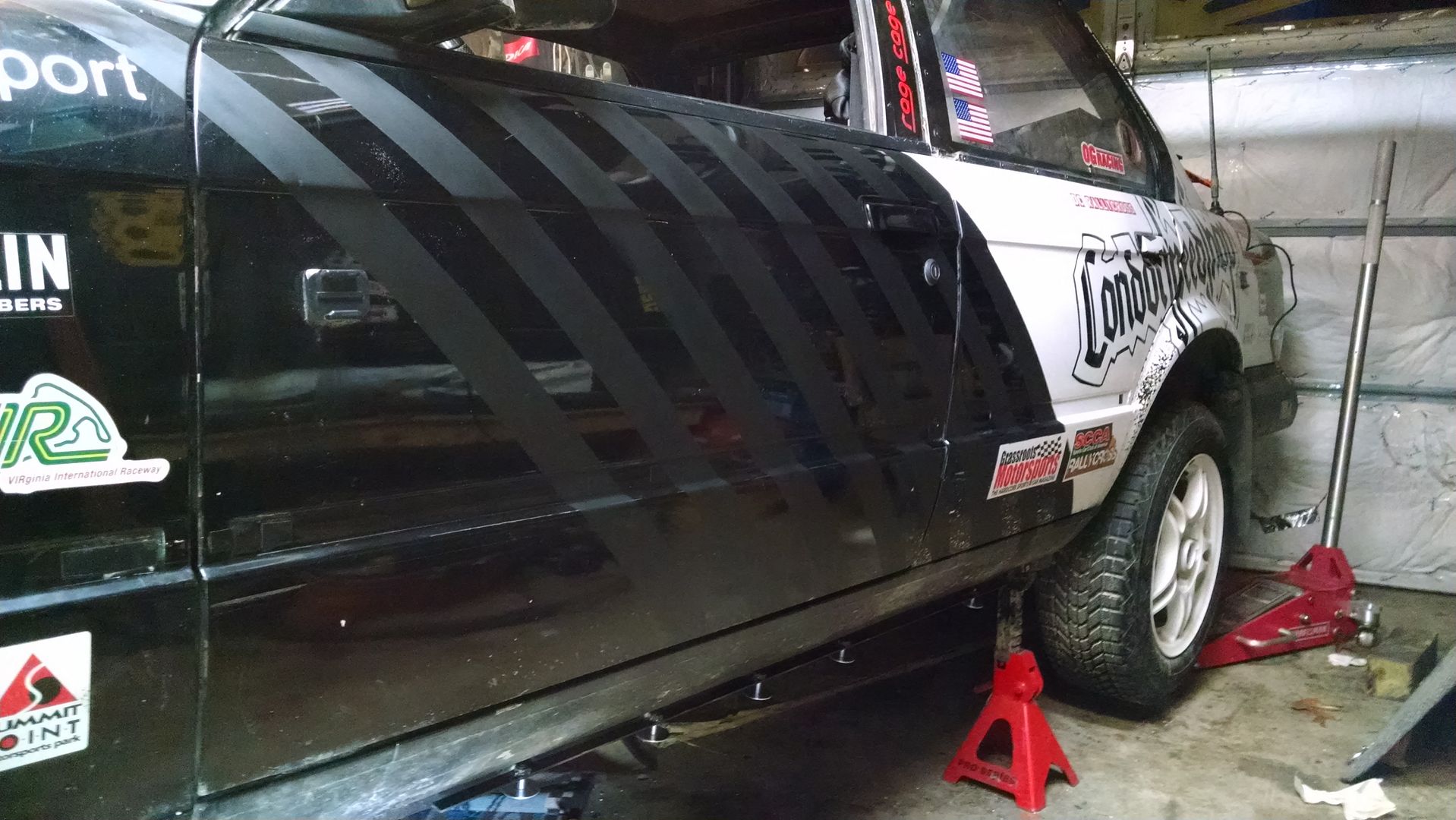

      So got the driver's side sill done, so cross one thing off the list. And yes, those are a few rivets used to located the piece while I welded it.

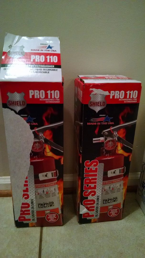

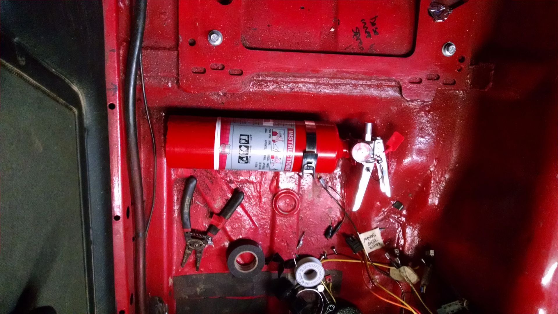

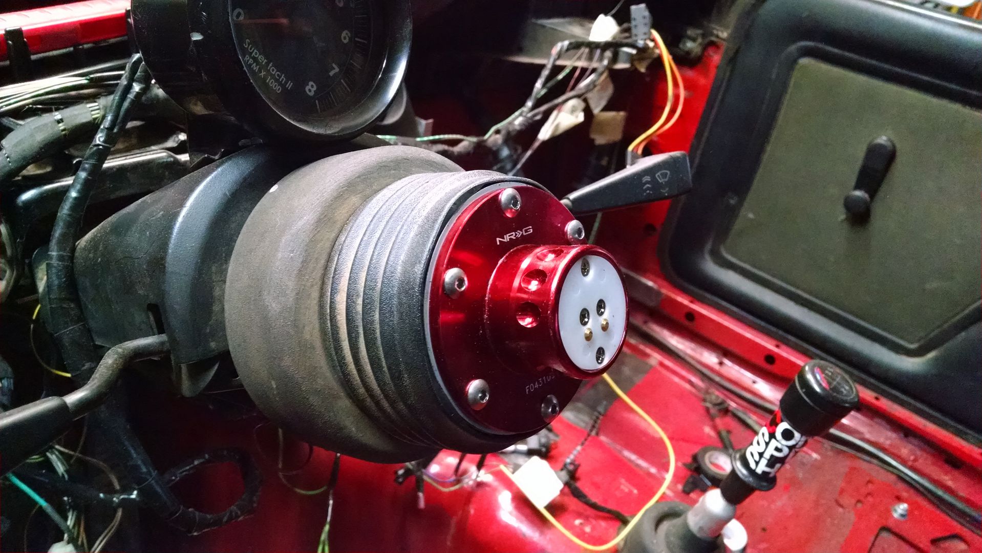

                                For Christmas, got various tools from my wife and family, and a few things for the car. My dad got me two fire extinguishers with heavy-duty metal mounts (required for Rally America), so will need to figure out where/how to best mount them.

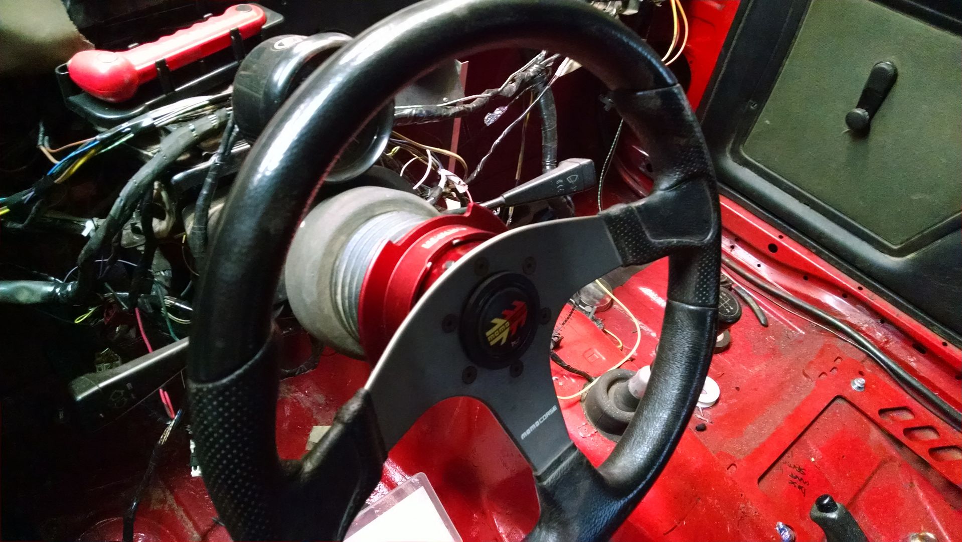

                                The in-laws got me an NRG quick-release for the steering wheel. It's really nice quality and I'm quite impressed with it. I knew that adding it to my momo hub would push the wheel out closer to the driver, but figured it would be ok with the seat back farther. Upon test-fit, though, I think not. To put the seat far enough back to make the wheel in a comfortable position, I do not have the good pedal control/touch that I like. So I just ordered up the NRG "short hub," which will bring it back close to the previous depth.
                                Also, previously we drilled out the security bolts on the steering column, and I put in some 3/4" spacers there to space the column more horizontal than the stock "school bus" angle. I did it as far as I could go without the u-joint binding or clicking....in the future I may clearance the joint to allow me a bit more drop on the wheel, but this should be fine for now.

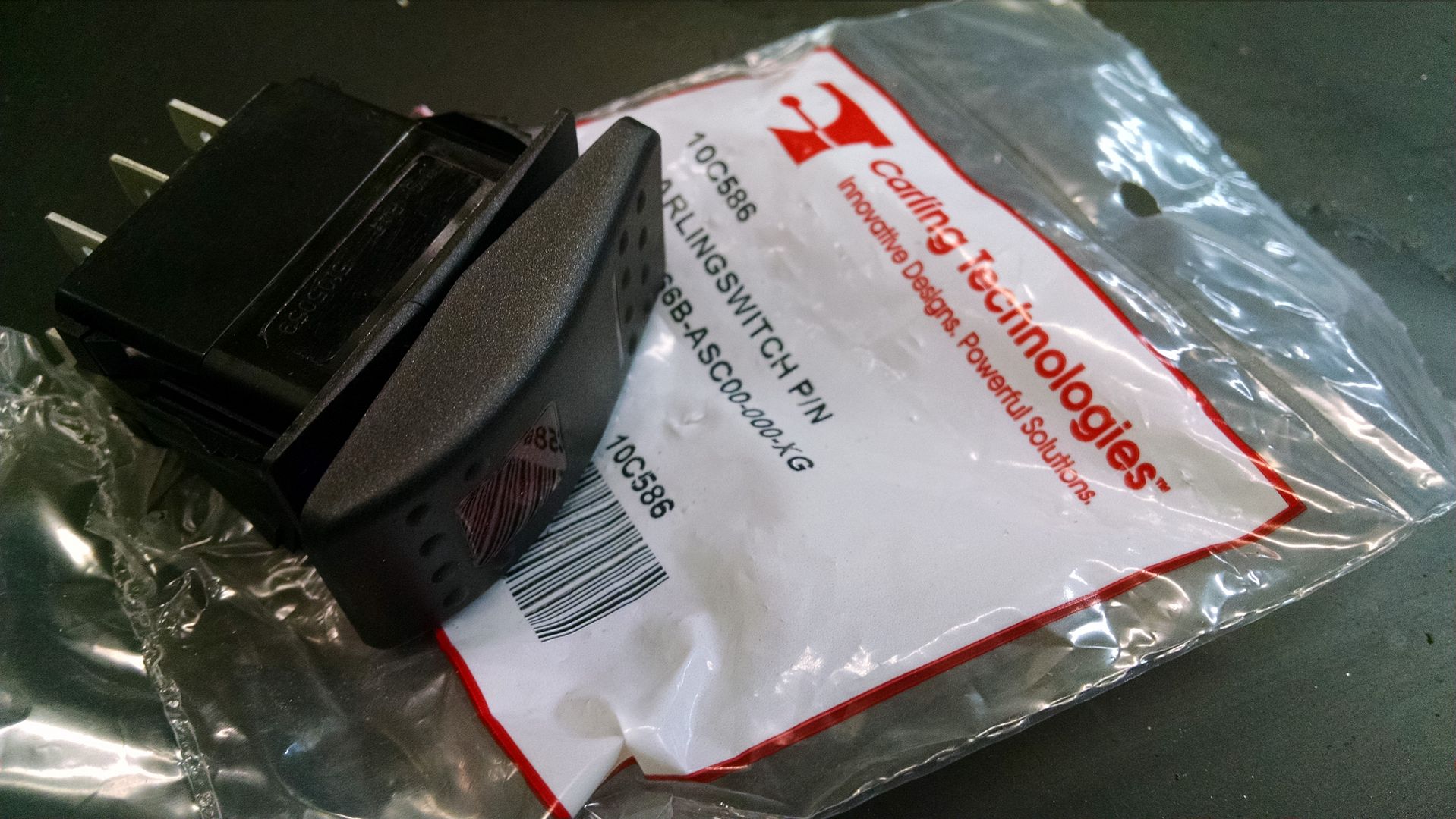

                                Also got my DPDT switch for the dual-circuit on the LED/floodlights. More on that later when it's installed and wired.

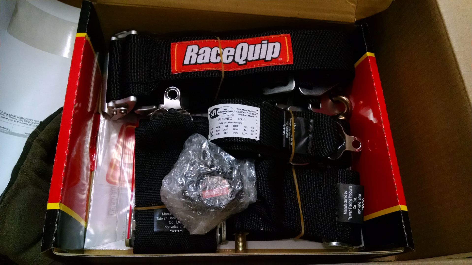

                                Also my harness came in the other day....Jim will bring his own for co-driver duties
