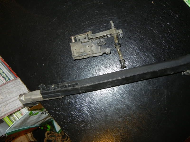

        grr......bit of a botch today. Saw I had a pair of new sunroof seals sitting around, so decided might as well go ahead and do them (the old ones looked old, but weren't leaking). Removed the sunroof no problem, did the seals, re-installed. Went to crank it closed and something must have been jammed in the rail, and of course I thought it was just sticking so I forced it. Oops. Snapped off one of the rail mechanisms. Dammit.
        So, gonna have to find another one, because at the moment there's no way to close the sunroof (and I want it, I don't want sheet metal there).
        This is in the category of "if it ain't broke, don't fix it...." dammit.

          Can you get a pic of what broke? I still have most of my sunroof assembly.

            if you do, that would be excellent....
            here's a pic. The other side is cracking too (the plastic is just brittle), so if you happen to have both sides, that would be 2x as good!
            the main thing I need is the metal piece here, but the black piece would be good too, for both sides..

              I believe I do! I'll check this friday(car/ parts are at my friends house) and I'll pm you.
