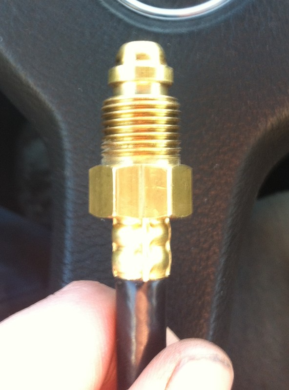

    Take off the fitting and take it to osh/home depot. They will usually have a sizing chart and you can match everything there. Get a 90* and BAM! Problem solved

    Apparently it is a special fitting. The hardware store had to order the 90 from Lincoln.

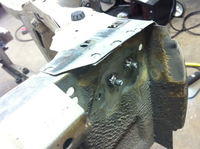

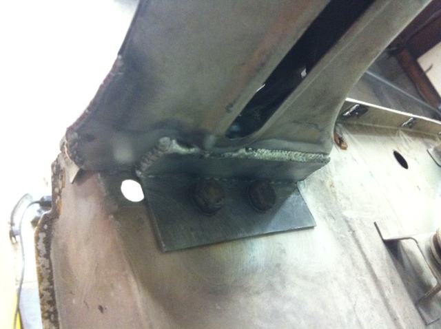

    Today I finished up the rad support. I put new tabs on the top and welded nuts on the back side. AKA, copy Garey
    At least the welder cooperated today!

      Nice job, how many bolts you are going to have TOTAL for the rad support installation?
        ^^^ Justin... perfect!
        Jean, I used 6 which is what it looks like Justin did, as well... 1 on each side at the frame rail and 2 per side at the top, underneath. All with captive nuts welded on...
        Garey
          I have 8 bolts, 2 at each upper point, and also 2 at each frame rail.
          How in the HELL did you weld a nut on the inside of the frame rail? I give you credit for that. The bumper shock opening is only like 3" diameter... to get in there and weld takes some skill!
          I just jam my fingers in there to hold the nut, thread the bolt in, then I can fit a wrench in there to hold the nut while I tighten the bolt. It's a PITA, but I shouldn't need to do it often.

            I just got tired of jamming my fingers in there, lol! It only took a couple of times and I thought "no more"... It wasn't THAT bad... run the bolt in, thread the nut on and tighten it down and then stick the welder head in there and lay a couple of good, fat beads as far around as you can go... Easy, Peasy, Lemon Squeezy

              Maybe I'll give it a shot. I'm willing to bet I'll weld the nut to the bolt, then have no way to remove it. Or better yet, manage to weld the gun to the frame rail, with again, no way to remove it. Lol.

                Gotcha. I just wasn't sure if it was a special type of fitting with weird threads, since it holds gas. Didn't want to get something that seems to 'fit' but ruins the threads and leaks.
                I would talk to someone at OSH. There are a few different kinds of fittings for gasses and liquids. Just have them point you towards the gas fittings. I went through that with a friend while we were trying to figure out some fittings for a gas system on his beer taps. ;)

                  OSH is only in CA, I'm in PA ;)
                  I got it figured out though, I had the local hardware store order the fitting from Lincoln. Apparently it's not a very common. I also had them order me one of the new style Lincoln ground clamps, with the copper strap in the teeth. I just have some old one with broken and bent jaws that doesn't have any copper on it, haha.

                    I'll bet AirGas has the part you needed... I get all my welding supplies from them... and BTW, didn't you see the new "toy" I bought a few weeks ago, in my build thread? I got it right across the street from where you work, hint, hint... go find it in my thread and that will answer your crossover manifold question...

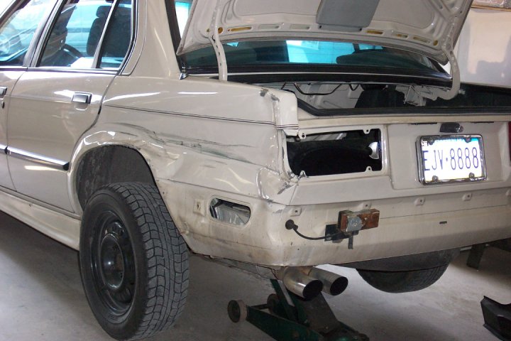

                            That will happen Sunday the 22nd. A friend is coming over and we'll spend the day welding it back on.
                            This is my second time around for the 1/4 panel. I got t-boned a few years ago, and bought a new 1/4 panel and outer wheel well from BMW and put them on (was a cheap rush job, hence the proper fix this time around).

                              Sorry about that...I think my welder might have different fittings :(
                                Use washers or nuts under the head of the bolt to space it up far enough that the threads don't stick out past the end of the nut you are trying to weld. That way you don't have to worry about welding the suckers together.
                                I did this on the starter in my old 325es. I got tired of using the 5ft extension to go in through the grill. I did it up on the work bench so it was a little easier than what you are dealing with, but the concept it the same.
