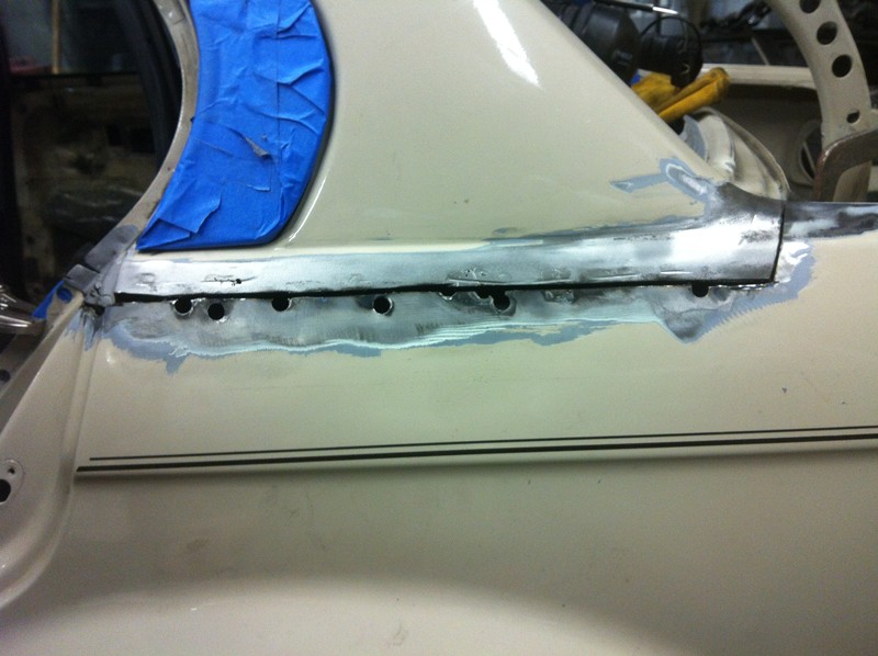

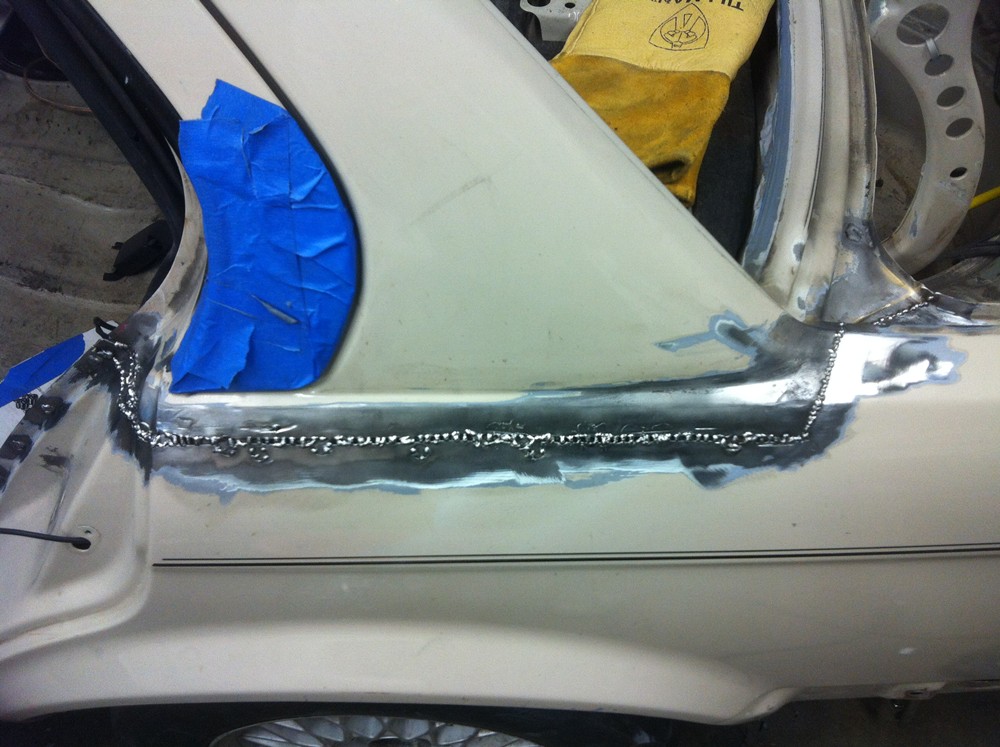

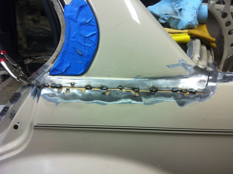

    Started tacking on the 1/4 panel. I'm really happy with the progress so far. I ran into a bunch of issues. Lot's of difficult prep work to undo poorly-done things from the last time the 1/4 panel was installed, some rust to remove in the wheel well/rocker area, and some fitment issues. The 1/4 panel was overlapped previously, but we decided to do a butt weld this time, with a sheet behind it overlapping each panel by 1" or so. The gap was too big to fill without that sheet behind it. The reason for the gap is because we had to cut away a bunch of butchered metal from the previous install (there's still some holes left from previous plug welds that you can see). All in all, I spent 16 hours on Sunday getting it to this point. I'm exhausted, and will probably take a few days off.
    I actually did all of this welding myself. I was hesitant, because I've never done body stuff before. Only one way to learn... Luckily I haven't warped anything yet. I'm taking my good old time, only doing 2-3 tacks per minute or so.

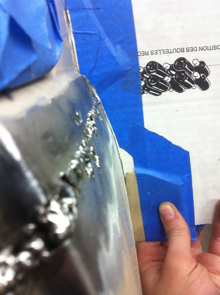

    Template made from passenger side (ignore the blue tape). We're pretty close. Shouldn't take nearly as much filler as the previous overlapped install did.

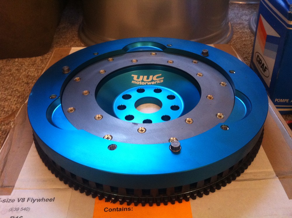

                    Dude, definitely get that UUC or JB flywheel. I lifted the stock flywheel and the UUC flywheel back to back. Actually, the UUC flywheel hurt to lift... but that's because I threw out my back trying to lift the stock flywheel first! My scale says 40lbs for stock, 17lbs for UUC.
                    I'm not sure what hurts more though, bending over to pick up the stock flywheel or bending over to pay for the UUC... :(

                        J - yeah the e39 dual mass was like 38-40lbs as well when I worked on the m62tu... not going with that. It will be UUC , JB or another from UK.

                          Same 1-5 ratios, cheaper, considerably lighter, you can use the e36 drivehsaft and shifter, bolts to stock e30 trans mount, uses cheap/lightweight flywheel/clutch. 6 speed requires custom driveshaft, shifter, trans mount, $$$ flywheel/clutch, much heavier, etc...
                          I'll admit, I would love having an extra overdrive gear if I had a relaxing DD like an e34 or e38. But this car isn't built for cruising on the highway and getting good MPG, so it's not worth the extra labor/cost/weight. Convince Hower to swap his e38!

                          I was in contact with TTV in the UK when I still considered doing the 530i lw flywheel, they have good prices, but shipping and fear of customs hassles kinda turned me away... the JB and UUC have the replaceable friction surfaces that you can get within 2 days notice.

                            Did some more welding on the 1/4 panel today. Almost finished the c-pillar seam.

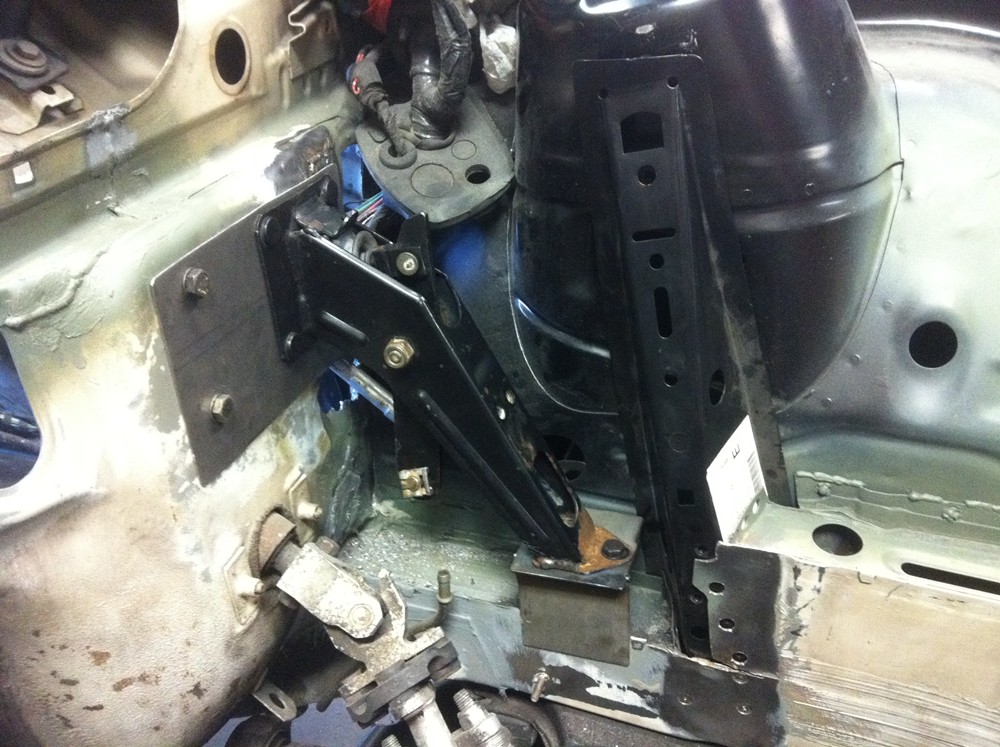

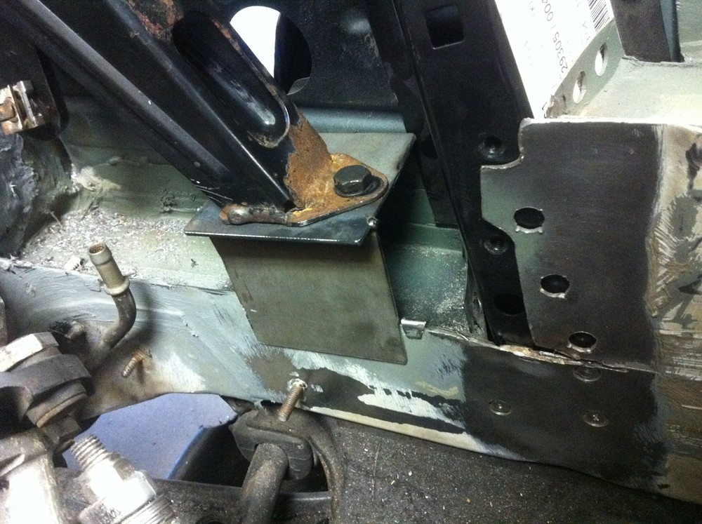

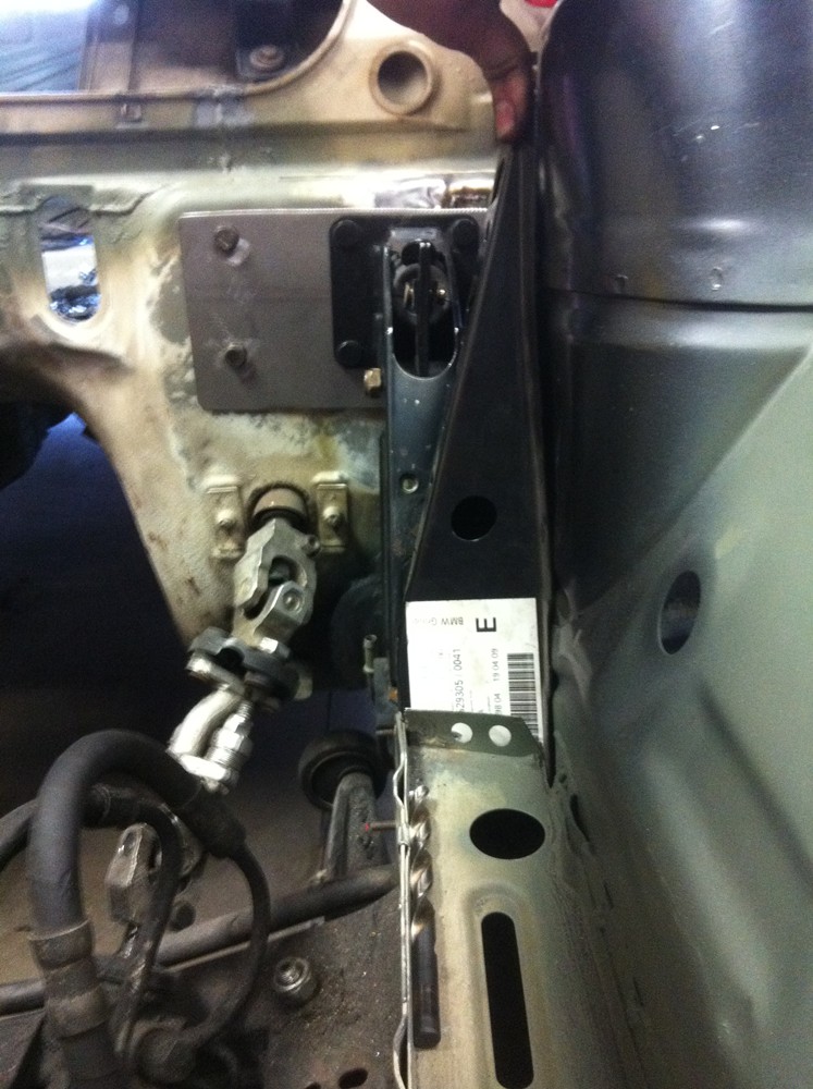

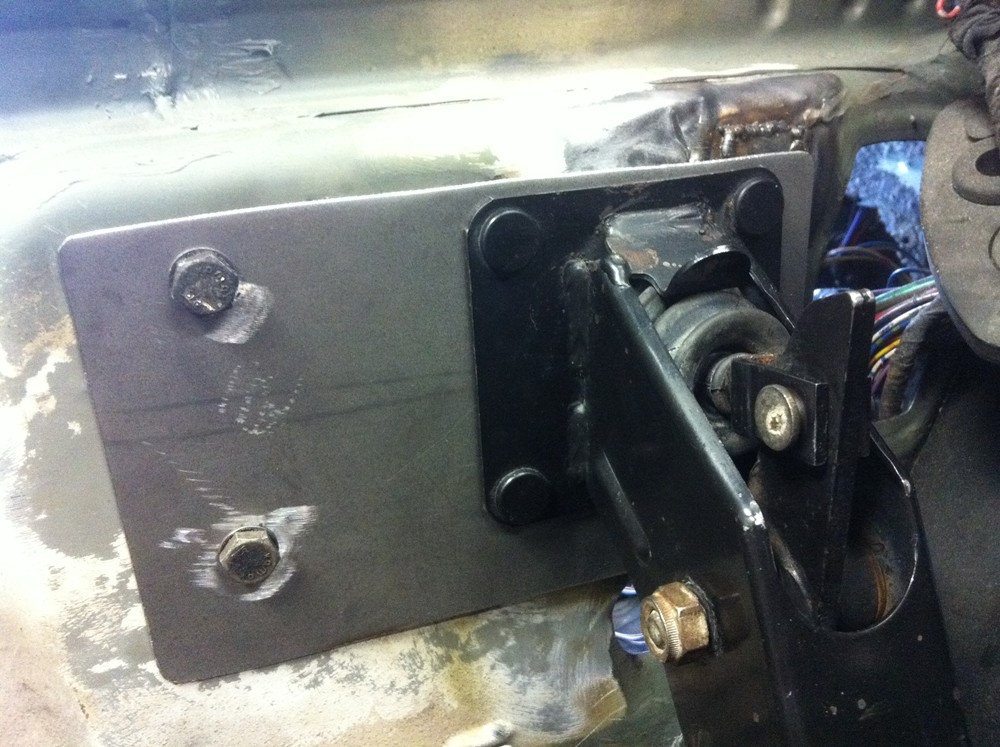

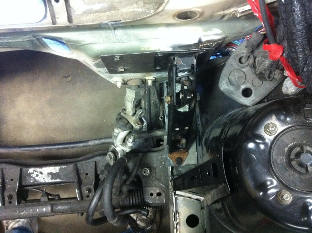

                            Then started working on fitting the e34 booster linkage. Still waiting on the front booster mounting bracket to arrive before I get to crazy, I need to make sure this is all going to align properly. So far, I'm very happy with how it's coming together.

                              Have you asked them how much these cost as replacement?
                                Originally posted by jean View Post
                                have you asked them how much these cost as replacement?
                                $70
