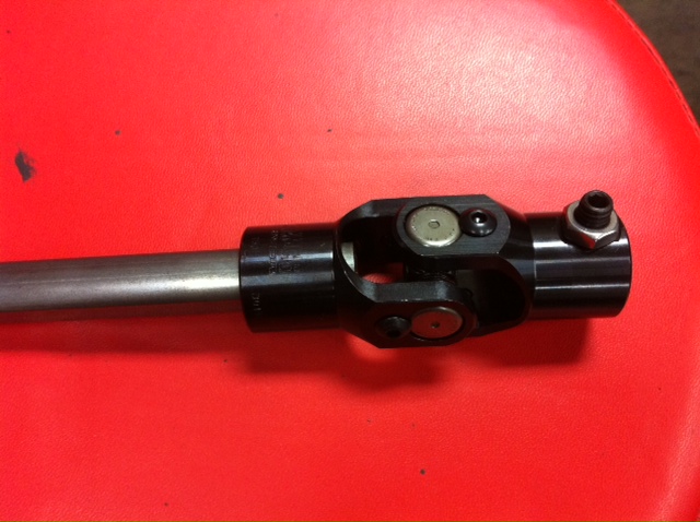

              I'm not sure if I mentioned it before. I'm going to use u-joints from Flaming River, they are the correct BMW spline on one side, and a 3/4" D-shaft shape on the other. So you get two of the u-joints, a D-shaft cut to the proper length, and you have yourself a thin, heavy duty steering shaft. They should be arriving tomorrow, I'll post pics.

                    Here's one of the steering joints and the shaft. It's chrome moly and has a serviceable needle bearing, a very nice part. I checked fitment on the rack and column splines, it's perfect.
                    Thanks to Bruce and Garey for finding these. It will be a huge help in getting the exhaust manifolds to fit while also using the e36 steering rack.

                        They are ~$70 each, it was $160 shipped. Then you also need the 3/4" DD shaft, which you can find for $30-$40. You only need 5" or so.
                        You can see how much thinner it is, providing the necessary clearance for the exhaust manifold:

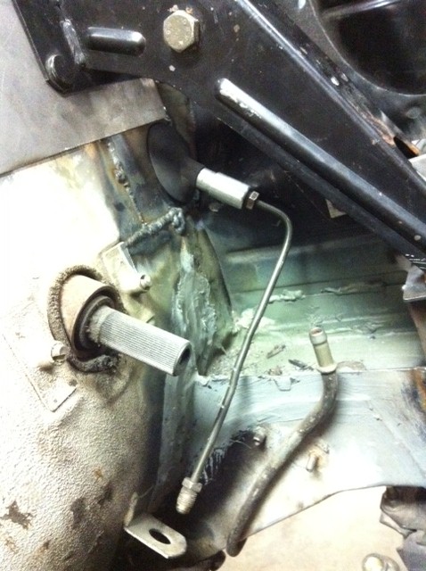

                        Also did some work to the firewall, since the master cylinder is shifted to the left, it can't use the same firewall hole. I welded in a plate with a hole cut out to fit the master cylinder grommet. Was a PITA, with how cramped that area is with the wheel housing in place. The hard line clears the brake linkage movement where it is.

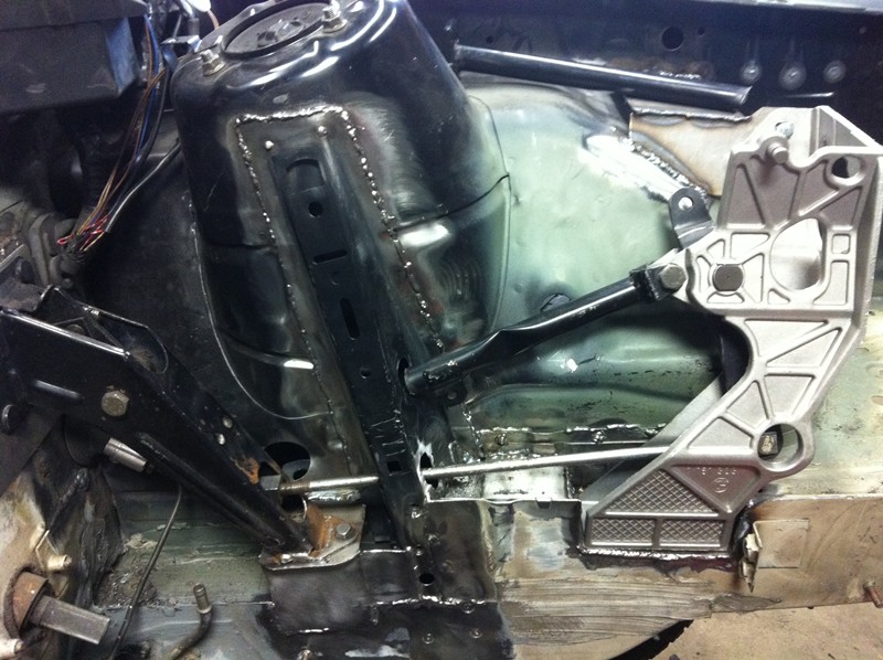

                          Got the strut tower support brace welded in. I created a hole for the linkage rod to travel through, now I just need to clean it up a bit. Also need to figure out what to do with the upper support brace. I can't think of any reasonable way to connect it to the knee bracket on the firewall, as it is in the e34's, without seriously compromising the strut tower support brace. But we'll see.

                            I would make a flat plate to bolt it to the strut tower brace on both sides and be done with it. If it abuts the strut tower brace on both sides and relatively in the same plane, it will function similarly as if it were one piece...

                              Yeah, that would work. In addition I could run a pipe right through the support brace, cut it flush on the ends, and weld it in place, that would remove all doubt of it warping the thin sheet metal on the brace, and guarantee the load will be transferred between the linkage assemblies, as designed.

                                I don't think it will deform the tower brace, but yeah, that would guarantee the load transfer. Seems like a lot of extra work, but it would be effective. Don't forget the captive nuts...
