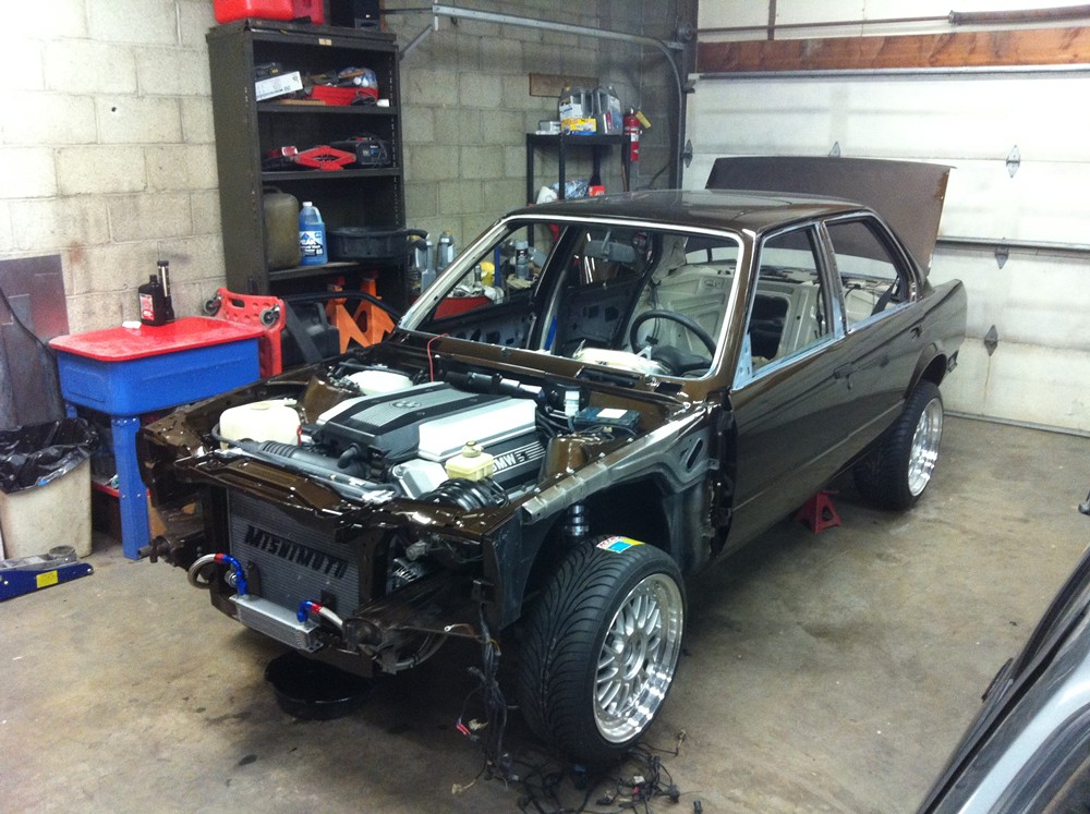

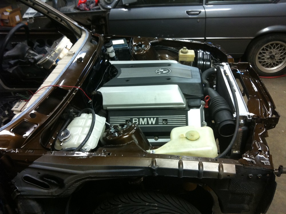

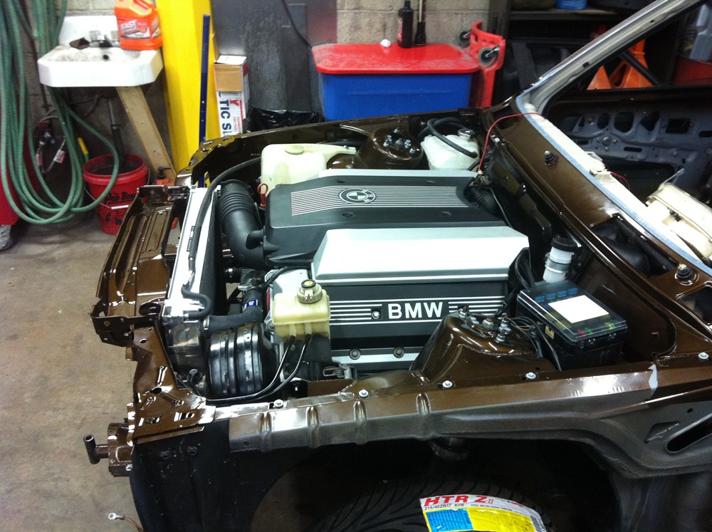

                        I honestly thought I could have it drivable today or tomorrow. Well, the past 2 days have been a real reality check. I still have a lot of stuff to work out.
                        The remote dual oil filter housing is cracked apparently, as it spews oil with the engine running. My VDO oil pressure gauge isn't working, which gave me a big scare as it read 0 PSI, lol. But I watched the resistance off of the the sender with a multimeter, it's a 10-150 ohms range (for a 0-100 PSI gauge). Read 9 ohms with engine off and 90 ohms at idle, which should be good.
                        So I hooked up the coolant system and filled it with water to pressure test it. As I'm filling it, I hear water dumping on the floor. It's coming from the front of the engine. WTF? Looking closer, it's coming from behind the water pump. I instantly begin shitting bricks, and am thinking the worst (cracked block?) as I start tearing the front end of the car and engine apart.
                        Turns out the gasket folded up inside the pump, and wasn't sealing the surface around the bottom bolt. Thank you to the manufacturer for the ridiculous packaging method when you buy a new pump, they throw the gasket in the box with the pump and it ALWAYS gets folded up. On the m60 when you have to deal with the coolant manifold pipes and the crank pulley in the way of the bottom bolt, it's a major issue.
                        I had a hell of a time getting my heater core hoses hooked up, and I'm still not sure if it will work. There is zero space behind the head at the firewall.
                        Here's some pics as she sits now. Looks WAY more complete and ready to drive then it actually is, haha.
