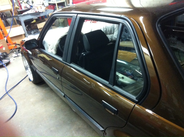

                Tried to install the back window tonight with a new gasket and lock strip. I don't think I've ever been so angry. Took me an hour just to get the window and gasket in, before touching the lock strip. Now that it's installed, the gasket is so tight that I have trouble even getting a flathead screwdriver in the 'gap' that the 1/2" wide lock strip needs to go. I bought the special tool, which I eventually hurled across the garage because it serves no purpose other then to further complicate the entire clusterfuck situation.
                I don't know if it's the piece of shit Meyle gasket or just my complete inability to accomplish this simple task, but either way I'm calling a windshield guy tomorrow morning and having them come finish the job before I throw anything else.

                  maybe the gasket, never had an issue, cept the metal lock sometimes bending a bit

                    I used a bone and soapy water with a good amount of success on both the front and rear glass. Luckily my gaskets were still useable though so I didn't have to worry about new ones being slightly smaller or needing to be stretched.
                    It did take me about 2 hours to get the hang of the technique though on the rear glass. After that took 30 mins for the front.
                    Don't be discouraged though... car looks amazing.

                      I called a glass place, they are coming to finish the job Tuesday. If I keep going, I'm going to end up scratching the fresh paint or cracking the window or something... just not worth it. This actually works out, I'll work on getting the exhaust done between now and Tuesday, then after the glass guy leaves I'll swing by my buddy's garage and slap some inspection stickers on it. The car will basically be complete at that point.

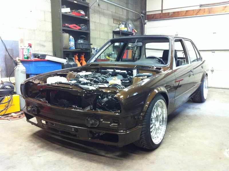

                                Got the front end wired and installed. This was an early model car that I put a late model bumper and HID's on a few years ago, before I knew how to do things properly, haha. So, I spent some time redoing the wiring and making things look nice. I had some issues with the turn signals and headlights working, turns out I had a ground wire that wasn't grounded. All lights, interior and exterior, are now functioning properly, which is a relief. I also got all of the exterior trim installed, and am happy I kept the black trim.
