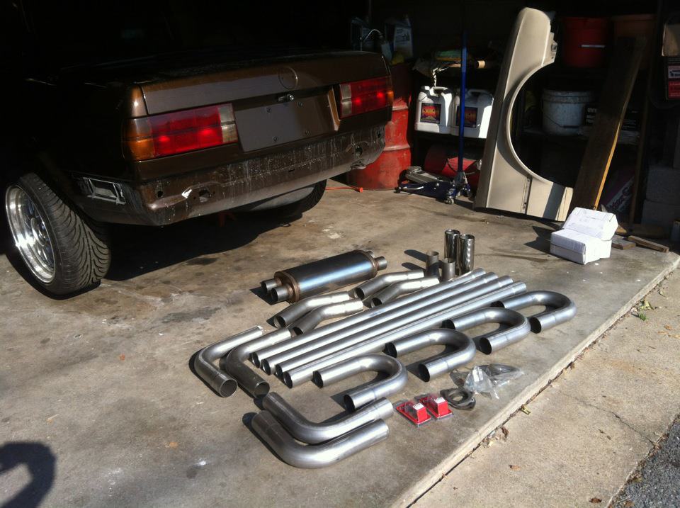

                Lol! Thats genius. Well I'm off to a great start... Welded one flange and ran out of wire. Off to Home Depot...
                I also greatly underestimated how difficult this would be without a lift.

                  I did mine without a lift. YOu need to raise that car as high as you possibly can. Mine was a bitch to do.
                  I got under the car at least 150 separate times for fitment, tack, weld, fitment, .....etc. Sucked, but my car sounds so freaking good. As will yours!

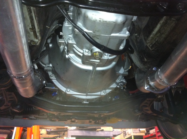

                        Well, that didn't go as I had planned. I'd list all of the problems, but I think we'd run out of forum space. But to summarize... the welder wasn't welding, I have burns all over my body, and my exhaust system is nowhere near sealed.
                        Here is what it currently looks like. Nothing like what I had in mind. I still have to put some bends in the rear, right after the axle, to get the muffler up higher and pointed towards the exhaust cutout in the rear bumper.

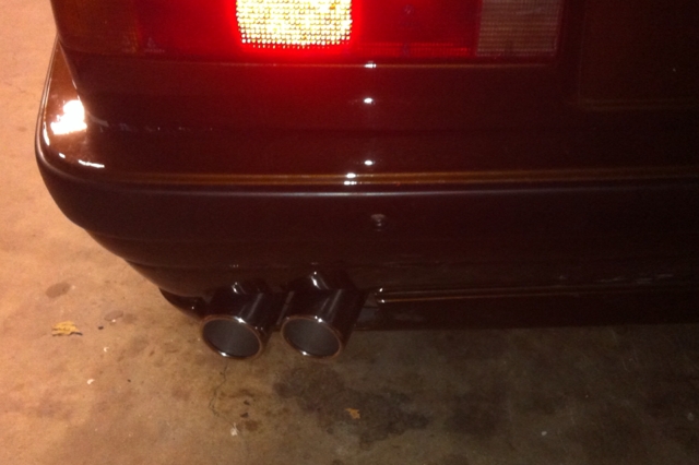

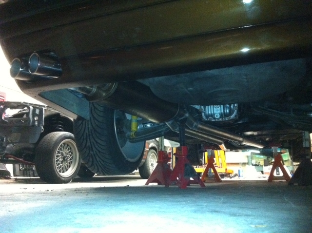

                          Finally done with the exhaust. I want to add another set of flanges, and probably flex pipes. That will come later.
                          On the agenda for tomorrow is to wrap my P/S hoses in a pretty trick DEI 2k degree sleeve that I picked up from Summit (the hoses are within 2" of the exhaust manifold), mount the ECU, wire up the electric fan, watch the windshield guy install my windshield... then... DRIVE THE CAR! Just down the road to get some inspection stickers put on it. After that, it's all just throwing little interior bits and pieces back in, a few hours tops. The car should be all set to make an appearance at the Deutsche Classic in Reading on July 15th.
