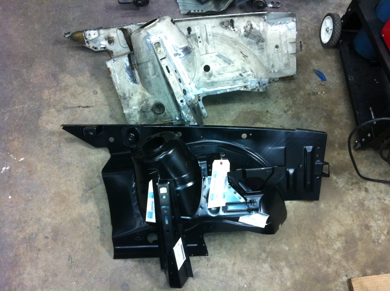

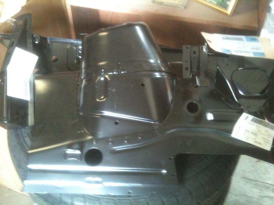

          Look what just arrived. So much for a month wait... it was 10 business days!
          If you want one, act fast. Only 7 left in the world now :)

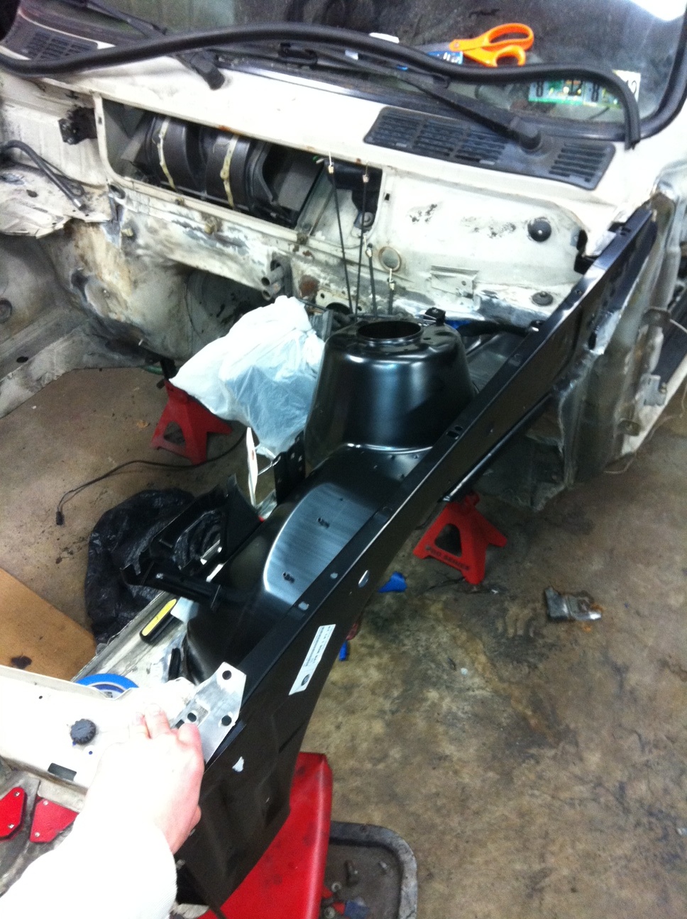

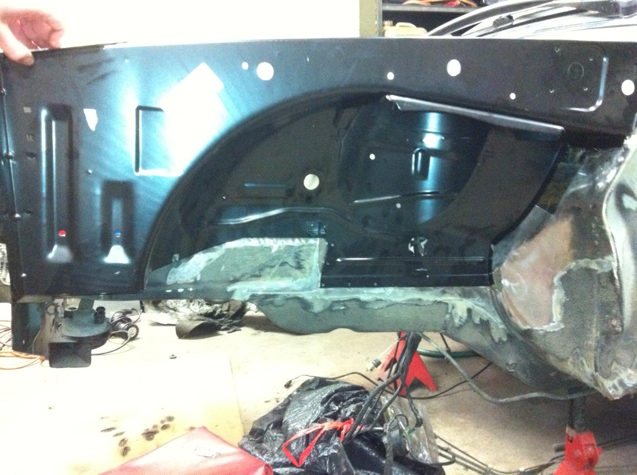

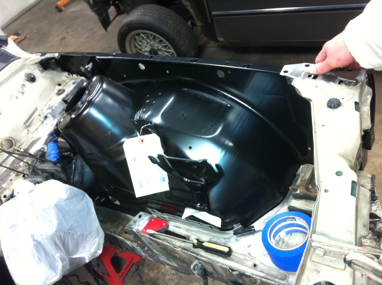

                Lined up the new strut tower on the car to make sure I'm on track with the firewall rebuild. It needs to come out about 1/4" to meet the wheel housing flange, which shouldn't be a big deal. But I'll probably do that before doing any more welding.
                The new part is NICE. All of the brackets except for the cruise control bracket are already attached, so I don't have to worry about getting the hood latch mounts in the right place or anything like that. It wasn't damaged at all in shipping, so it's nice and straight. I'm very happy with it for $300.

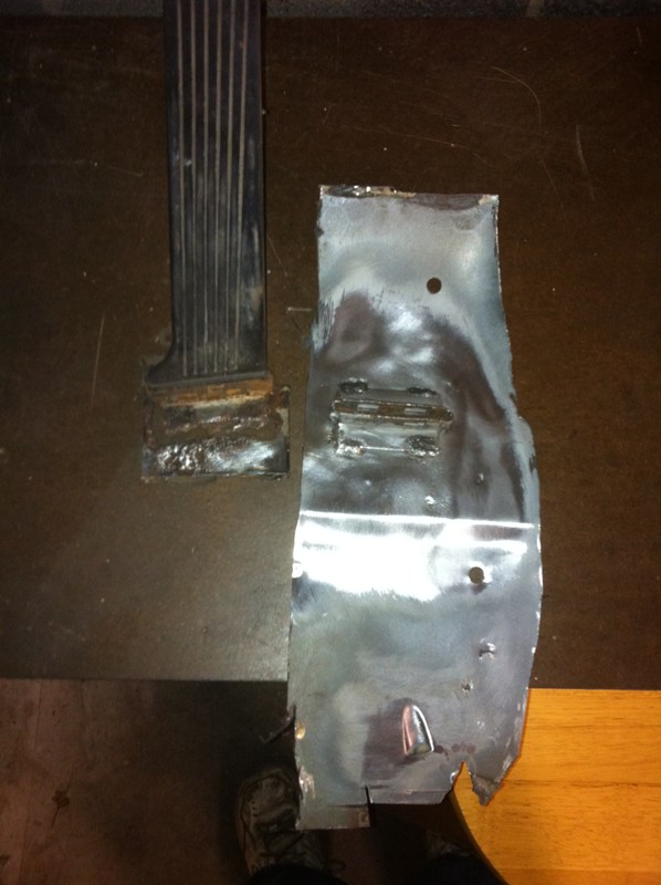

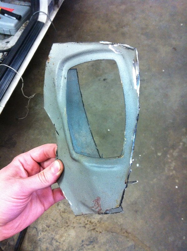

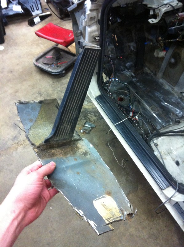

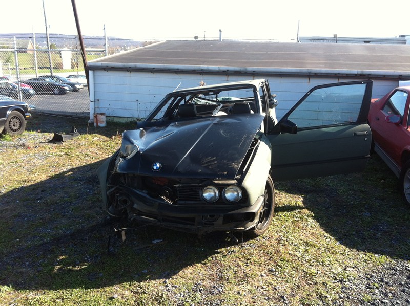

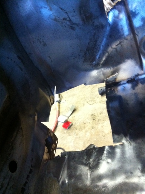

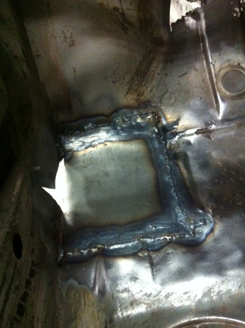

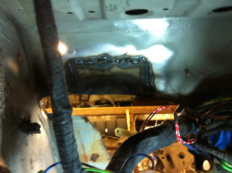

                    A local kid rolled his e30, so I took the opportunity to cut out pieces of the floor and firewall that I needed, before his insurance company took the car. My gas pedal mount was very rusty, and the odd-shaped hole that the wire harness goes through was rusted... so I took both of these pieces. And tonight I finished up welding them in place.
                    Donor:
                    Pedal joint replacement:
                    Firewall hole replacement:
                    I know the firewall looks pretty crazy as far as the welds. I've still got a lot of grinding and more welding to do. The bends in that area are all over the place, it's hard to weld 20g without warping it to begin with, but to conform to the bends in that area are damn near impossible for me. So I'm welding in small pieces at a time, and shaping it as I go. It will most definitely look like shit when I'm done, but it will be hidden under seam sealer and undercoating, so, oh well.

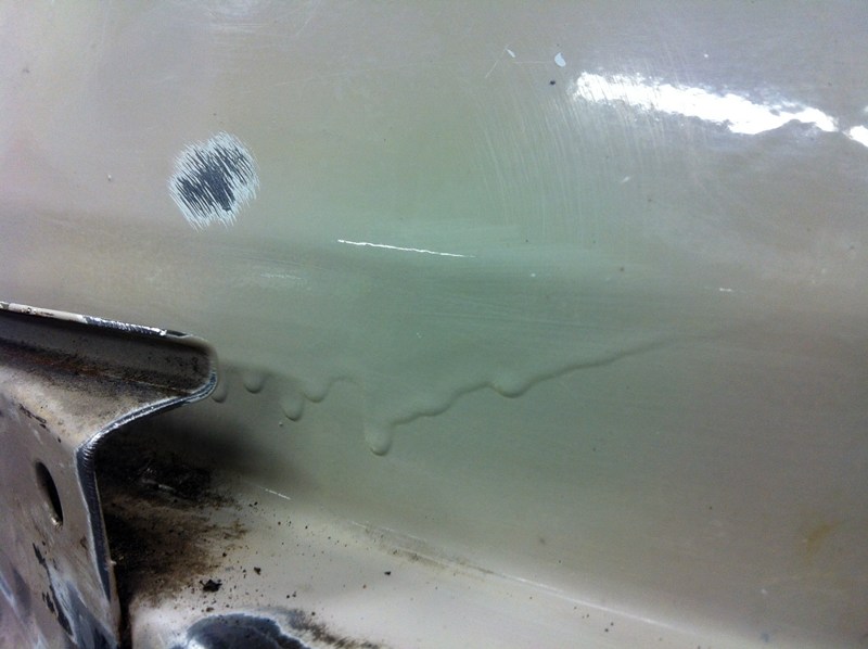

                    One interesting thing I came across on the upper part of the firewall, under the cowl (normally hidden by sound deadening). Runs in the factory paint.

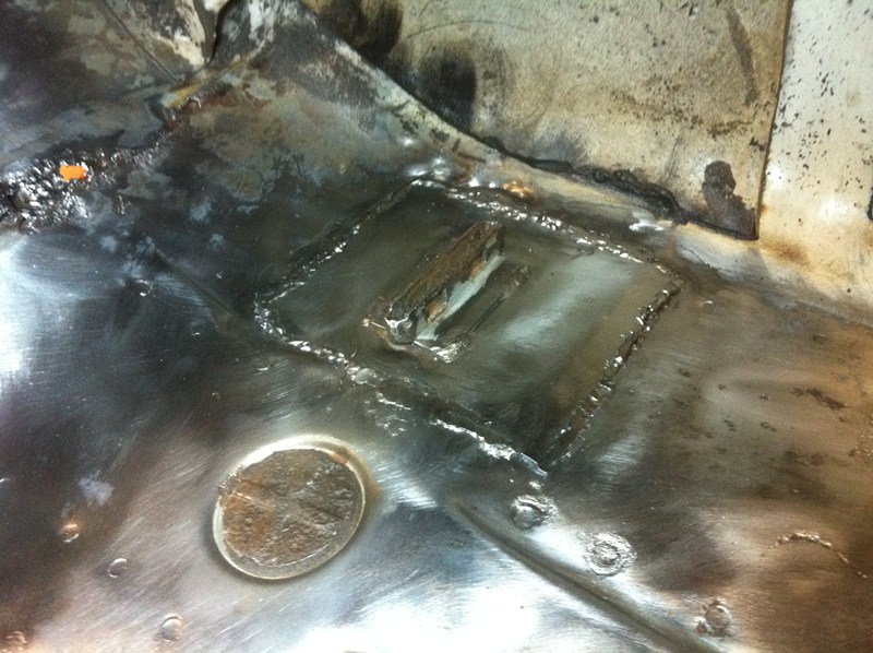

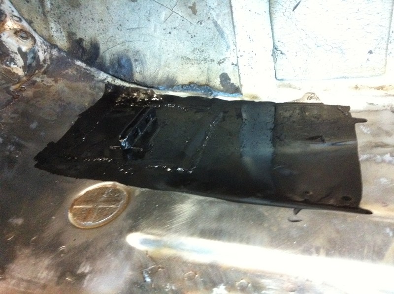

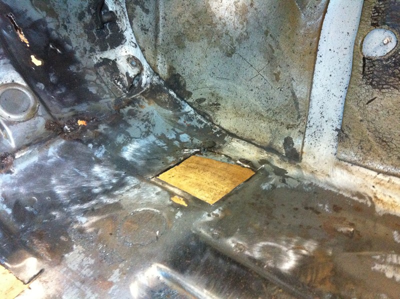

                            Patched up the huge hole where the jack square used to be. This area, like most others, will be covered in Eastwood's Rust Encapsulator, then seam sealer, then painted... So I didn't put much effort into making it look pretty.
                            I also began patching the area of the floorboard near the frame rail, which I should be able to finish tonight... just one little hole to cover. Then I'll be done with the drivers front area, and can move on to reinstalling the strut housing, and then work on the passenger side.
                            I'm really happy with the progress so far. And I've learned a LOT about metal working and welding in the past few weeks.
