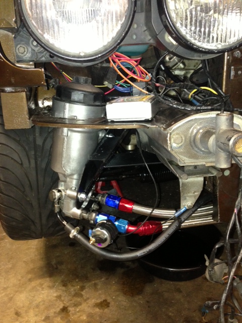

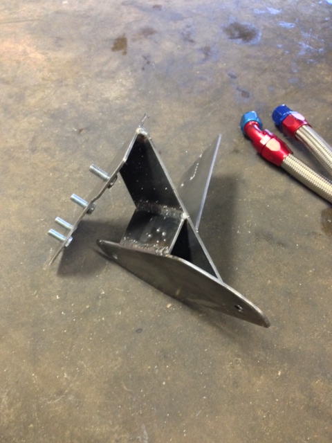

    I blew out another oil filter, even with that box that I built covering the filters. That was it, I had enough.

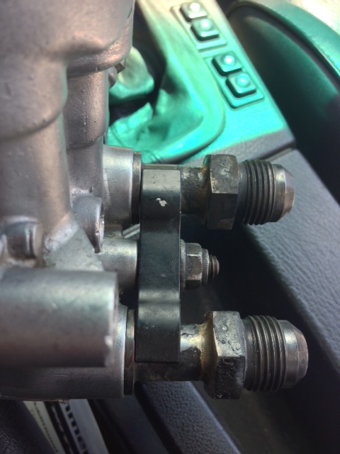

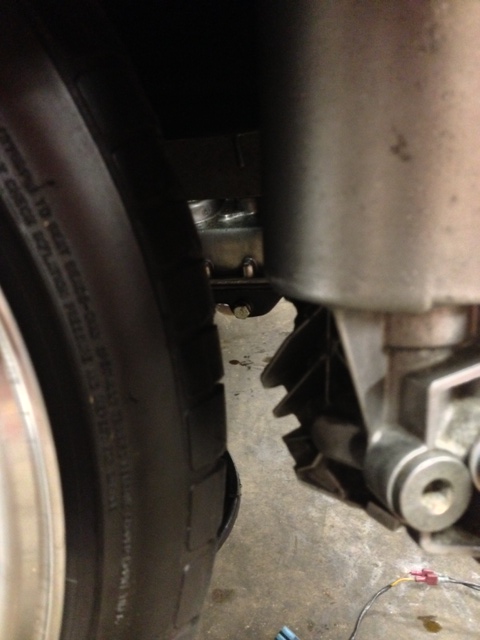

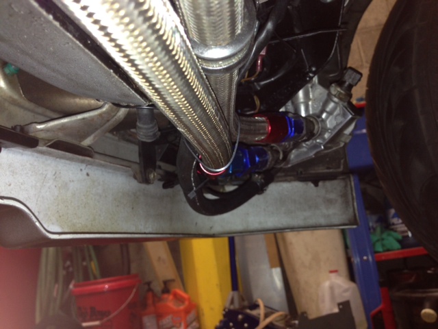

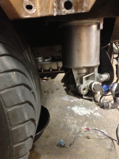

    So i installed the factory m60 oil filter housing, remotely, with AN hoses/fittings. This should solve my problems. It's a hell of a tight fit, between the valance, fog light, tire, frame rail, fender, wheel housing, etc... I have about 1/2" of clearance in any direction. It took me about 15 hours to do all of this.
    Had some 10 AN bungs brazed onto factory metal lines that I cut down:
    Clearance with the wheel turned (had to trim the corner of the housing off):
    Clearance with the wheel straight:
    Road clearance:
    That black hose is just the filter removal drain. When you start removing the cap, the filter lifts up, and a push-button valve at the bottom is opened, draining the oil back to the pan so it doesn't spill everywhere. I haven't tested it yet, it's all gravity based, and I don't have much of an incline between the filter housing and the pan. We'll see. If it doesn't drain properly I'll just put a ball valve at the end and open that while I'm draining my oil pan, to drain the housing when changing oil. In addition, that's why I'm not terribly concerned about the ground clearance. It serves no real purpose other then not making a mess when changing oil.
