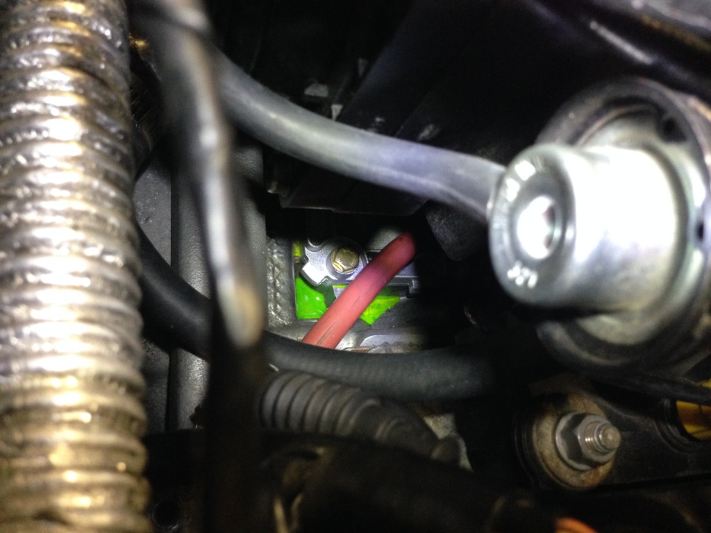

        I bought some UV dye for the coolant. It looks like there's a puddle around the valley pan gasket. I've never wished for a valley pan gasket leak, but I'd give anything for that to be the problem right now! I could fix that in a few hours.

            UV dye don't lie!
            The valley pan must be the culprit. This is GREAT news, as I don't have to tear the entire car apart and pull the engine, just need to pull the intake manifold off. The reason it's pouring water from the bellhousing is that there is two weep holes in the back of the block above the valley pan for coolant to escape.

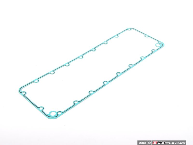

              Scrape that peice of shit gasket off the valley pan you have, order this part number (11 14 1 736 175) and install it. Thats what I have on mine, the super top secret valley pan replaceable gasket part number! Only about $15ish.
                I read the thread where you guys discussed that gasket. I called the dealer, they didn't have it, but did have the whole pan with rubber gasket. I think the issue was the casting of the Uro pan, so I just got a new pan. I'll get the seperate gasket to install on that pan next time.

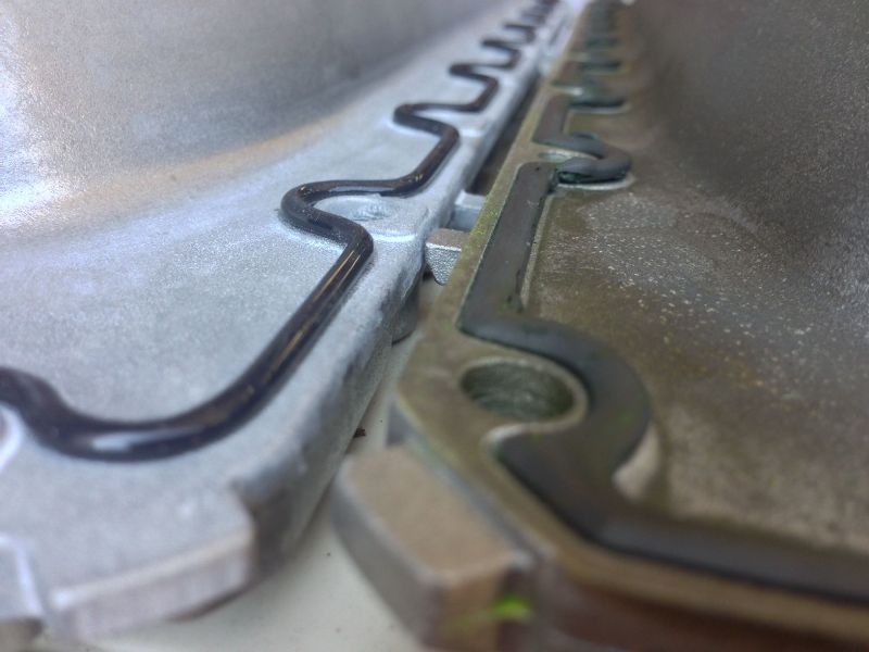

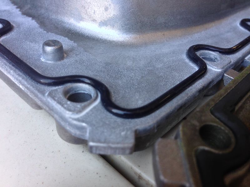

                  Here's the OE pan vs the Uro 'upgrade' pan. You can see the Uro pan has a bigger gasket and a retaining lip to keep it from blowing out. Pretty good design, pretty poor execution. The holes aren't drilled properly, I had to drill a bunch of them out bigger to even get the bolts in. Not that that bolt holes themselves weren't big enough, but the pattern was off, I could only get half of the bolts in at a time, the other half wouldn't line up. Obviously the pan is also warped or something, as it leaked when installed, and the gasket wasn't blown out. Sucks that they went through the effort to make a better design, but didn't go through the effort to make the thing fit right.
                  As of now, looks like Ryan's suggestion for the OE pan with the early style paper gasket is the way to go.
                  Uro pan:
                  OE pan:

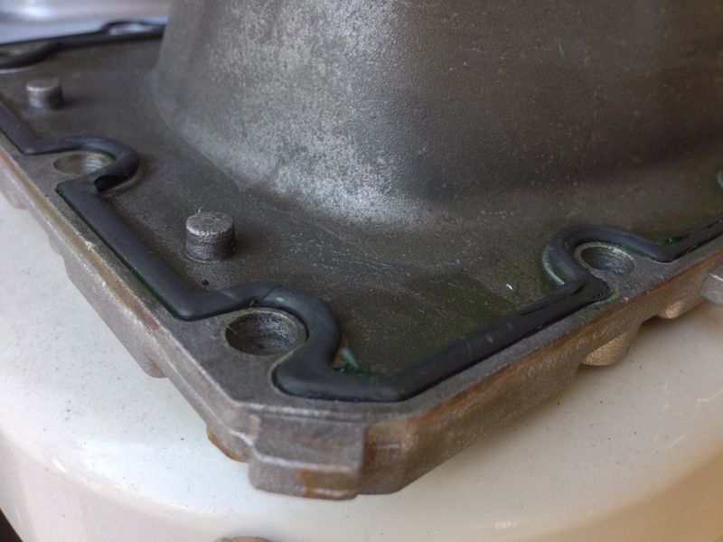

                    And now that I'm looking at the old style gasket, it doesn't look compatible with the new pans. You'd either have to have one of the old m60 pans (discontinued?) or machine one of the new pans flat. Which may bring about it's own set of problems...
                    You can see the old style pan doesn't have the 'feet' around the bolt holes. Definitely a better design.
                    e30 restoration and V8 swap
                    24 Hours of Lemons e30 build
                      Looks like the new style pan has the o-ring seal integral, so that there's no reason to use the old seal with the new pan... do the new pans frequently end up leaking?
                        Yes, they're a known weak spot.
