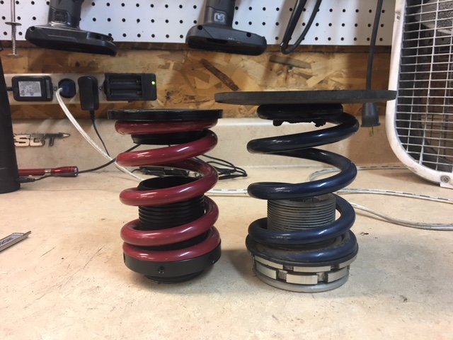

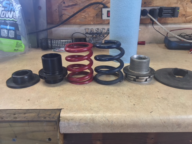

          So I got some 825lb, 4" length, 2.25" Eibach springs, and an Ireland Engineering rear perch kit. I really really like this kit, especially in comparison to my previous setup. The sleeve is machined to slip perfectly over the lower factory perch with no play, and the upper urethane hat fits the top perch perfectly. I did end up cutting the threaded sleeve down to avoid contact, since my car is fairly low.
          The car no longer squats nearly as much, and the ride does not feel any harsher. If anything, it feels more closely matched to the front. And if you calculate the actual wheel rate for a 450f/825r setup, it comes out to about 395f/370r. Maybe not ideal for the track, but for a street car with a lot of torque, I think this is a really good setup.
          I may ditch my UUC 19mm rear swaybar and replace it with a stock one, not sure yet.
          The spring rate makes a big difference to static height, this is how I adjusted the 825lb IE setup to get me the same ride height as the 600lb GE setup.

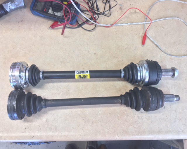

          Worked with Igor at CA Tuned, and ended up buying a new version of their upgraded axles to replace the stock axle I put back in after I broke the first CA Tuned axle a few weeks ago.

            So, I just bought a set of 825lb 4" long 2.25" springs. I had to also order an IE rear 2.25" coilover sleeve kit, as my rear coilover setup was the GE group buy stuff, utilizing a custom spring. So the adjusters were 2.5", and there are no 4" long ~800lb 2.5" springs. Doh.

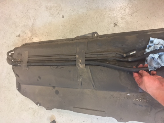

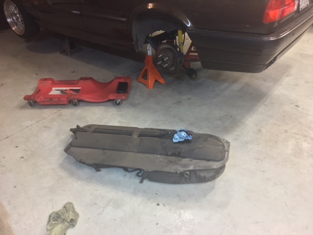

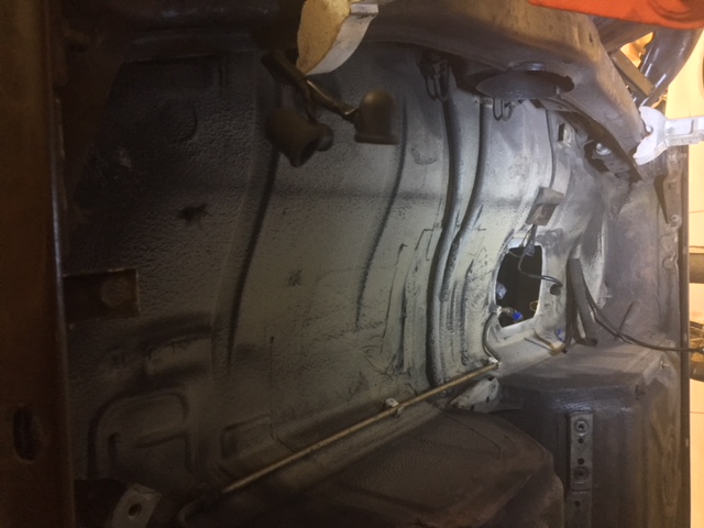

                          There's rain in the forecast for the next two weeks, so I decided to dig into the diff and fuel pump conversion. I pulled the exhaust, heat shields, driveshaft, diff, and fuel tank last night.

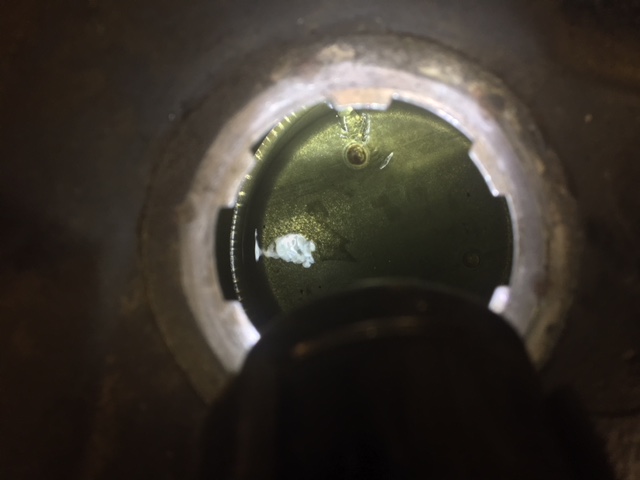

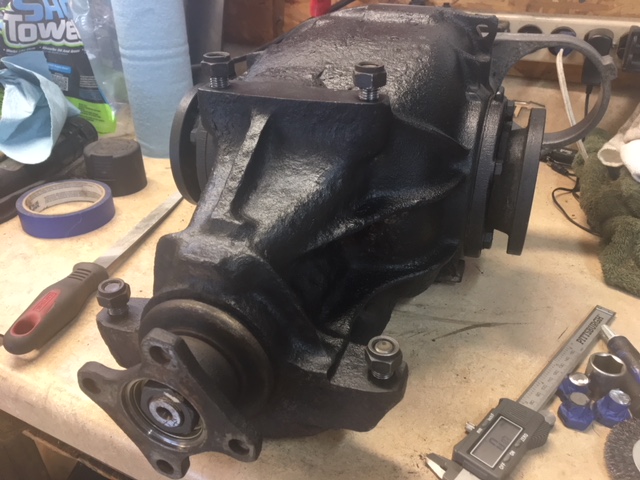

                          I have a spare 2.93 LSD that was VERY rusty. Last week I cleaned it up as best as I could, and painted it. Also put in an 80A poly bushing. I decided to cut some M12x1.5 bolts I had laying around and install them as studs into the diff. Hopefully that works out.
                          The whole point in dropping the tank was to remove the 12mm low pressure fuel line and replace it with a new 8mm high pressure hose, for my single pump conversion. I was under the impression that there was a 12mm hard line attached to the tank. Turns out, it's just the soft line the whole way across, just laying there, and you can literally just pull it right out. Knowing that, I could have simply connected my new 8mm line to the end of it with a barb at the fuel pump access hole, and pulled it out from the side underneath the car. I wouldn't have had to pull the exhaust, heat shields, driveshaft, and drop the tank, etc... Doh.

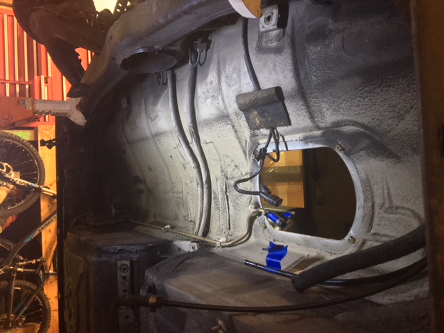

                          No Rust!
                          Some shots of under the car where the tank sits. Gazelle Beige! Ah, the memories. This is actually the first time I've had the tank out. I think the only other part that hasn't been removed from the chassis yet is the e-brake cables. Look how nice and clean the metal fuel tank breather line is. That thing is 33 years old and has seen 340k miles in Northeast snowy, salty winters.
                          Tonight I'll get the Walbro installed in the 318is hanger and weld up/reinforce the chassis where it cracked at the diff mounting tabs. Then I can reassemble everything later this week/weekend.

                              There's 3 different types of fuel pump/tank setups in e30's:
                              -Early model, (up to 87 IIRC), and M3: Dual pump. One in-tank, low pressure/high volume pump feeding an external high pressure pump. In-tank pump has a 12mm output and an 8mm return from the fuel rail. External pump has a 12mm inlet, 8mm outlet.
                              -Late model (but not m42 cars): Single in-tank high pressure pump. 8mm output only on the pump, return from the rail is built into the tank itself.
                              -m42 cars: Single in-tank high pressure pump. 8mm output and 8mm return from the rail.
                              My goal was to have a single in tank high pressure pump on my early model dual-pump car.
                              You can't (safely) put a high pressure pump on the stock early model in-tank hanger because the 12mm output line is not high pressure, the chassis line is 8mm so you'd need to adapt it there, and also most high pressure pumps are 5/16" (8mm) outlet so you'd need to adapt it there as well.
                              You can't put a later model pump in because it doesn't have the necessary return line.
                              You can use the m42 pump because it has the proper return and an 8mm output. You just run a new 8mm hose the hole way to the chassis line. And an aftermarket in tank pump goes right onto the hanger.
                              That said, I think a stock m42 fuel pump flows enough to support an N/A m60. I know a few people did m6x swaps in 318is without swapping pumps, and I read somewhere that someone was supporting a S/C s52 with a stock 318is pump as well. They are about $250 though. I bought a used pump for like $30 and am putting an $80 Walbro on it.
