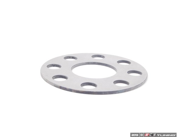

        so Delamaize was right!loose flywheel, seems I was missing that load plate
        but things got nasty in there
        gouged things pretty bad, not sure why the gouge got so deep on each side though? just vibrations and metal particles grinding away I guess.
        so going to debrur crank, replace everything else, get missing parts etc and put back together, no way am I replacing the crank.

          I don't see any loctite in there unless the flash is hiding it. I don't care what anyone else says, i red loctite all my flywheel bolts and have had exactly zero flywheels come loose ever.
          Make sure all the high spots are off the crank end and you should be good.

            What did you torque them to? Couldn't tell you how many FW's I have done and never had one come loose, never used Loctite, but always to torque them to factory spec. BMW bolts need sealant to keep the thread from leaking oil, though.

                  I ordered more new hardware so they come with that yellow sealant/lock on them.
                  120nm was the torque, the thing was the bolts werent that loose, they had just backed off a very slight amount which let the thing pivot side to side.
                  not sure why this happened, I've done like 5 or 6 flywheels and non have had issues except this one.
                  ALL hardware was brand new, and the flywheel bolts had the yellow lock on them and was torqued down, not sure how this happened, only thing I can think of is its the missing torque plate, spacer caused this issue

                      Wow got nasty in there. Missing load plate will definitely cause that.

                          Dont remembrer if your flywheel is made of aluminium, but if yes, the load plate is important... Even if its from 6061 T6...

                              Good thing you stopped driving it, you wouldn't want that flywheel letting go on WOT pull.
                              Some liquid teflon sealant on the threads or loctite is all you need. Another thing to check is the correct flywheel bolt length.
                                Length is a reason more than one car has come in for "engine is locked". :(
                                The look on their faces when they see the short invoice to change a few bolts is priceless, though lol.
