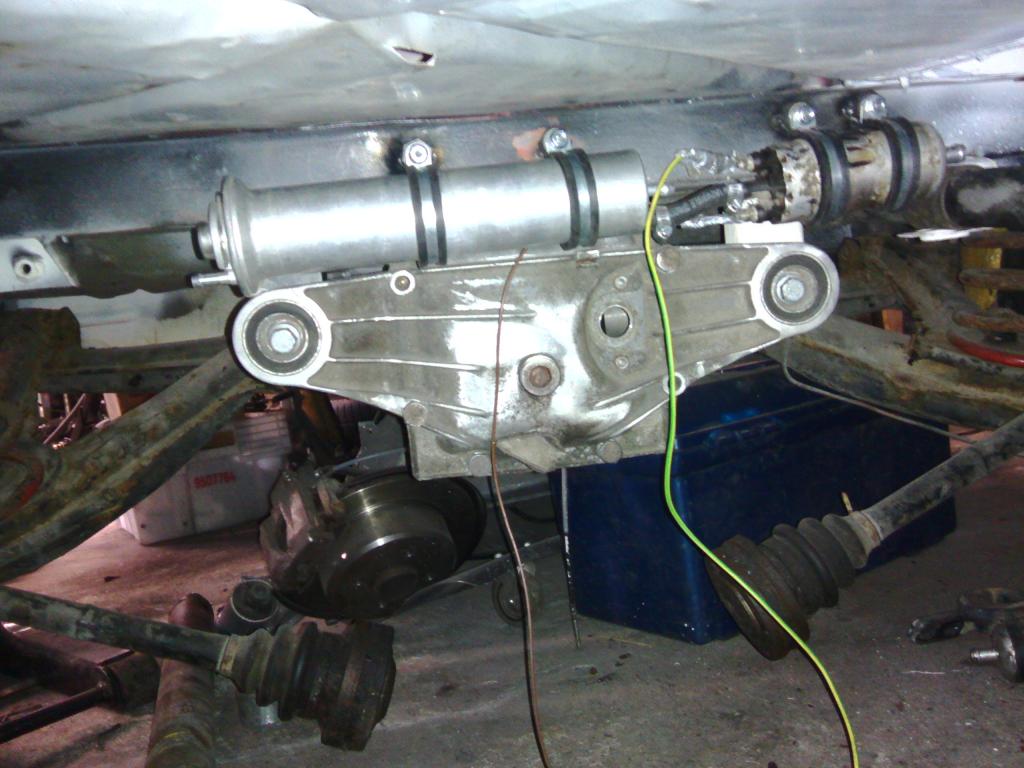

                        Started work on fuel delivery system. Mountings for second fuel pump and filter
                        A lot of fuel hose going back and forth :)

                            • Bearmw
                              • 1323
