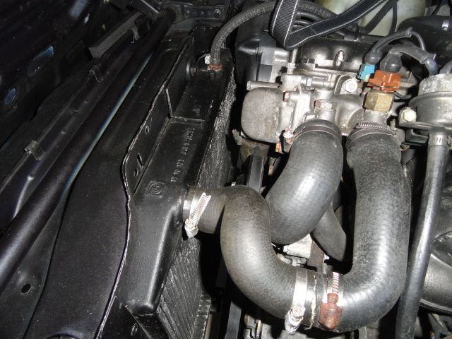

              #321
              Thanks yes the traditional route is they way to go. I believe my mounting points on my engine are different to what comes with the B6 perhaps that sets the engine back far enough to get the E28 rad without the custom mounts. Although obviously mine are not standard e30 mounts they are the alpina specials in ally.
              see how it sits in the aperture taking up valuable space core is nice and thick and copes with keeping the car cool but there is a lot of wasted space. Notice as well that the engine sits close to the front the alpina mounts do not push it back as far as it could have gone.

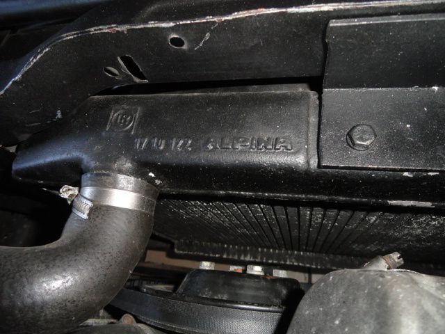

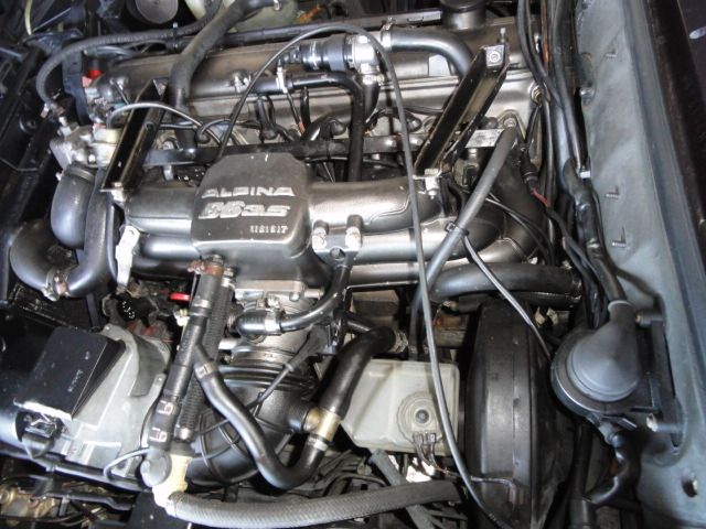

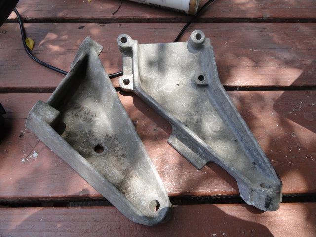

                    Hello scoobydo.
                    Alpina made 2 types of Alpina B6 2.8 and 3.5 motor mounts. From 84-87 the used aluminum motor mounts in position one with Alpina radiator. It also had a Alpina aluminum oil pan. I think it allowed it sit in position 2.
                    I have a Alpina B6 2.8 or 3.5 oil pan coming from Germany soon.
                    These pics were taken week ago in San Diego. It is a 1985 Alpina B6 3.5.
                    From 87 and up Alpina changed the Alpina motor mount to steel and to position 2. Position 2 allowed to use a e28 radiator.

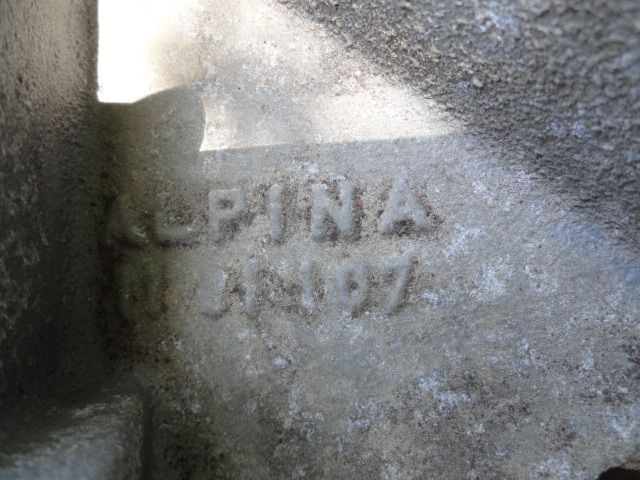

                        Originally posted by whodwho
                        Is this the one you have been looking forever for?!?!
                        No. The one I been searching for years is a Hartge H35 or H35-24 oil pan. I did find one in bad shape. Still looking for a other one.
                        I did find a Alpina oil pan. This one was made for Alpina B6 2.8 1984-1986 and Alpina B6 3.5 1985-1987. The Alpina B6 oil pan only allows you to be in position 1.
