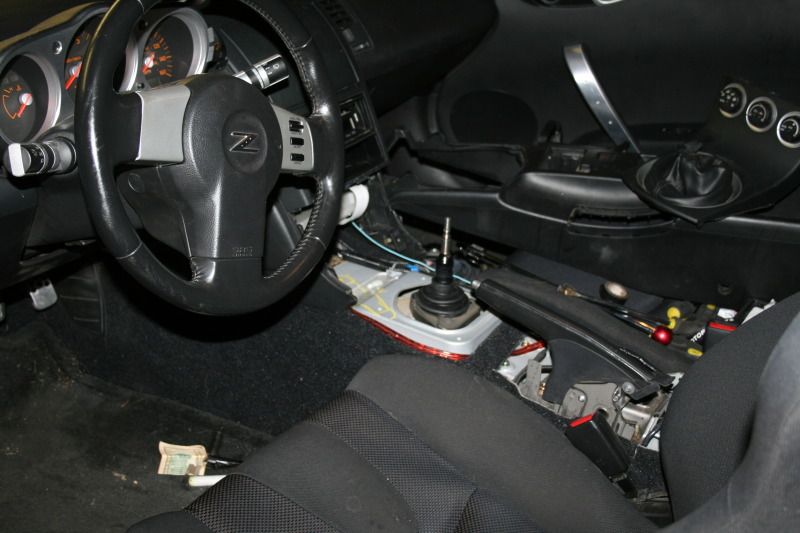

            getting ready for E-town and I decide that the Z needs a working Ebrake
            picked up a hydro from CNC and started on the mount. Picking up fittings, hard lines, and reading my owners manual tomorrow.
            I removed two screws and everything came apart... Nissan quality!

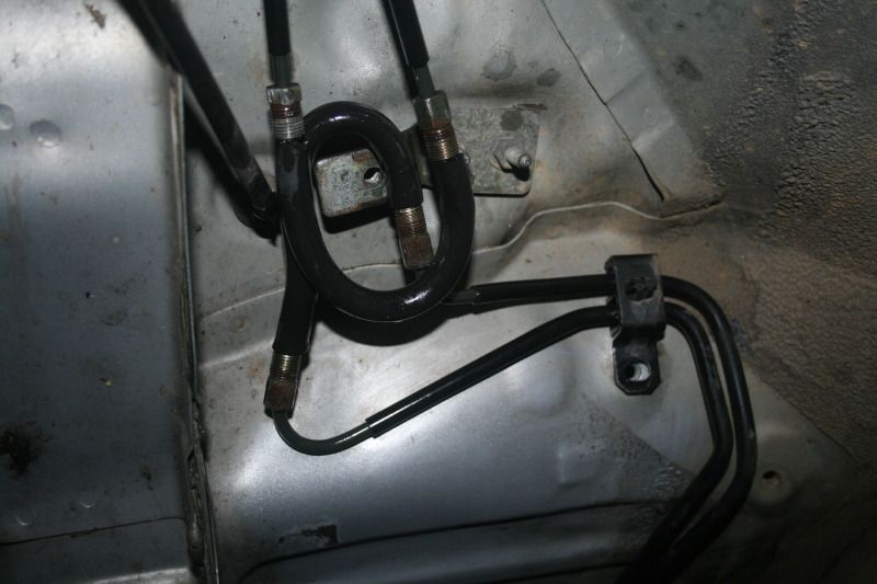

            here is where I decided to tie in my hydro. The Z is wierd and the ABS is an X pattern so tapping here is easier then the MC and ABS block... I still need to switch my primary front / rear lines for this to work and my car will permanently have no ABS
            notice the sweet lines to stop brake fluid from coating my floor, fuh

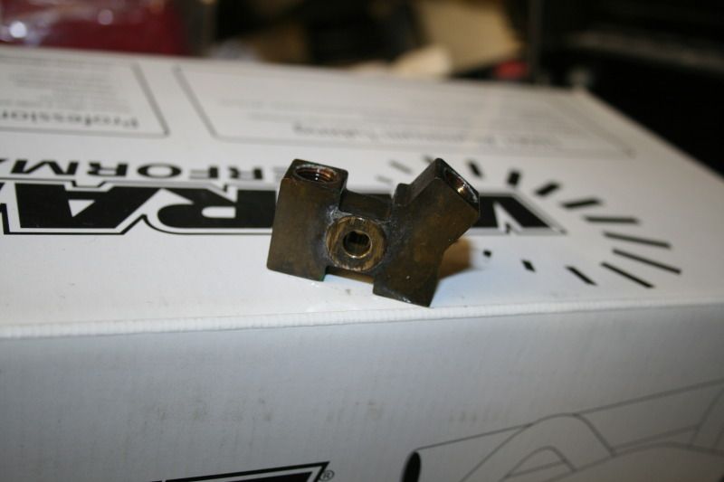

            this came out and will be replaced by two T adapters
