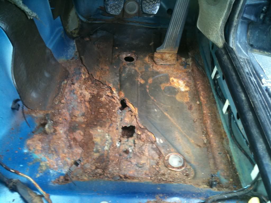

      thanks for the other tcanin00 but ill see if i can find one in australia first. Look what my E30 gave me for christmas drivers floor pan full of rust FML. What is my best option here? any advice is welcome.
      the rest of the floor is fine bar some surface rust but not much at all.
        #33
        thats bad!
        if i were you i'd scrap it!
        if you want to save it you NEED to CUT it all out and weld in good material, once you start cutting then you'll know exactly how bad it really is
          #34
          You could find one cheaper than the cost to ship it to you. Terrible luck on your floor! It looks like water sat in the floor and deteriated it. Does the sunroof seal properly? How is the whether, does it snow during your winter season? This area destroys cars because of road salt and extremely rough roads.
            #35
            im thinking about cutting it all out ang getting new metal welded in i realy dont want to scrap it. And sunroof seals fine and it does not snow over here
              Hows the passenger side? Shouldn't be too hard to find a donor vehicle to cut that all out of and weld it into yours. Great work so far though!

                thanks funfgan i was just talking to a maye who build old school hotrods he recons he can fix it all for me plus the rust in the rear panel under the bumperbar! free rust removal LOVE IT

                    That's cool your friend can fix it for you. I would hate to see a car like yours be scrapped over something that can be fixed. I would look for other leaks though, like around the windshield or the fresh air intake for the hvac.

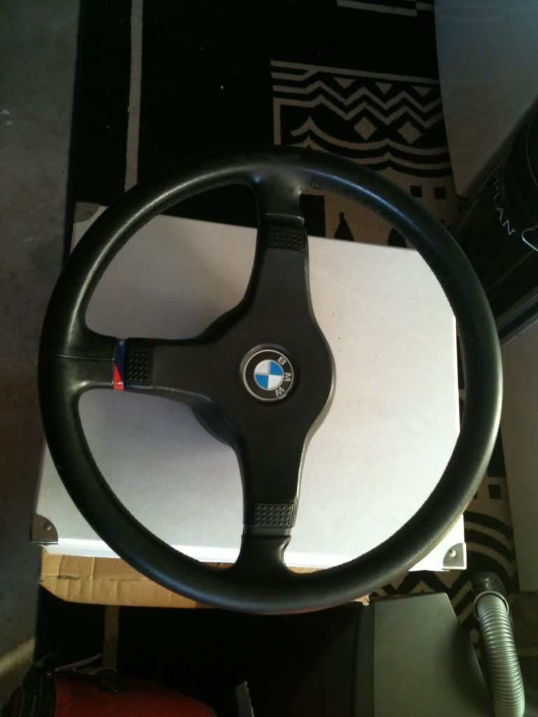

                        picked this up today :) so much nicer then my old 4 spoke wheel!
                          #42
                          Hvac is heating ventilation air condition. We tend to use the term more in reguards to home systems then automotive. Nice find on the Mtech 1 wheel.

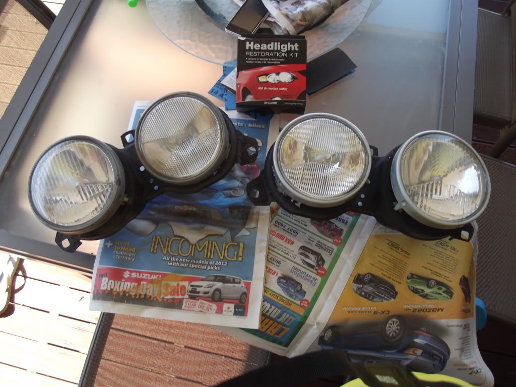

                            Thanks tcanin00 ill have a look into the Hvac. I am mostly just waiting on parts for the car atm, But looking at the old dirty headlights, grille and headlight surrounds was killing me so I brought one of those headlight leanse cleaning kits and got stuck into cleaning the headlighs!
                            Here they are after beeing cleaned with the Invison kit

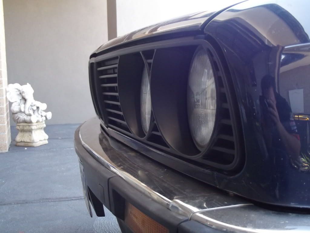

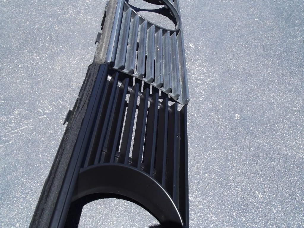

                            Painted VS old headlight surrounds

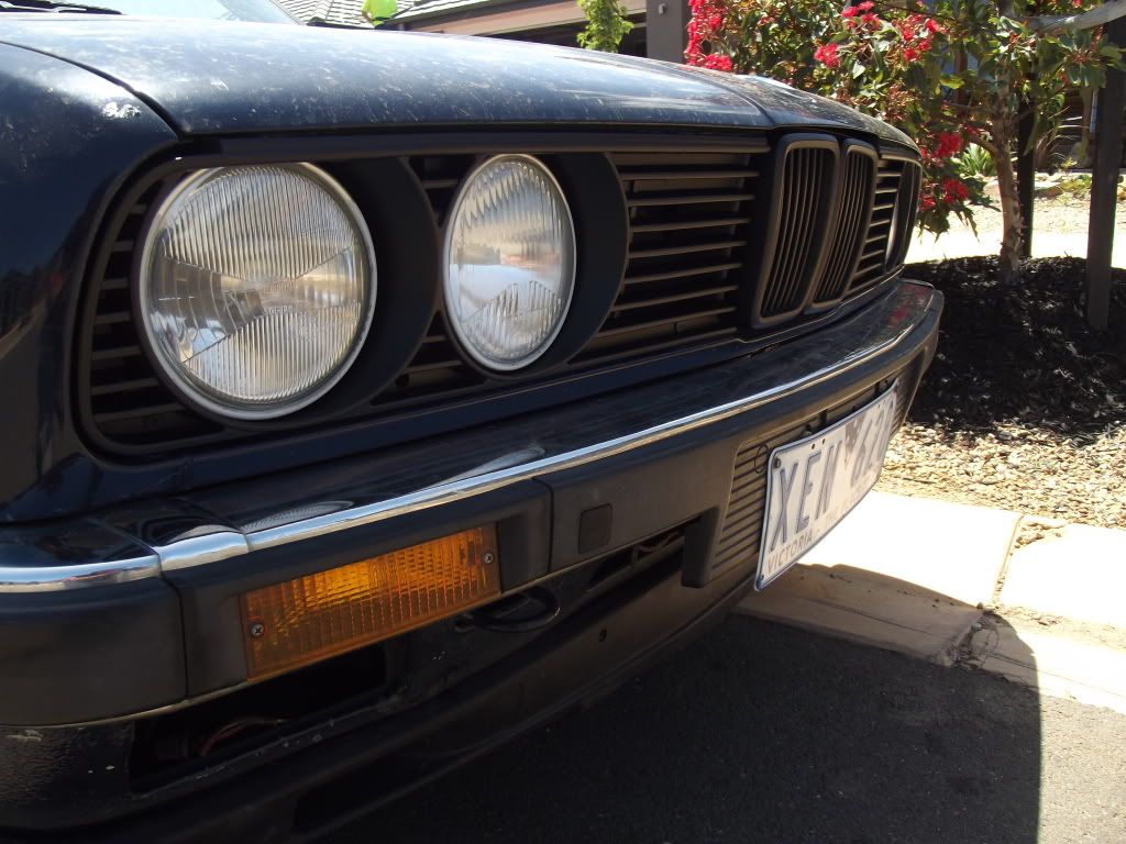

                            And all put together With black kidneys.
                              #44
                              The headlights and grilles really turned out nice! The average person is usually in such a hurry with a car project that they just buy new parts. I like to see when the time is taken to repair and reuse parts that can be fixed. Excellent work. How are things going with getting the floor fixed?
