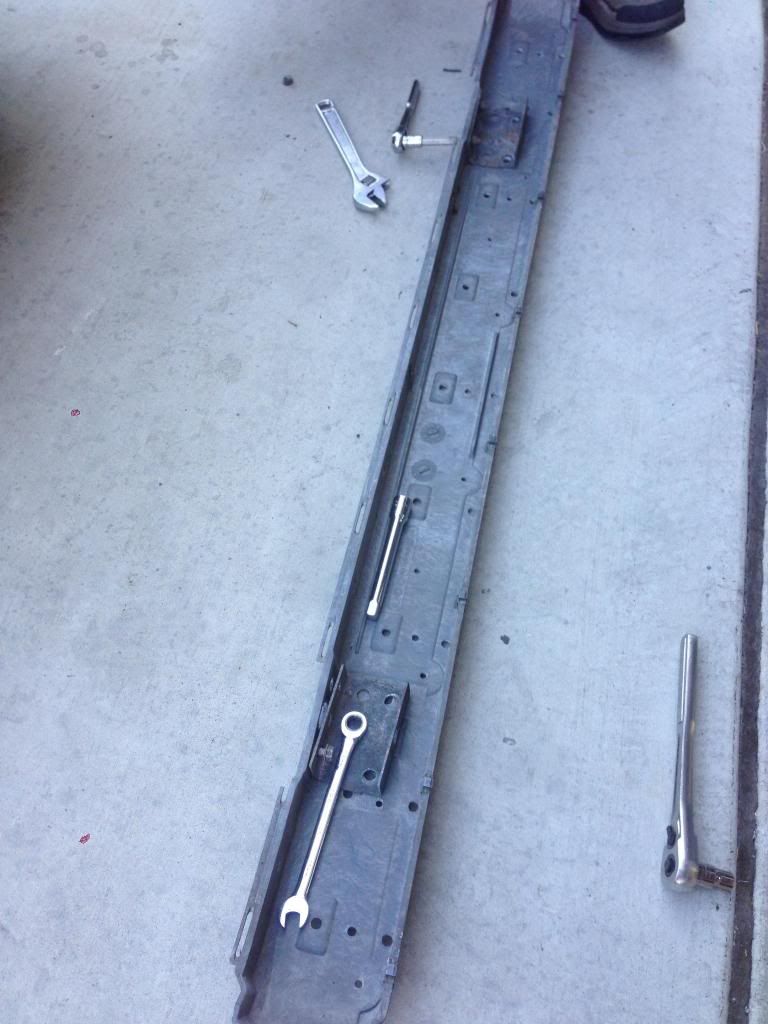

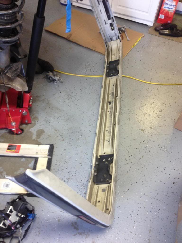

    Next was the rear bumper

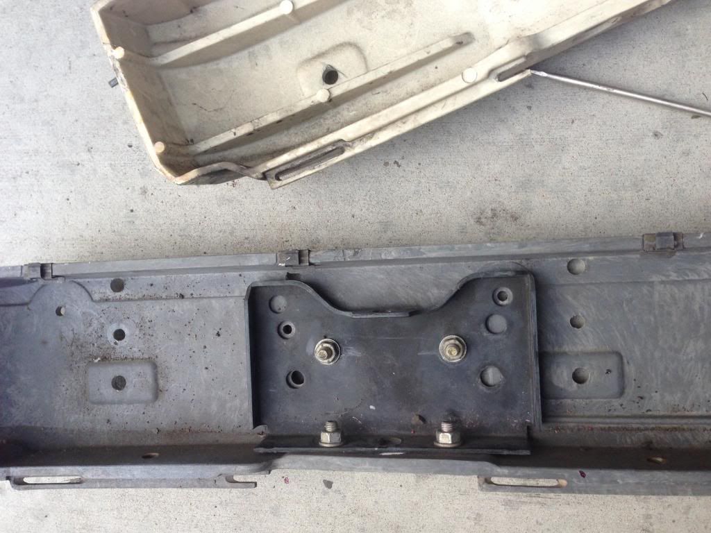

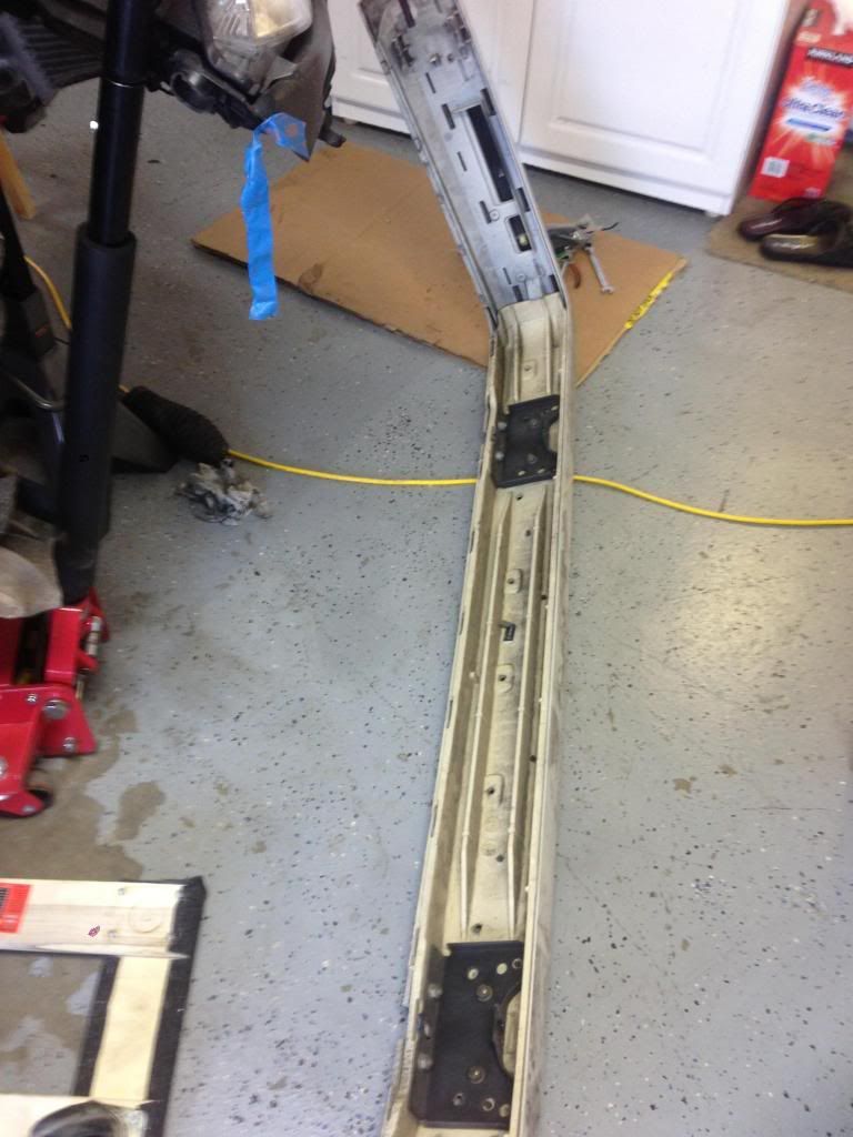

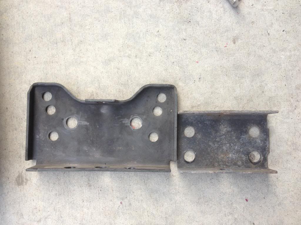

    Had to remove the bracket plate that bolts to the back and switch it from the stock bumper bracket
    Comparison Left-Stock Right-Mtech
    Stock bracket installed on mtech

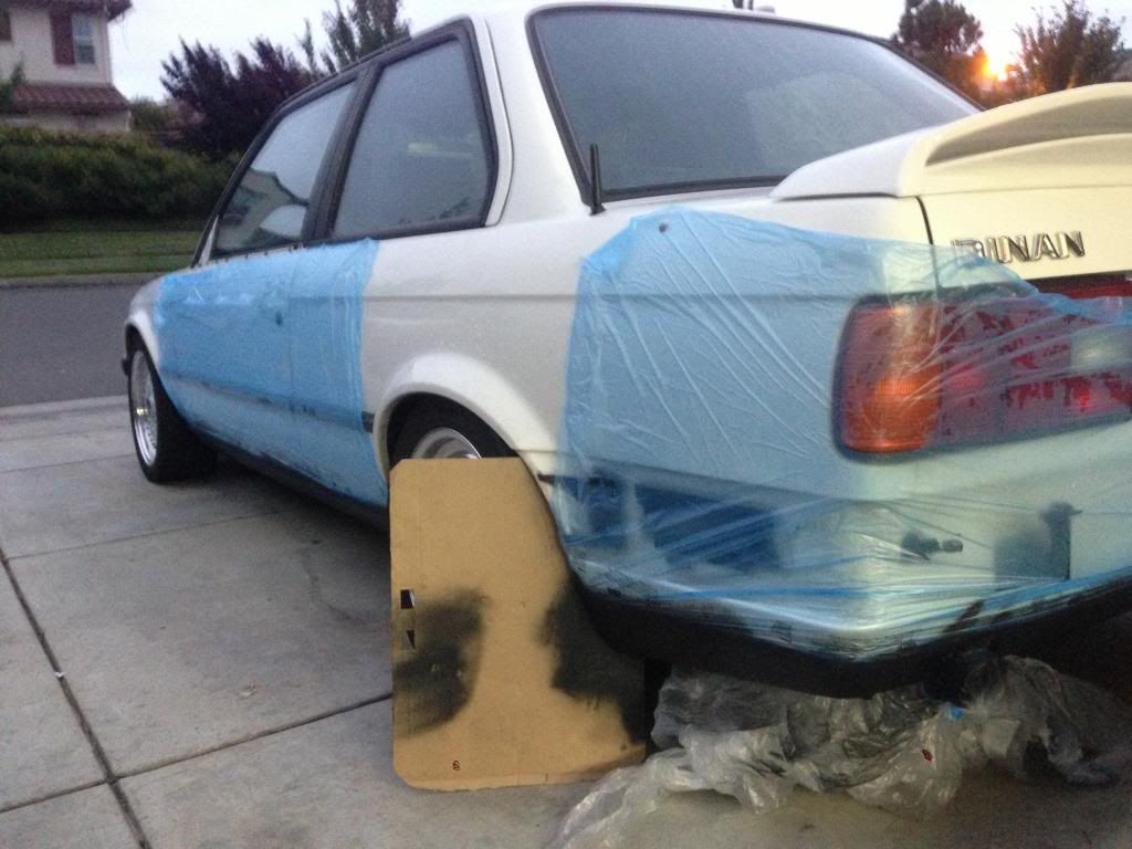

    Ready to be installed but first i wanted to paint my faded bottom trim

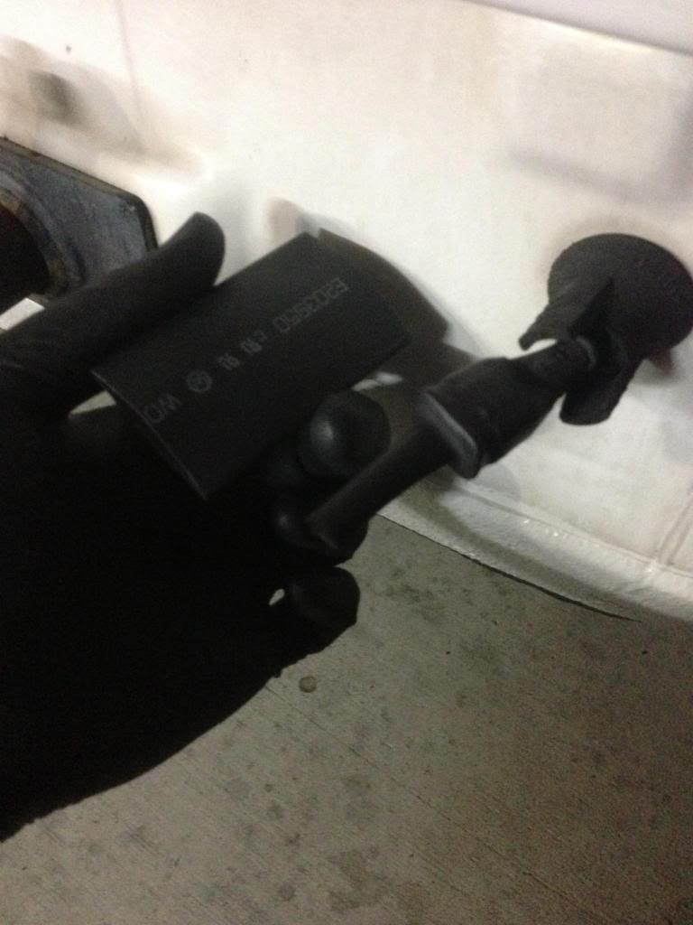

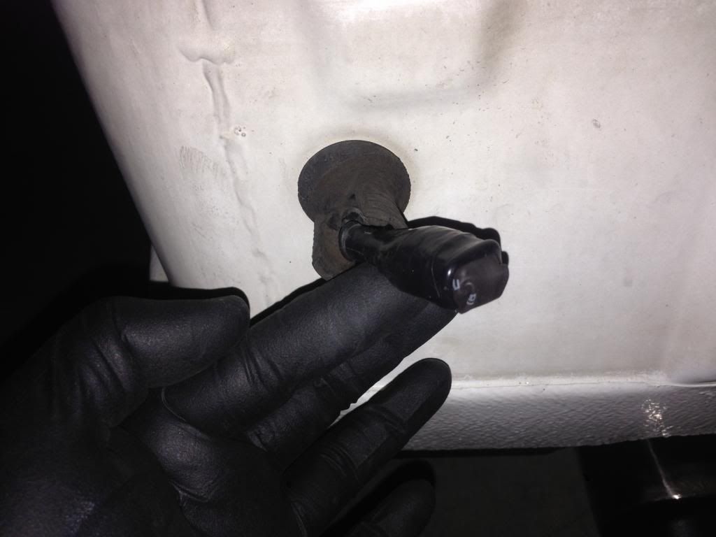

    And heat shrink the parking light connectors for protection as this kit deletes it

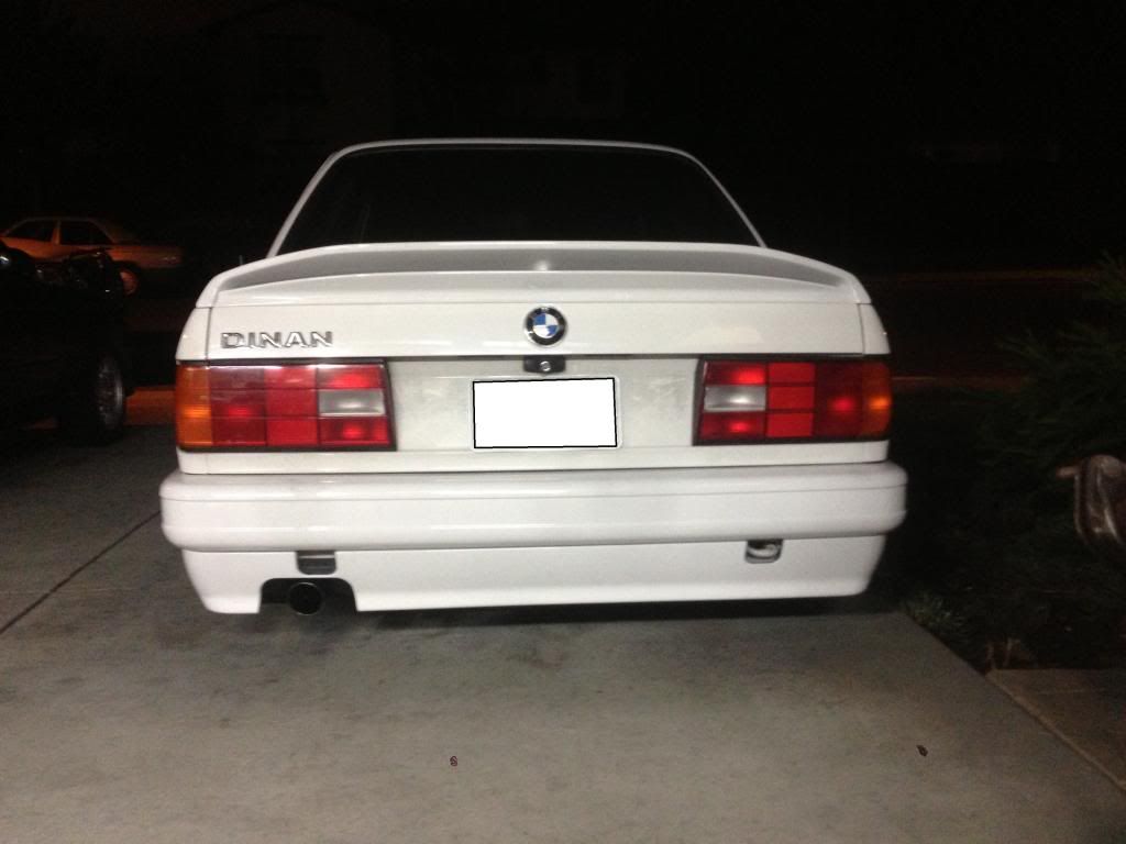

    Rear bumper installed

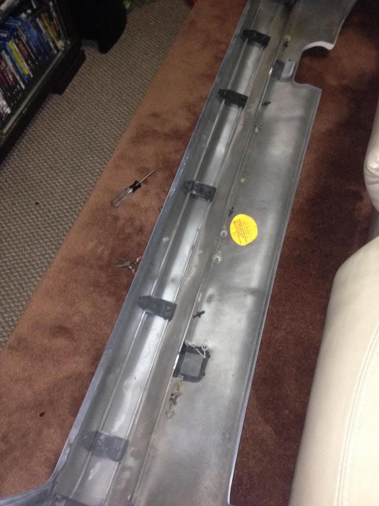

          Next is front valence and bumper
          Clips for the sides
          Rubber seals
          Drilled hols on both sides for valence clips
          Nut for the clip
          Top valence clips
          Drilled holes for the top clips
          Clips installed
          Bottom clips
          Valence finished
          Bumper installed

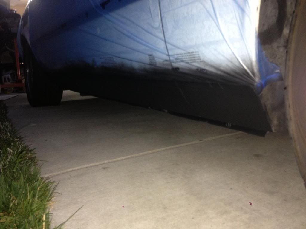

            RE: Lets do the exterior!
            Side skirts are up
            Started with clip alignment with blue painters tape and punched holes to prepare for drilling from template
            First drill on the body! cant mess this up...
            Few more
            Bigger holes now
            Rough
            Sanded down
            Clips are on
            Side skirts installed
