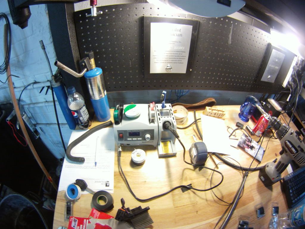

              Went and bought a nice digital soldering station, going to need it to finish up the harness. Used it the other night, and I will NEVER go back to a traditional iron.
              Excuse the mess, it's not normally that dirty on my bench.
