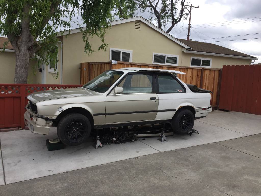

          Bye bye beast. You will be missed, but Brilliantrot has me feeling some type of way.
          So I had to grab a lot of parts from the beast, including its front subframe. So pulled the m42 and its front subframe and stock suspension to swap with the beast. Here are some pics of that
          Pressure washed the BAE
          Subframe and suspension dropped
          Dropped the steering column to put in the pedal box from the beast that was welded when it broke a little while back. I figure it is much stronger and it will prevent the same breakage from happening to the stock pedal box.
          I've done more since then, but need to take pics still. I am awaiting some important parts, too.
          Pumped to get my coilovers on, but I don't have the correct strut not from vorshlag. So hopefully I can get that sorted out.

                Just some adventures of the day
                Burned out the subframe bushings
                Painted the brake line holders brackets or whatever just to tidy things up. I also painted the custom coupler nut for my swaybar should I made from e36 m3 endlinks
                Test fit the struts with the e36 m3 swaybar tabs welded on and the end links I made. Seems like it will work great. I'll know more when it's on the ground.

                      #700
                      Forgot to post this earlier. Front subframe is back in with new redesigned Condor mounts. They are much nicer
                      Drilled the holes for the brake booster relocation and notched the firewall for the steering column.
                      Removed RTABs. This is definitely better than burning them out
                      Installed delrin brake pedal bushings and bronze clutch pedal bushings
                      Installed new front wheel hubs with new dust covers and new nuts
                      Also got wheel studs on
                      Got the proper strut nuts from vorshlag
                      Rebuilt the half shafts
                      Got new parking brake cables installed
                      Installed a differential stud kit from garagistic
                      Sent from my SM-N920V using Tapatalk
