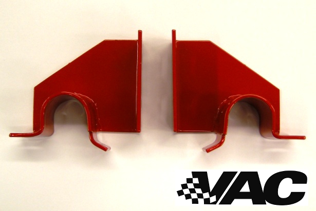

                  May I also suggest reinforcing the sway bar mounts on the front subframe. Along with adding a bar between the trailing arms to make an "a" frame.

                      AKG sells the sway bar kit to reinforce it. I'm pretty sure its peanuts. I'm also sure you could make your own since its not to hard.
                      As for the trailing arms. Just add a bar in between. I believe the MZ3 come that way from factory? I could be wrong.

                        I just looked at the AKG website for the sway bar reinforce and I'm probably going to make the plates. Very easily.
                        As for the trailing arms, I believe you're right that Z3M came with the bar.
                        I'm going to tackle making mine the same way.
                        Powder coating can be here locally. Shipping to the US will be mad expensive, especially with the weight and length. I'll have them painted. No biggy.

                              Bar is a bit much but be careful it doesn't foul the filler neck or anything else around them!
                              Front subframe you can easily make up reinforcement plates for the engine mounts and swaybars. http://www.turnermotorsport.com/p-40...ement-kit.aspx
                              I also did these while I was at it
                              All easily done and free if you have some steel and a welder.

                                I already have the rear sway bar reinforcement tabs because I bought the car with ST bars on it and the tabs come with the kit.
                                As for the front, AKG sells them for 10$ but somehow they want 35$ to ship to Canada. They could simply send them in a basic envolope for less than 2$ but ill make my own.
