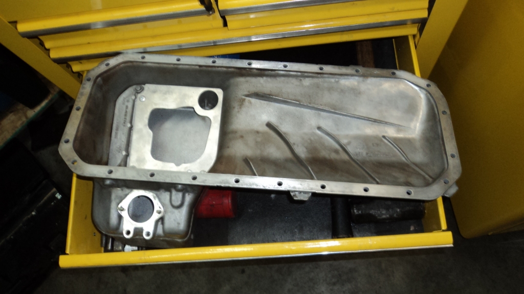

    Oil pan:
    w/ new racing baffle

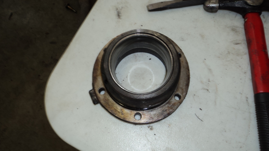

    Differential Servicing:
    pressure washed the unit, removed and cleaned the face
    cleaned out the old fluid with brake clean
    cleaned the seal surface
    seal installed
    Bushing in and changing the side seals
    diff installed!

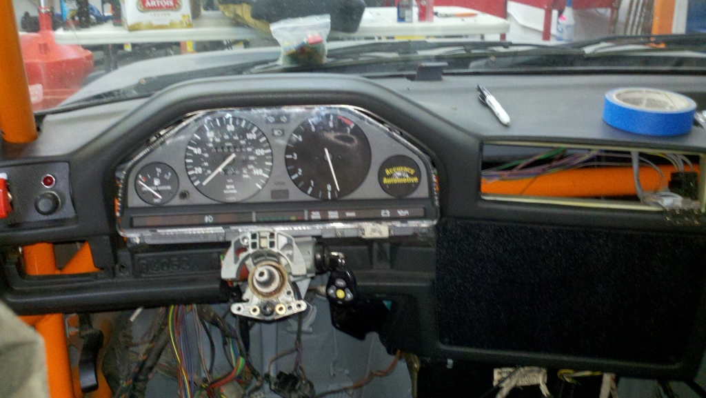

                                Interior gauges, and instruments
                                Ignition Switch:
                                Main Control Panel:

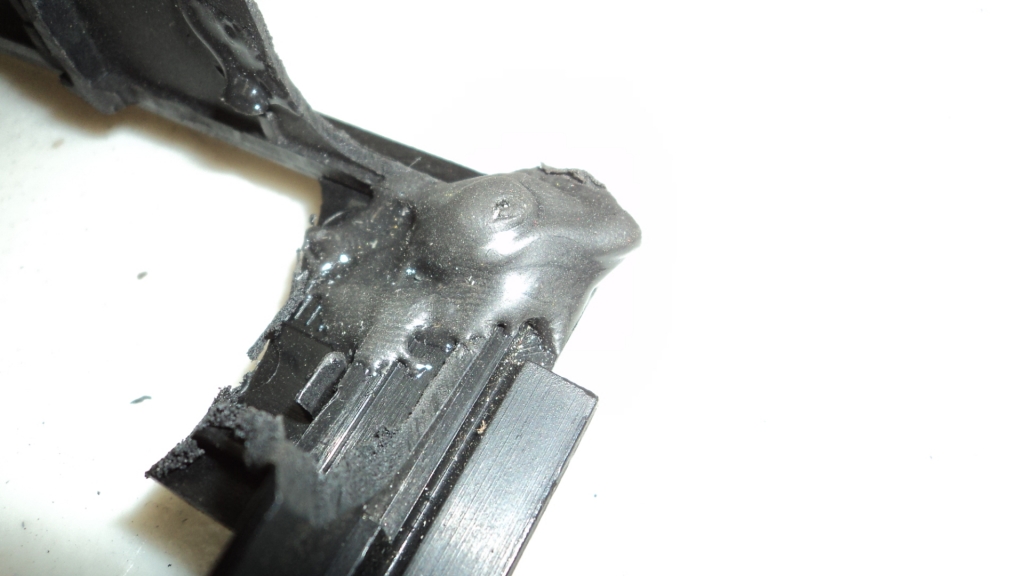

                                Using the stock panel as the mount for the dashboard.
                                drilled four holes in the corners, then globed some quickweld and taped in some screws.

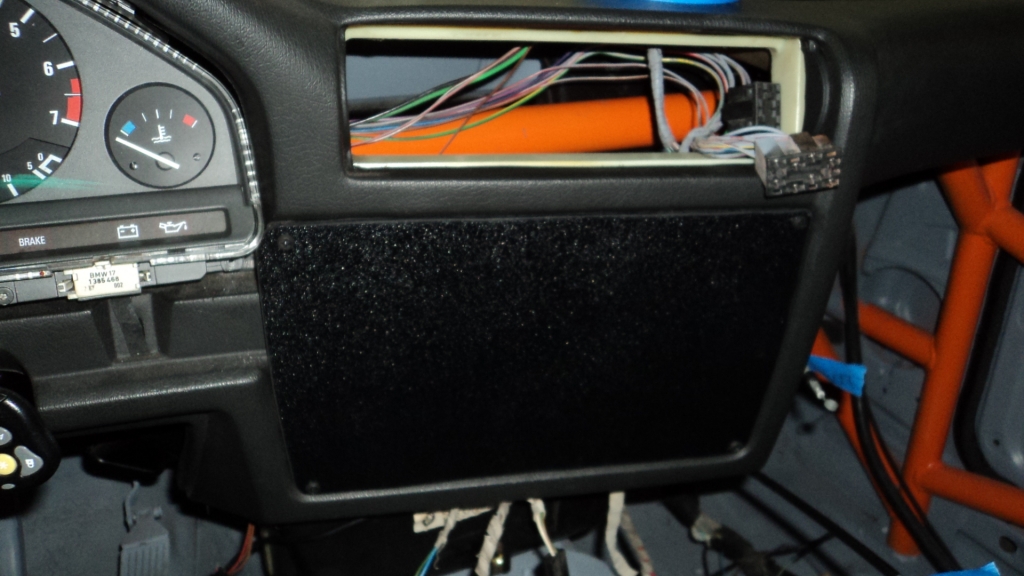

                                Gauge pod
                                Trimmed and glued ABS plastic inside the original center vent. Drilled 2 1/16 hole for volt, this will run all four gauges.
