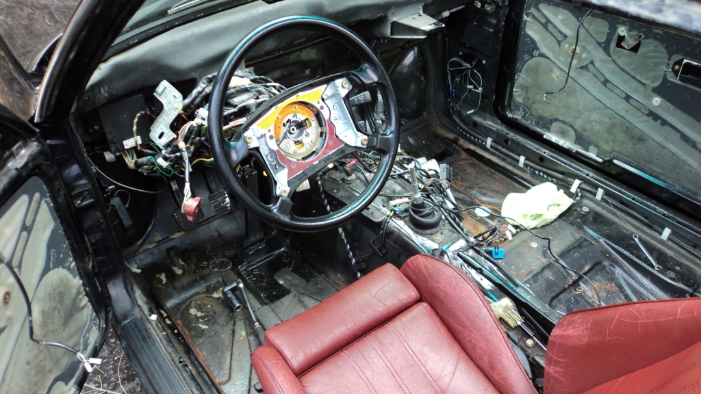

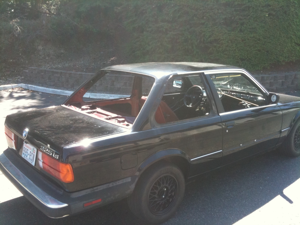

    The Interior looks decent it pictures but it all was trashed and thrown away with the exception of the drivers seat.
    Disassembled:
    Nice and stripped, ready for a cage but first...

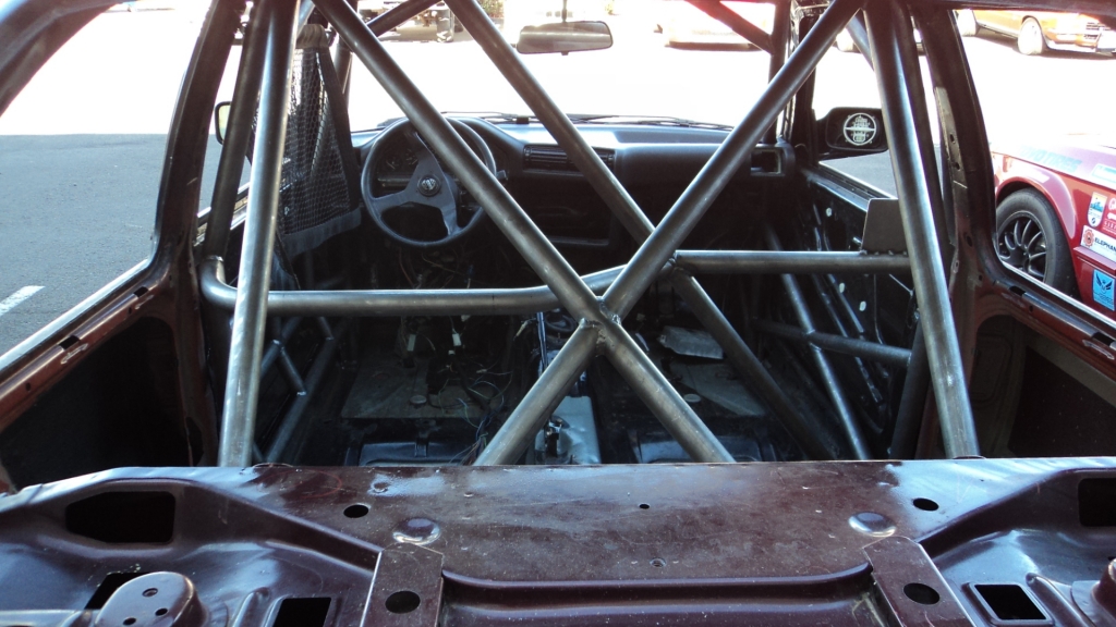

    Cage building progress:
    1987 PRO-3 car /1990 325is (2.7i Concours)
    • Jparkr
      HR Admin
      • Jan 2006
      • 3494

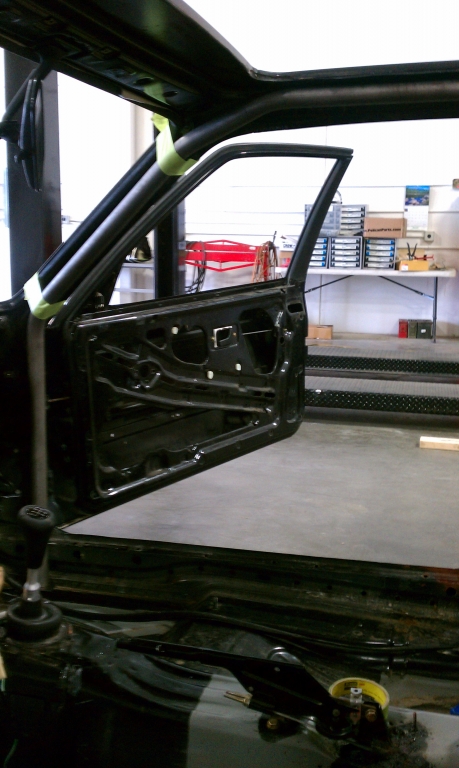

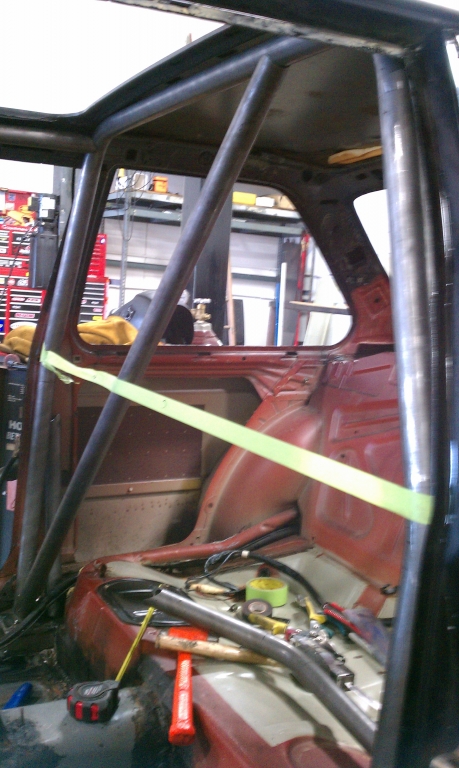

      Cage complete
      ^ My car's head mechanic Reid

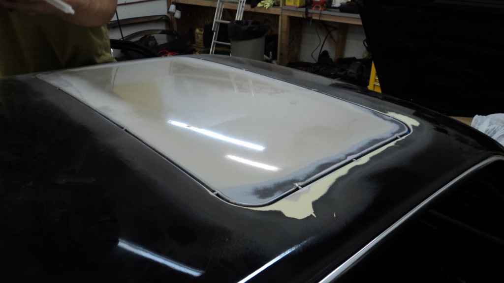

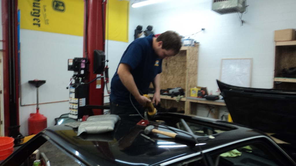

      Sunroof delete
      Suspended the panel in place, then marked where we would drill the holes for the supports
      Drilled holes in the panel
      Nate drilling holes in the chassis
      Me prepping the metal for the 8115 panel bonding we will use as the final act of securing the panel in place.
      Nice and flush
      Here is how we suspended the panel. We used these bolts to weld on.
      Tacking the panel and chassis to the bolts
      Tacked in place

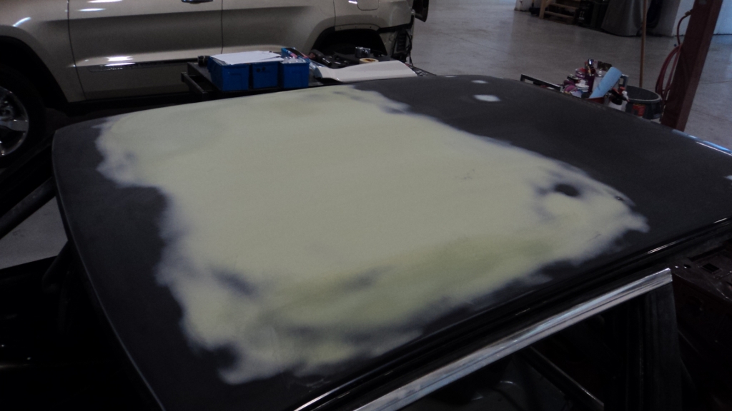

      Scuffed
      This is the panel bonding, 8115. If you know it, you know its serious business and basically liquid weld

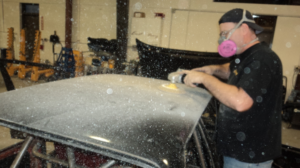

      Smoothed out
      Chris sanding it all smooth
      No more sunroof!

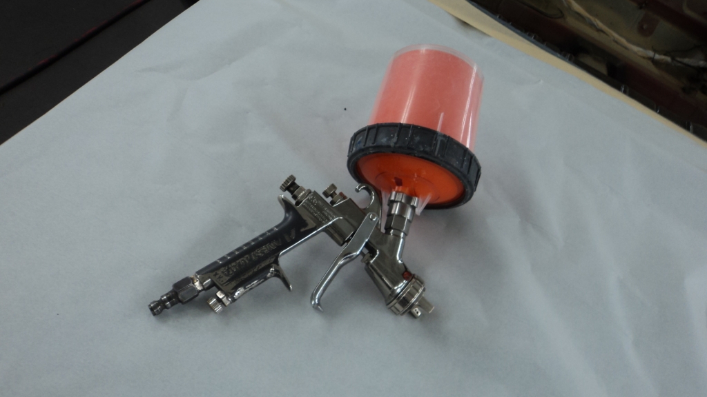

        Paint

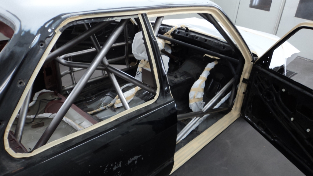

        Roof scuffed and primed
        Disassembled
        Before shots
        scuffed
        Primed
        Oh, its go time!

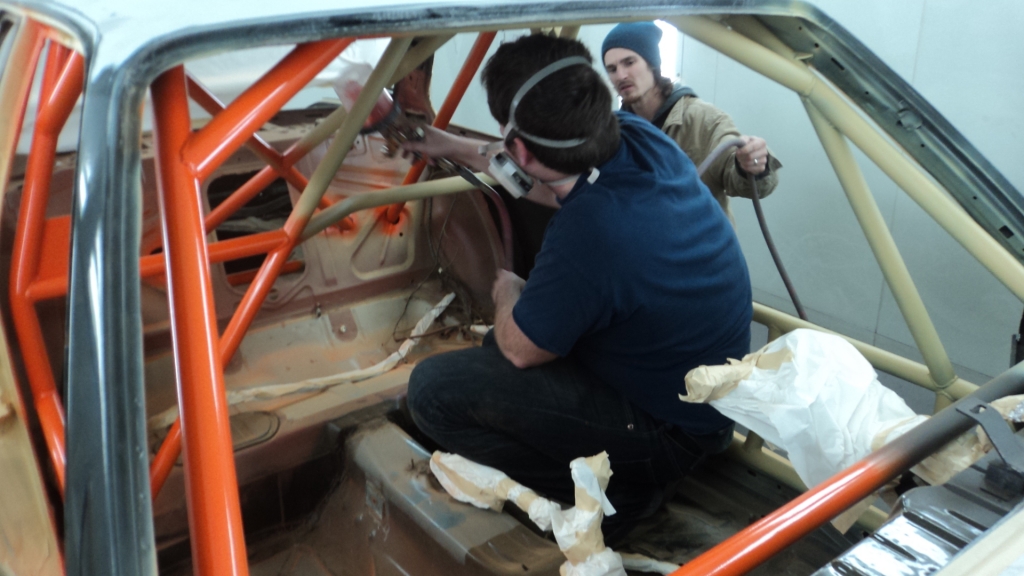

        Me painting the cage
        Nate and I doing work

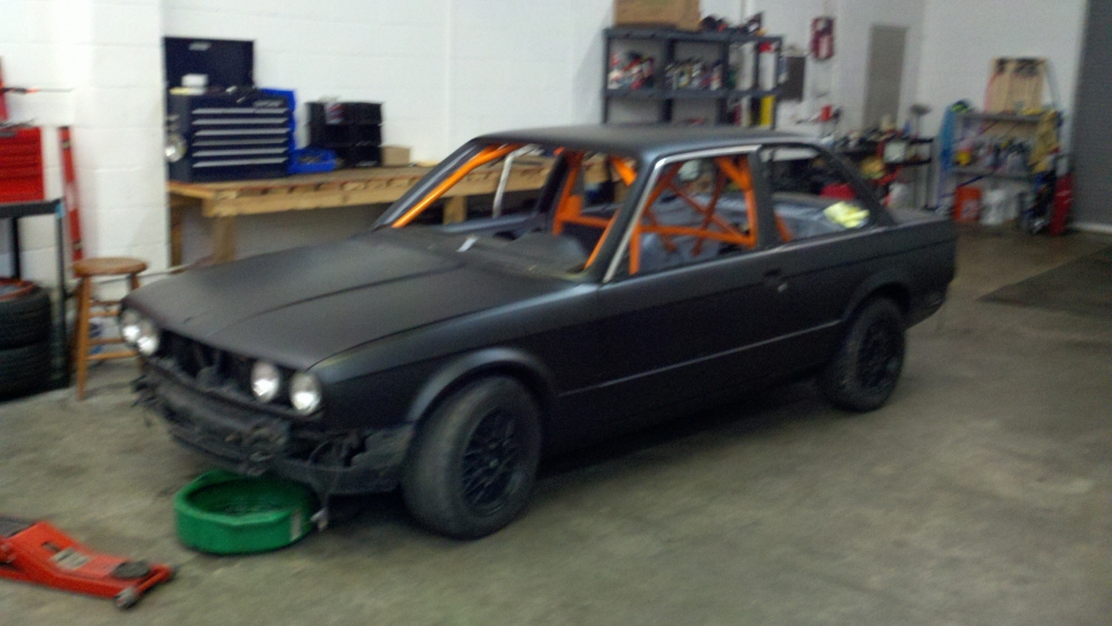

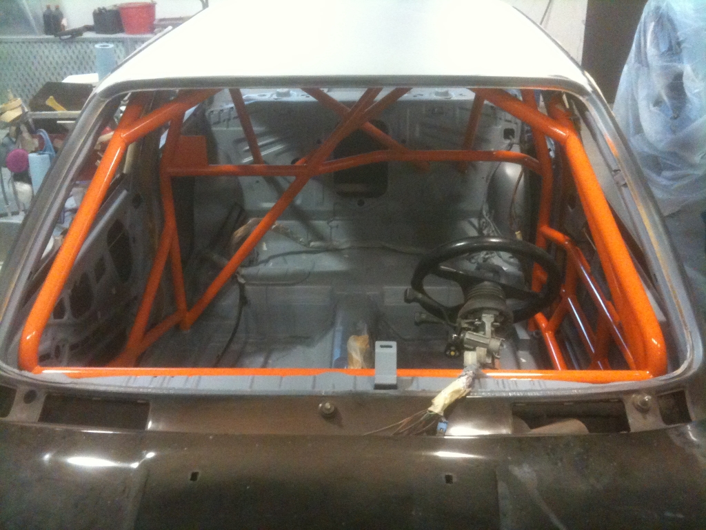

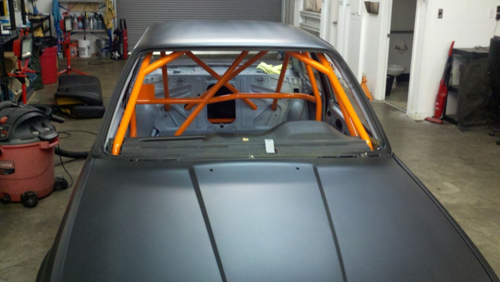

        Cage is painted a orange for the look of Fire. This is the BBBQ2U car after all.

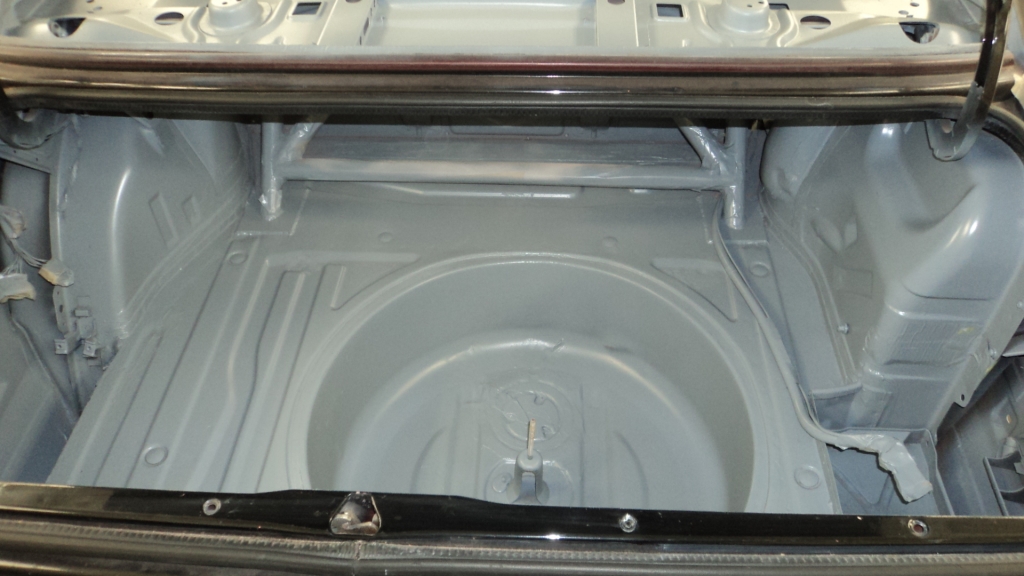

        Interior painted grey
        De-masking
        Quick done shot of the interior

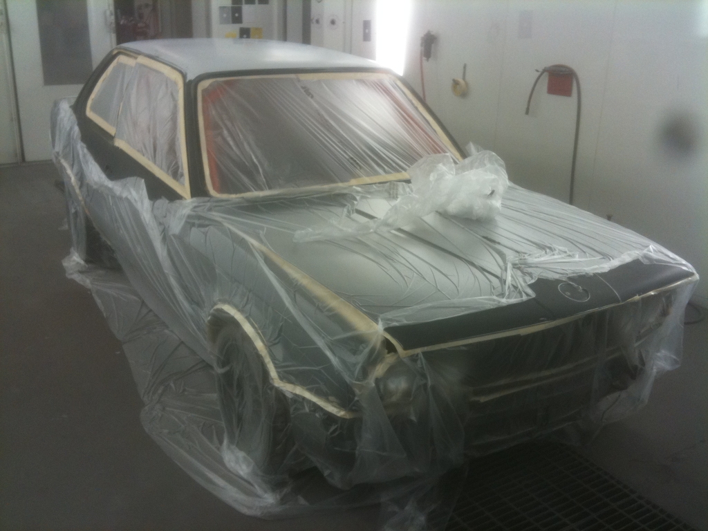

        scuffed and masked

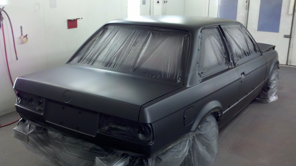

        BBQ pit black!
        This is also done in satin so panels can easily be replaced, if any on track incidents occur.
