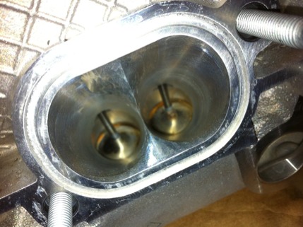

                    Did BMW keep the baby six head bolt pattern?
                    john@m20guru.com
                    Links:
                    • nando
                      • 34844
                      #385
                      Dunno. I could tell if i pull the valve cover?
                      edit: does it look the same? I have an S52 block I could compare it to.

                        #386
                        think you could improve on this?
                        this is the S54 for comparison.. S54 valves are 1mm larger.
                        Build thread
