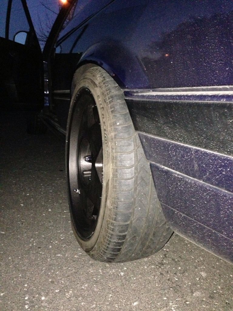

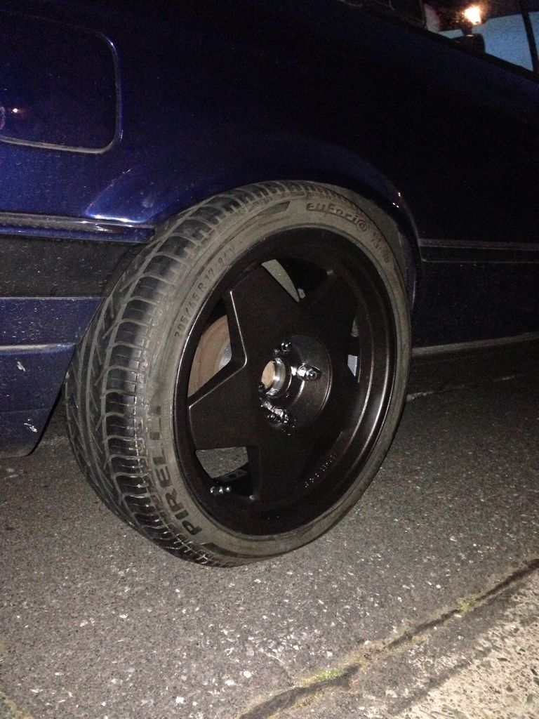

      Screw it, I'll re-torque them tomorrow. The lugs cleaned out the holes where they go, but I didn't wanna deal with stripping the whole backs. I got the wheels on today. Had to raise my coils up in the front to accomadate the lower offset, but it still rubs well before full lock. I'll get them re-pulled next weekend. Hopefully I can work the rear enough to go 1/2-3/4" lower back there too. Maybe up my damping and fuck with the inner fenders as much as possible.

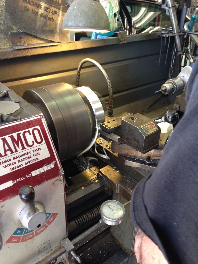

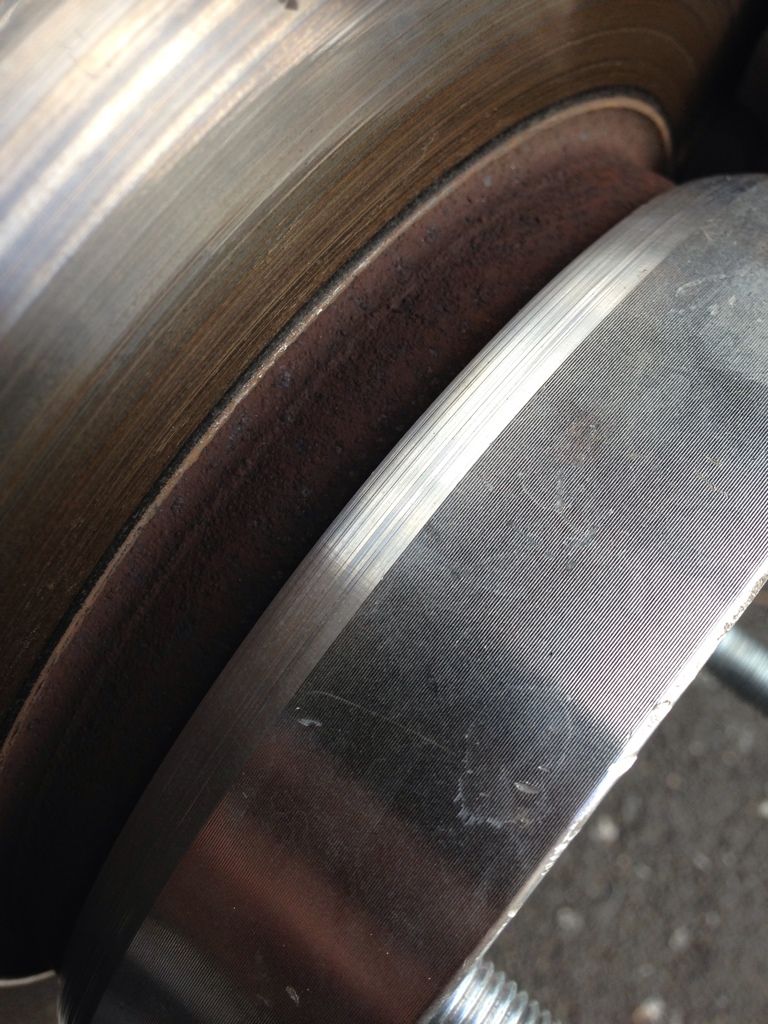

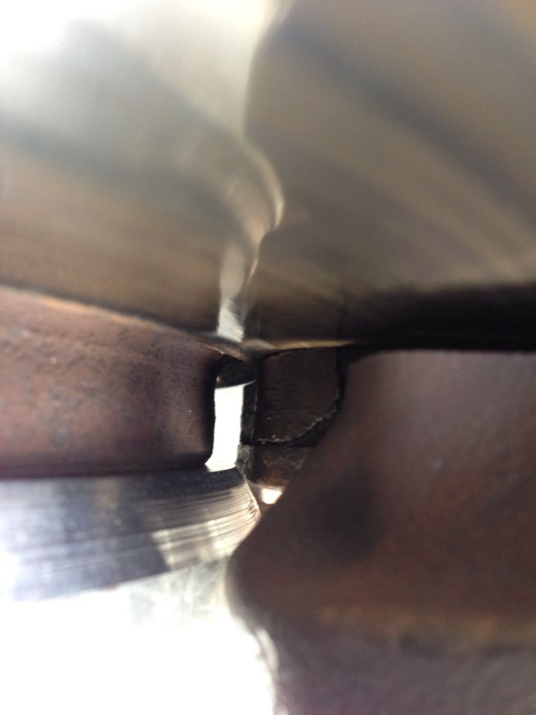

      The front adapters hit the brake pads, so I had them machined down. They clear by <1mm now.
      Clearance...and my cracked brake pad from when I found out it didn't fit :/
      Shitty pics because it was dark:
      Flash makes the tires look brown and gross and the car dirtier than it is

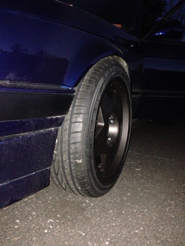

      And one decent pic of the rear from when I test-fitted them yesterday:
