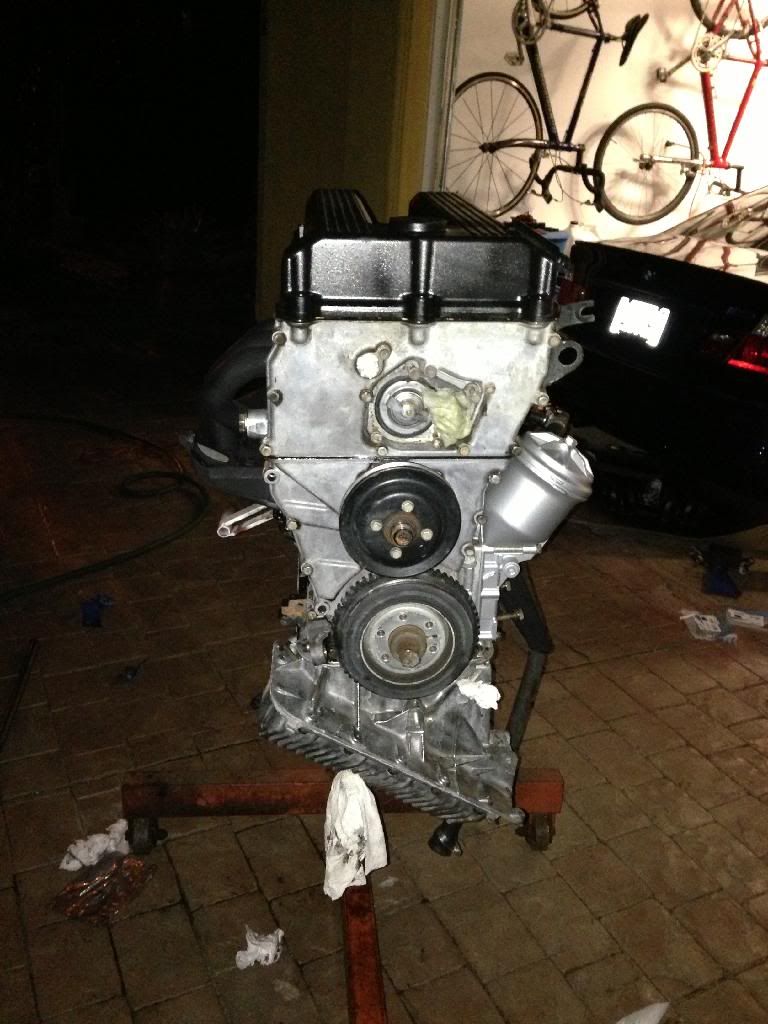

    I pulled off the unnecessary AC and PS pulleys. Is it okay to run it like this with no bolts, or are those 6 bolts also holding the harmonic balancer on?

      Originally posted by LJ851
      lol !
      I take it those bolts are necessary…hopefully there won't be any interference without the front acc pulleys there. It wasn't too thick.
      Anyways, today i got my painted motor mounts, headers, and oil filter housing on. I pulled the harness off my old engine to swap over and labeled everything. I put a new timing chain tensioner on the new engine and a new cooling pipe, and installed all the passenger side cooling/heater core hoses (simplified to eliminate the mess under the intake). Only one pic for today and unfortunately I'll be in texas the next two days so I won't get anything done.

                      make sure the bolts for the crankshaft don't bind against the timing cover seal, since you removed the pulleys
                        I was thinking about that. The pulleys weren't thick but I think I should maybe stick some washers under those bolts. How do I check if they're binding? The car already ran for a few seconds so hopefully I didn't already mess anything up.

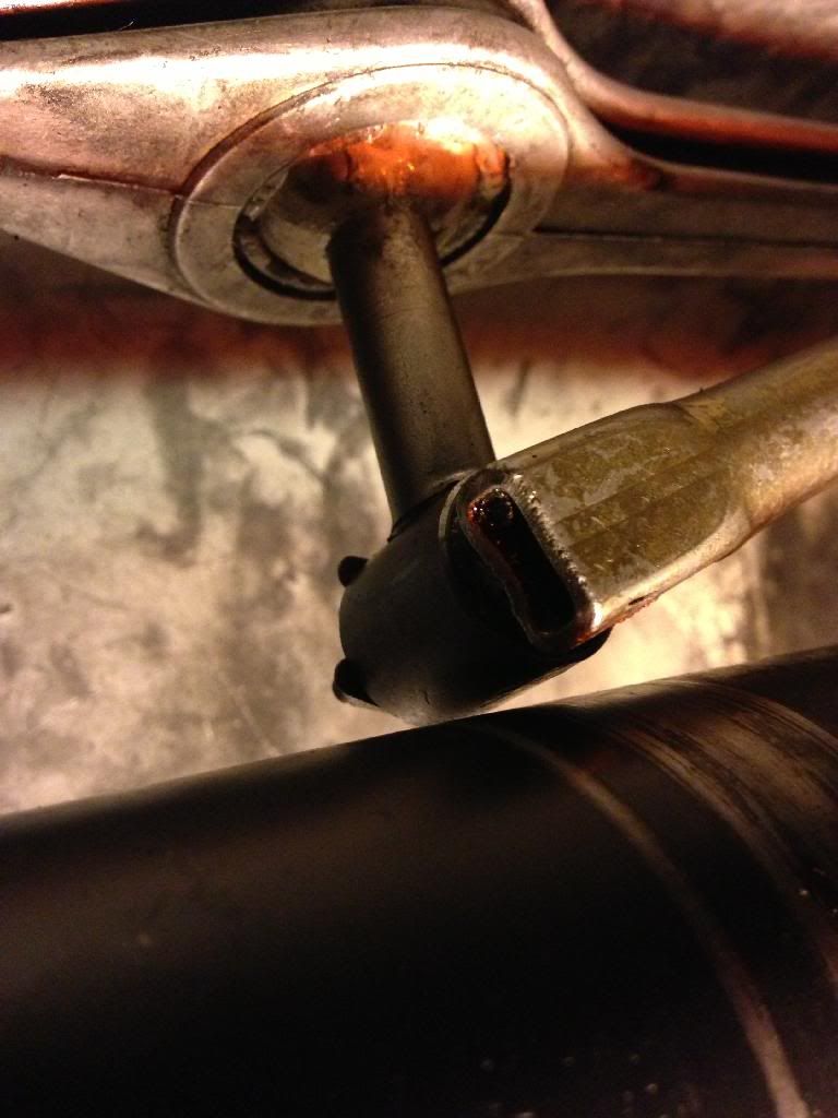

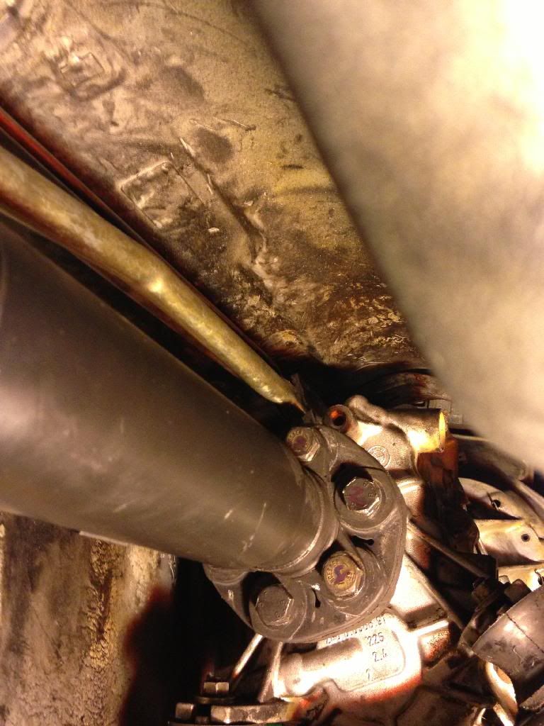

                          CSB, guibo, driveshaft, main heat shield are in. Goal is to be drivable tomorrow. Needs mostly slave cylinder (and bleed everything), exhaust, and I need to turn around one of my motor mounts because I put it on wrong.
                          Also bent my selector rod to shorten it to make the shifter sit more in the center and less forward
                          Because I think I'm running the shortest possible shifter without raising the carrier
                          (and it feels amazing).

                              Was your shifter rubbing before or after bending the selector rod?
                              Either way
                              GG
                              Nothing like the feeling of driving a recently-deceased but resurrected e30
