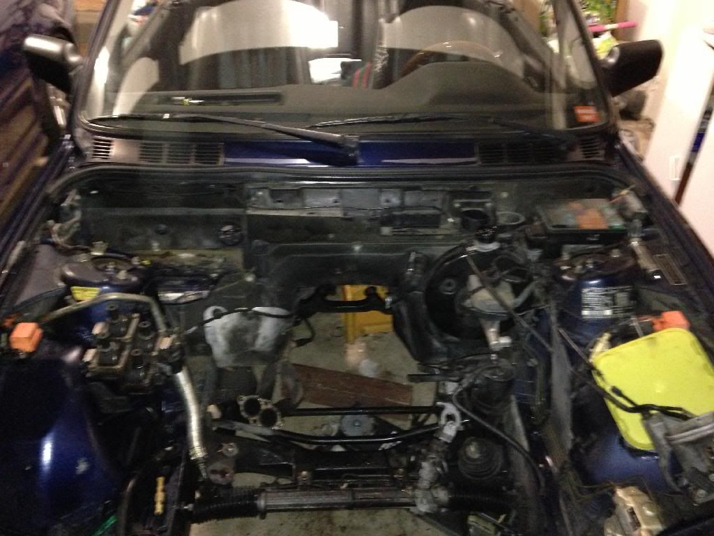

        New engine acquired. Gotta do some maintenance on it, replace my front subframe and steering rack, install a skid plate, then I can drop it in.

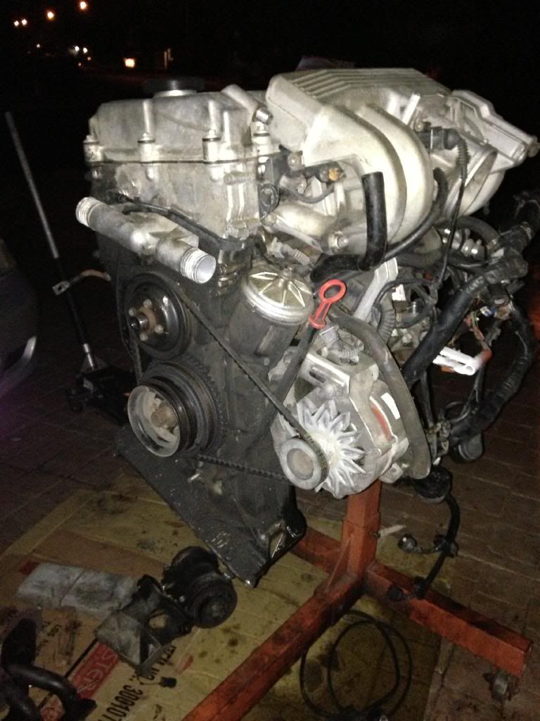

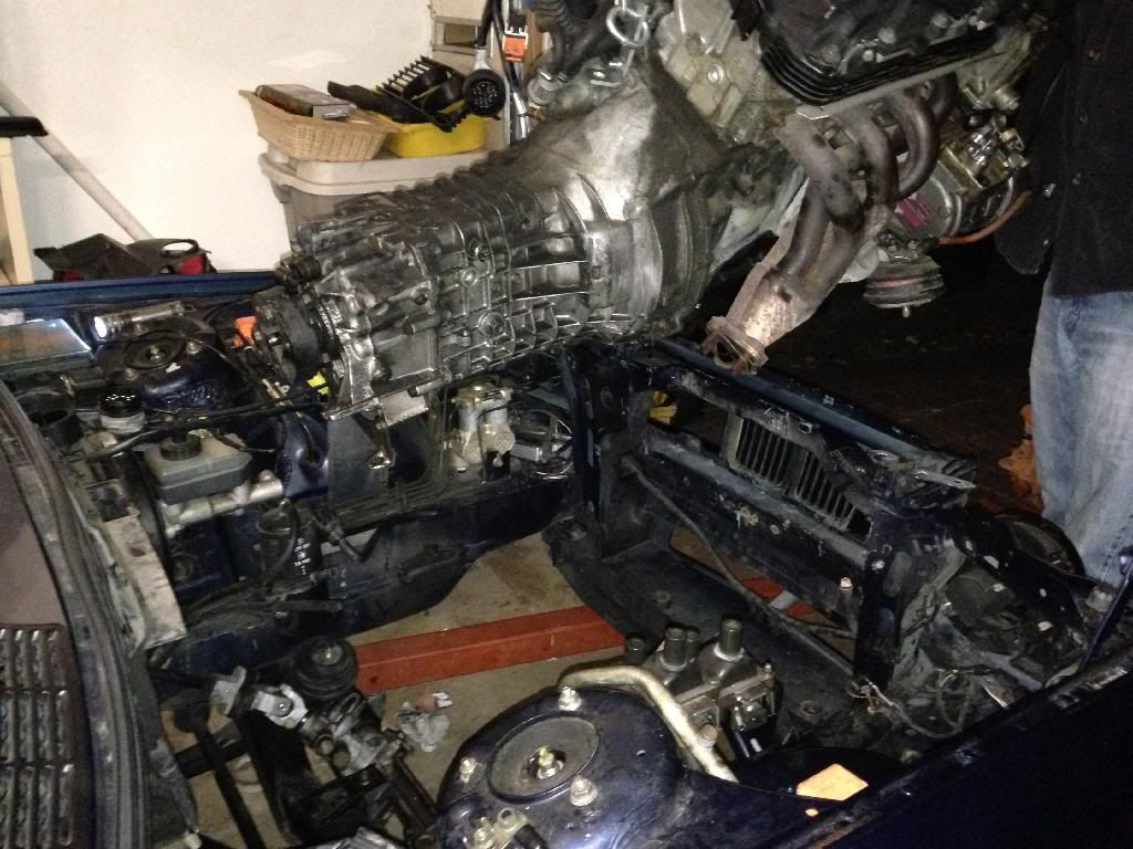

              #516
              Went from this
              To this
              in a couple evenings. The plan is to repaint basically everything in black and silver. Valve cover and intake in wrinkle black with sanded ridges, silver oil filter housing and thermostat housing, black block, headers, and motor mount arms, clean up the alternator, clean the pan with either sand paper or a fine wire wheel and then clear coat it, and I'll see what I can do about making the timing case as nice as possible since I won't be removing it. I'm replacing basically all gaskets except the head and profile.
              Does anyone know: if I undo the 6 bolts around the crank pullies, can i get off the AC and PS pullies because I'm deleting those two. It seems like the crank bolt would stop them from coming off, but I'm not sure.

                #517
                stop using a potato for your pictures.

                  #518
                  Both were taken when it was absolutely pitch dark...also got the center out for my wheel that was stuck

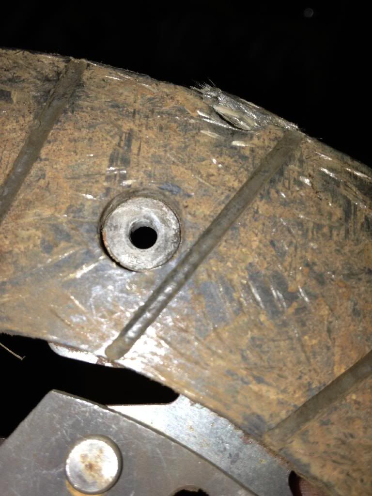

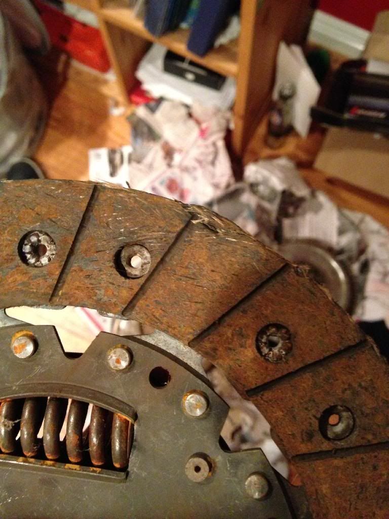

                        Got a bunch of parts cleaned up to paint today, but it got dark/cold too early to paint em. Tomorrow I should have the headers, motor mounts, thermostat housing, and oil filter housing painted. I'll do the VC and intake when I find a place to bake it for the wrinkle coat. Also received my m20 flywheel/clutch/PP.
                        Awesome GF helping out:
                        Flywheel and pressure plate look good. Clutch is thick as described, but has a couple little nicks on the edge. Will these pose a problem?

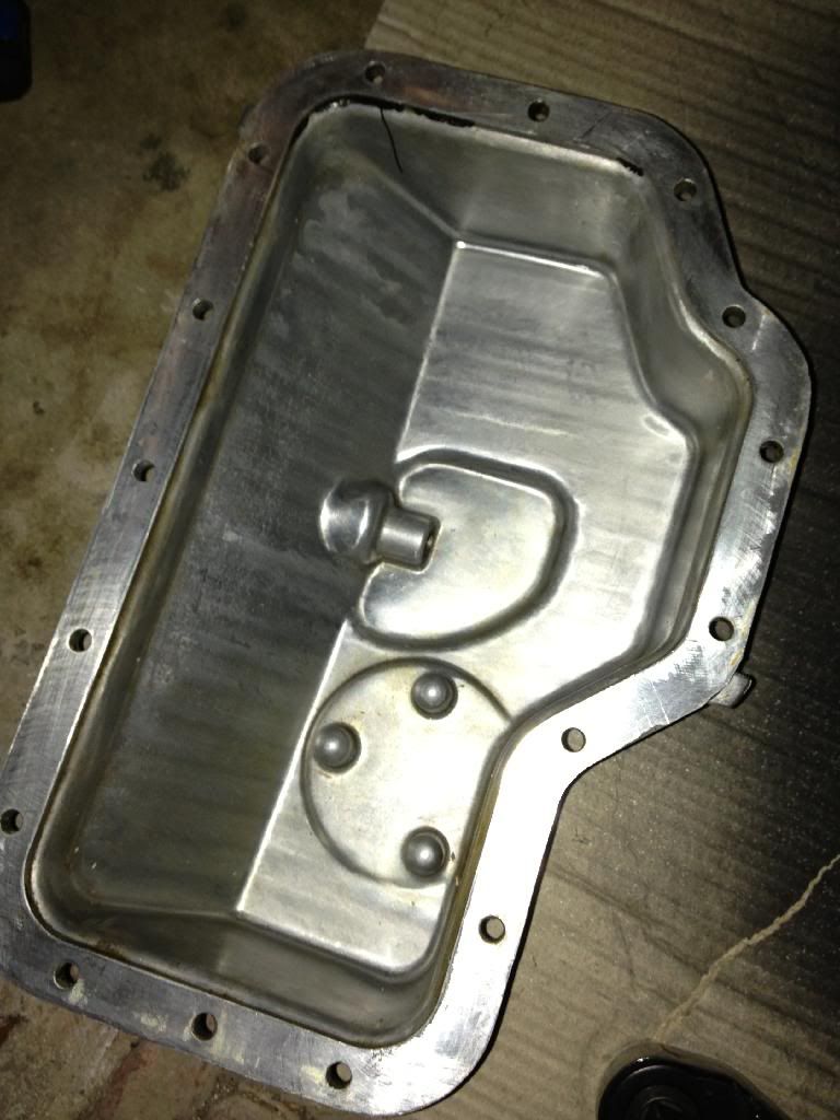

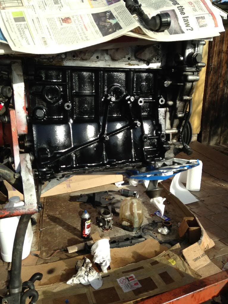

                          #522

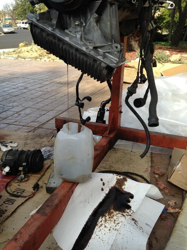

                          Over the past couple days I pulled and cleaned the oil pans, installed with new gaskets and a bit of hondabond.
                          Steven said he drained this engine...fuckin liar.
                          Painted the block
                          Clean pan
                          I pulled off the unnecessary AC and PS pulleys. Is it okay to run it like this with no bolts, or are those 6 bolts also holding the harmonic balancer on?

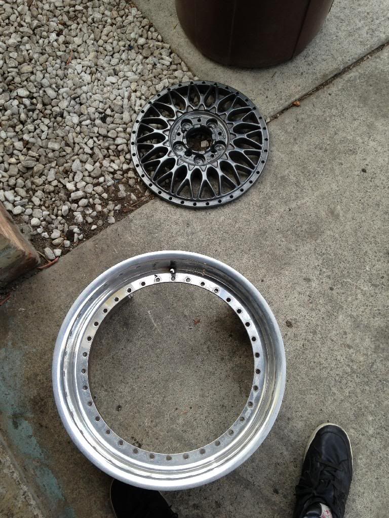

                          I've also been working on my style 5's. All are split currently to be polished. Ones done and needs to be put back together. Another is almost fully polished, and the other two are still just sanded waiting to be polished. I also got my valve cover and intake painted in wrinkle black, still waiting to put another couple coats on those since I've been getting home too late the past few days.

                          • Cabriolet
                            • 9620
                            #523
                            never fully drains.

                            • AbsorbantNut
                              Non faccio funzionare questa merda
                              • Jun 2010
                              • 2491
                              #524
                              If it's anything like an m20 those six bolts attach it to the crankshaft. The only other thing holding it on is a locating pin. Style 5's eh:D
