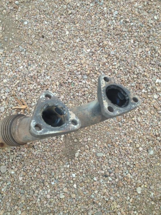

          Fixed the exhaust for the second time, runs so much smoother with the flange actually attached to something

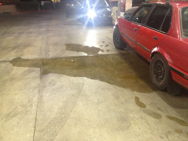

            Had a slight fuel issue

                  Bet that guy in the lexus really appreciated that
                    He was like having a panic attack,
                    I waited til it stopped dripping then drove it home

                      Still haven't dropped the tank to find out where the leak is, filler neck is fine, filter area is fine, removed both covers under the rear seat and that was dry also

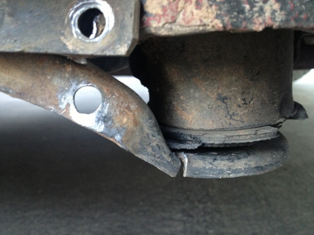

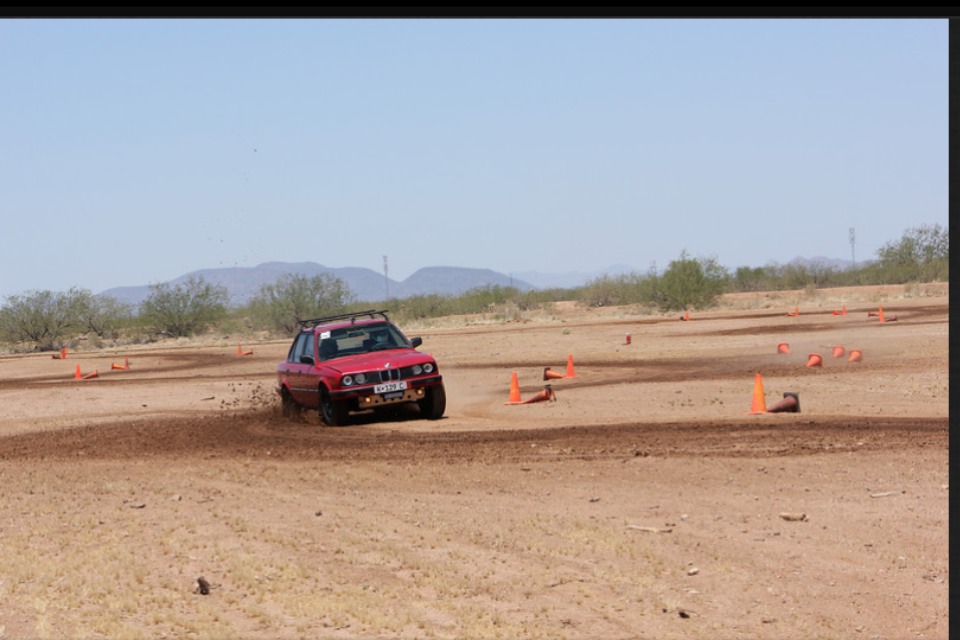

                        Az Rally cross this weekend, got first place. Car ran well. Subframe mount started to fall off and got a pretty good crack. Time to do the subframe bushings.

                          Nice finish! I'd love to have a shot at a dry and flat course.
                          Patrick Henry
                          • AZRRC
                            • Sep 2012
                            • 260
                            #148
                            It is definitely very dry here and the water doesn't last long. I'm hoping our next event in July will have some rain

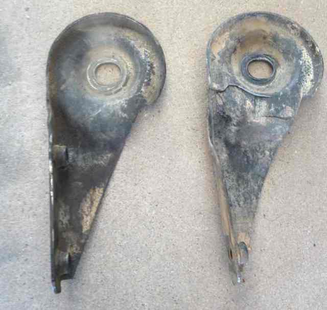

                                Fixed the car, $4 at ecology for the mount, and I recharged my ac yesterday to get ready for Fridays 118 degree high
