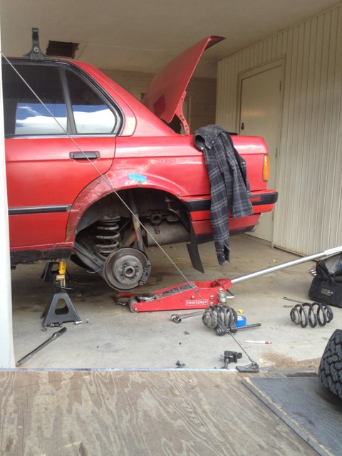

        Switched the rear springs to e36 vert springs, also added another pad. The rear sits about an inch higher now.

          #109
          How about the rear shocks, just any stock or replacment shock will work ?
          pics with the tires onn ?
          • AZRRC
            • Sep 2012
            • 260
            #110
            Right now the rear shocks are stock. They are way too short and stop the tire like 4 inches before full droop. However I wont put longer shocks in until I make some limit straps so it won't ruin the cvs. I may make some spacers to lower the upper mount a bit. It feels like on some bumps it droops til the shocks stop it an it pulls the tires off the ground

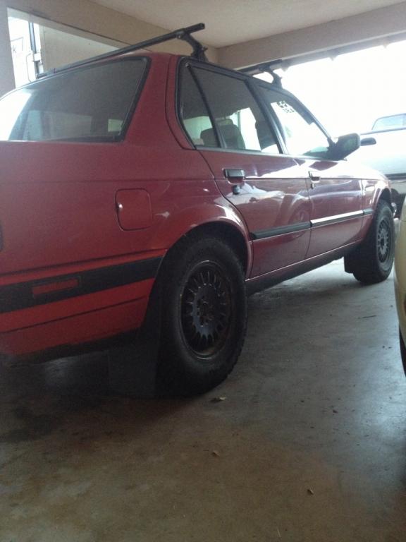

              #111
              At the highest point on the arch it's 26.5 inches , that's with tools, sub, spare, full interior, half tank of gas

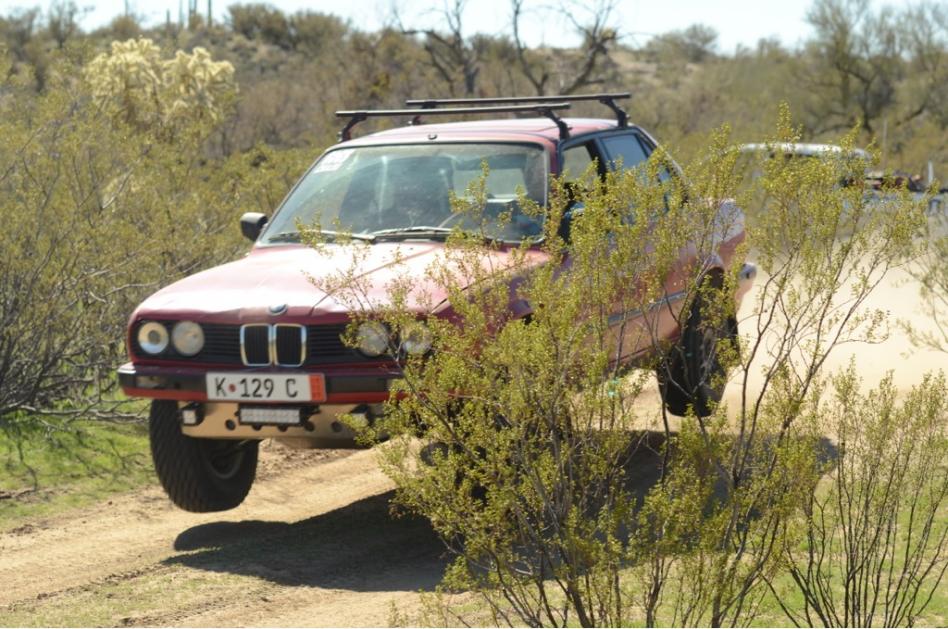

                #112
                Quick pic from today, I will post better ones later

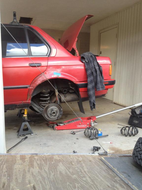

                      [ATTACH]66087[/ATTACH]
                      [ATTACH]66088[/ATTACH]
                      [ATTACH]66089[/ATTACH]
                      [ATTACH]66090[/ATTACH]

                        #116
                        Looks like soo much fun.. lots of win in these pics..
                        I put my 2 door alpine on jack stands today getting ready for the vert and e36 springs. Would you say go with the convertible or coupe spring ?
                        I got a huge piece of aliminum too , trying to make a one piece skid plate from front to rear.
                        thanks so much for this thread.. I cant wait to do some remote camping in the durty.
                        • AZRRC
                          • Sep 2012
                          • 260
                          #117
                          Depends on how much weight you will carry, my car is always loaded heavy so I used the stiffer vert spring. If your car is stripped and light weight then coupes should be fine.

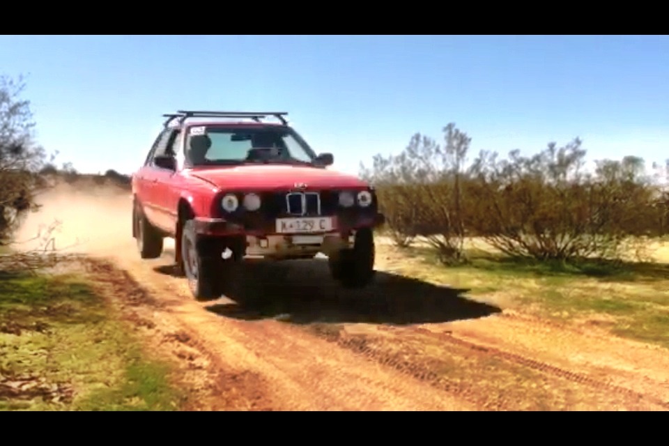

                              #119
                              Going to go to Tucson rally cross tomorrow, ill bring the go pro and take some video. Should be a good time
